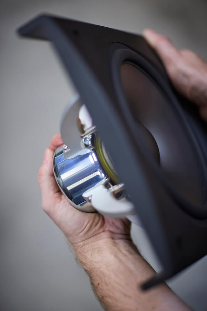

Diamond-Coated Drivers — Because Regular Membranes Are For Amateurs
Raidho doesn’t mess around. Both subs sport their Ceramix membranes coated with a 10-micron artificial diamond layer. This isn’t just sparkle — it’s about cranking up stiffness and killing resonance dead, so you get bass that’s clean, tight, and free of distortion, even when you push them hard or cross over high. No sloppy bass here, just precision-engineered Danish muscle.
Underhung Voice-Coil Motor & No-Nonsense Cabinet Design
Raidho sticks to its underhung motor setup to keep bass linear and transients sharp — no gimmicky DSP tricks pushing drivers into freak-out mode here. Instead, they house these beasts in perfectly sized cabinets, letting the drivers move naturally. The result? Bass that’s tighter, cleaner, and more commanding than most wannabe subs out there.
Passive Radiators That Actually Do Their Job
Forget port noise and that annoying chuffing you get from typical bass reflex designs. Raidho’s precision-tuned passive radiators work alongside the drivers to stretch low-frequency response without adding turbulence. This dynamic duo keeps efficiency high, group delay smooth, and bass extension deep — all while holding on to that signature speed and control Raidho’s known for. No fluff, just raw Danish engineering muscle.
