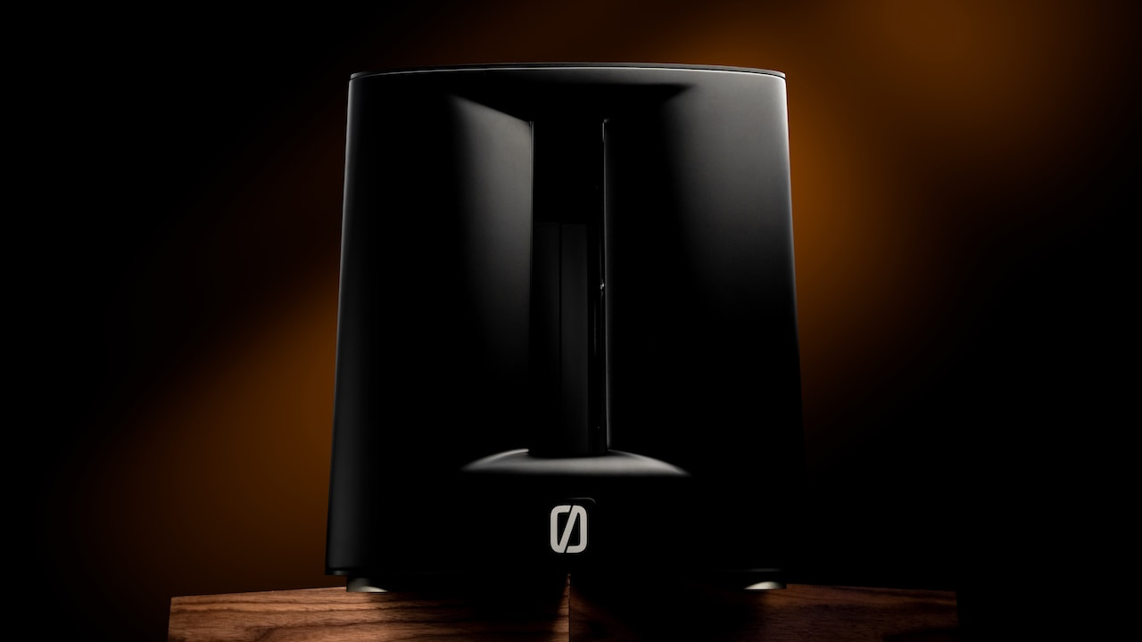

Audio Group Denmark and Børresen are back at High End Vienna 2026 with the new Børresen BM2 Bass Module, a smaller and less expensive follow-up to the $21,000 BM3 Bass Module introduced earlier this year. At $10,000, the BM2 brings the company’s folded-dipole bass concept into a more compact and lighter enclosure, while still targeting listeners already invested in the Audio Group Denmark ecosystem.
We have heard the larger BM3 at previous events, and within a full Børresen/Aavik/Ansuz system, it was rather effective at adding scale, speed, and low-frequency weight without turning the presentation into a blunt-force trauma exercise. Was it SVS or top-tier REL quality in terms of pure subwoofer value or broader system flexibility? That is harder to say, especially at its rather ambitious asking price. The BM2 appears to be the more approachable version of the same idea, but “approachable” is doing some heavy lifting when the price is still $10,000.
“Fitting the folded dipole principles of the BM3 into the much tighter framework of the BM2, while working with fewer but larger drivers, was anything but easy. Looking at the final result, however, it was entirely worth the effort” —Michael Børresen, CTO, Audio Group Denmark
So what exactly does the new Børresen BM2 Bass Module bring to the table, and who is this compact folded-dipole bass system really for? Let’s take a closer look.

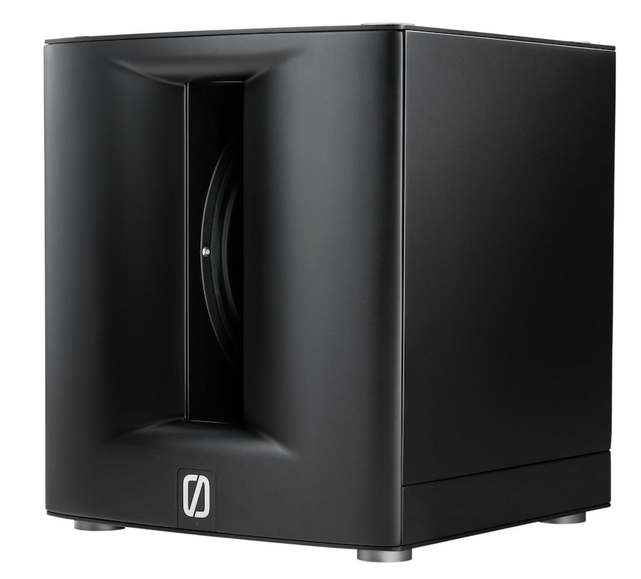

Like the larger BM3, the Børresen BM2 uses the company’s folded dipole architecture, which is intended to avoid some of the acoustic compromises associated with conventional sealed or ported subwoofer designs.

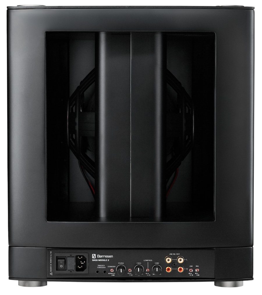

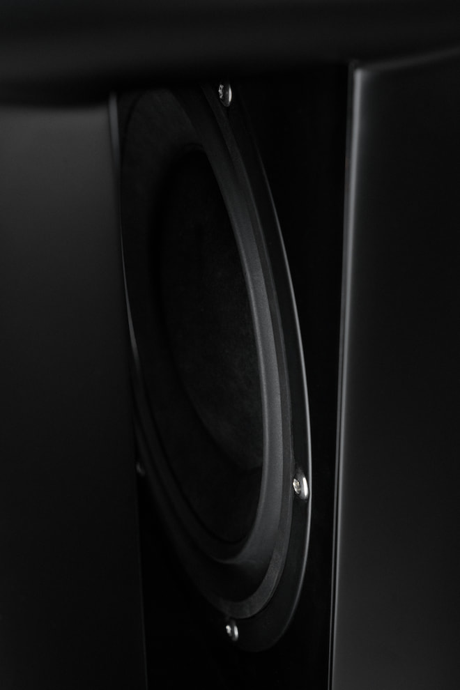

The BM2 uses two 10-inch drivers. Børresen says the combined cone area is comparable to that of a traditional 15-inch woofer, allowing the BM2 to generate meaningful low-frequency output from a more compact cabinet.
Inside the folded dipole structure, both drivers share a common front opening, while the rear of each driver remains open toward the back of the enclosure. That arrangement allows the cones to radiate in opposite directions and phases, creating the side cancellation pattern that is central to the folded dipole approach.
Because the BM2 does not operate like a conventional pressurized box, Børresen claims the design reduces room interaction and helps minimize some of the boom and fatigue that can occur when low-frequency energy overloads a room. That does not make room placement irrelevant, because physics still likes to collect rent, but the design is intended to make integration easier and more natural within a properly matched system.
The larger BM3 has already demonstrated that Børresen’s folded dipole concept can add scale, weight, and speed inside the Audio Group Denmark ecosystem without sounding slow or bloated. The BM2 applies the same core idea in a smaller and less expensive package, with the goal of delivering useful bass extension while preserving transient response and control.

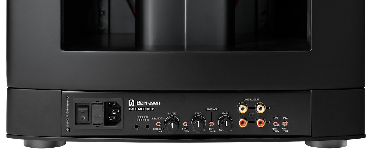

Unlike many modern subwoofers that rely heavily on digital signal processing, the Børresen BM2 uses a fully analog crossover built with selected high-grade components. The goal is to avoid the latency that DSP can introduce and help preserve timing accuracy between the bass module and the main loudspeakers.
The BM2 includes an adjustable low-pass filter, which allows frequencies below the selected crossover point to pass while attenuating frequencies above it. The crossover point can be manually adjusted from 30 Hz to 170 Hz using the rear-panel controls, giving listeners more flexibility when matching the BM2 with different loudspeakers and room setups.
Once the crossover frequency is selected, the BM2 rolls off frequencies above that point at a 24 dB/octave slope. That should make integration more predictable, especially in systems where the goal is bass reinforcement rather than turning the room into a poorly supervised nightclub.
