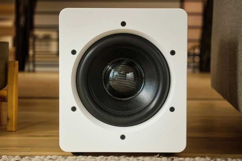

ps-audio-foundry-f12-subwoofer-white-front-no-grille
PS Audio is positioning the Foundry F12 as a sealed subwoofer designed for accuracy and consistency in real listening rooms. It is currently the only model in the Foundry lineup, and it is clearly intended as a single, full-range solution rather than part of a staged rollout.
The core idea behind the F12 is straightforward. Low-frequency performance is dominated by room behavior, especially below 200 Hz, and many subwoofers prioritize maximum output over control and integration. PS Audio’s approach with the F12 is to focus on predictable bass response, manageable placement, and compatibility with both music and home theater systems, without relying on ports or exaggerated tuning.
The F12 uses a sealed enclosure, a long-throw driver developed for this application, a high-power internal amplifier, and onboard DSP to manage low-frequency behavior. None of this is unusual on its own, but the combination reflects an emphasis on control rather than sheer output. The design goal is bass that integrates cleanly with main speakers and maintains timing and tonal balance at normal listening levels.
PS Audio also emphasizes ease of integration and placement flexibility. The enclosure size is intended to allow positioning based on acoustic needs rather than furniture constraints, and the system is designed to work in a wide range of room sizes without requiring extreme calibration or multiple subs.
In practical terms, the Foundry F12 appears aimed at listeners who want low-frequency extension that supports the rest of the system instead of drawing attention to itself. It is not positioned as a budget option or a high-output specialist, but as a controlled, sealed subwoofer built to perform consistently in everyday listening environments.

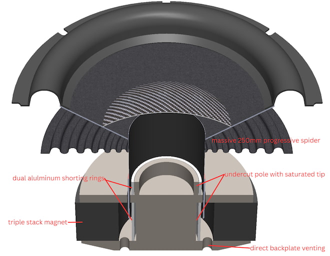

ps-audio-foundry-f12-driver-cutaway
Custom 12-inch Driver: The Foundry F12 uses a custom 12-inch long-throw driver designed specifically for sealed-enclosure operation and consistent in-room performance. Rather than chasing maximum output, the focus is on linear excursion and control, allowing the driver to move a significant volume of air while remaining stable across its operating range. Although the F12 is supported by a 1,000-watt continuous amplifier, the design priority is precision—clean starts and stops, accurate tracking of musical dynamics, and the avoidance of overhang or compression that can blur low-frequency detail.
