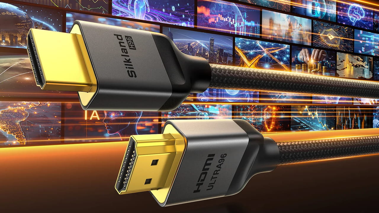

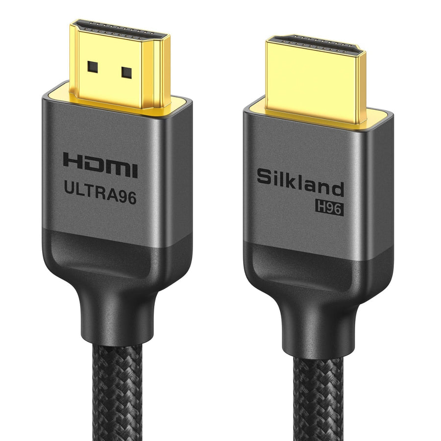

Silkland has now introduced its H96 series, with the S2705 2 meter and S2707 3 meter models among the first Certified Ultra96 HDMI products available to consumers. The company also offers 1 and 1.5 meter versions, with additional lengths expected to follow.
At 96Gbps, maintaining signal integrity becomes more difficult as cable length increases, so launching with two individually certified lengths is an engineering achievement as well as a market first for Silkland.

The H96 is backward compatible with existing HDMI devices, including current 48Gbps HDMI 2.1 hardware, while providing the additional bandwidth required by future 96Gbps HDMI 2.2 products expected to begin reaching consumers in 2027.
“Every new HDMI generation starts with the same question: is it certified — and can I actually buy it?” said Vincent, CEO of Silkland. “Today the answer to both is yes. The H96 isn’t a ‘coming soon’ page — it’s certified, labeled, and on sale today. Scan it yourself.”
Pro Tip: Any current or forthcoming Certified Ultra96 HDMI cables are backward compatible. If you want to buy one now to future proof your setup, it will still work with earlier HDMI versions supported by your existing hardware, including TVs, AVRs and media players. You simply will not gain access to HDMI 2.2 features until the source and display components in the chain support them as well.
