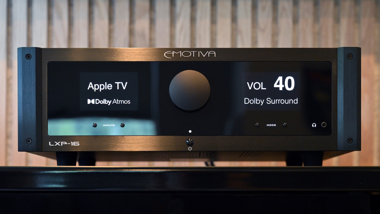

emotiva-lxp16-front-angle
Emotiva LXP-16
Both LX Series models can process a 9.4.6-channel system with left, center and right front channels, a pair of front wides, side surrounds, rear surrounds, four independently managed subwoofers and six height channels.
In practical terms, that means up to 15 independently processed loudspeaker channels plus four independent subwoofer feeds, with support for Dolby Atmos and DTS Pro.
More important for elaborate theater installations, those four subwoofer outputs are not simply four connectors carrying the same signal. Each is a balanced XLR output that can be independently adjusted for level and distance before being integrated by Dirac.
That distinction becomes increasingly important as systems move beyond one or two subwoofers. Multiple subs can improve bass consistency throughout a room, but only when placement, timing, level, and frequency response are properly managed. Four outputs are substantially more useful when the processor actually knows that four different subwoofers exist.

Emotiva LXP-16 Immersive Cinema Processor
emotiva-lxp16-front-back
The LXP-16 is the separates option and requires external power amplification.
Internally, Emotiva is using a balanced architecture with Analog Devices SHARC DSP processing and ESS Hyperstream DAC technology. Emotiva has not identified the specific ESS DAC chips, so there is no reason to guess.
The processor provides 15 balanced XLR preamp outputs and 15 unbalanced RCA preamp outputs, with both sets available simultaneously. Four additional balanced XLR outputs are dedicated to the subwoofers. Maximum published output is 8V RMS through the balanced connections and 4V RMS through RCA.
