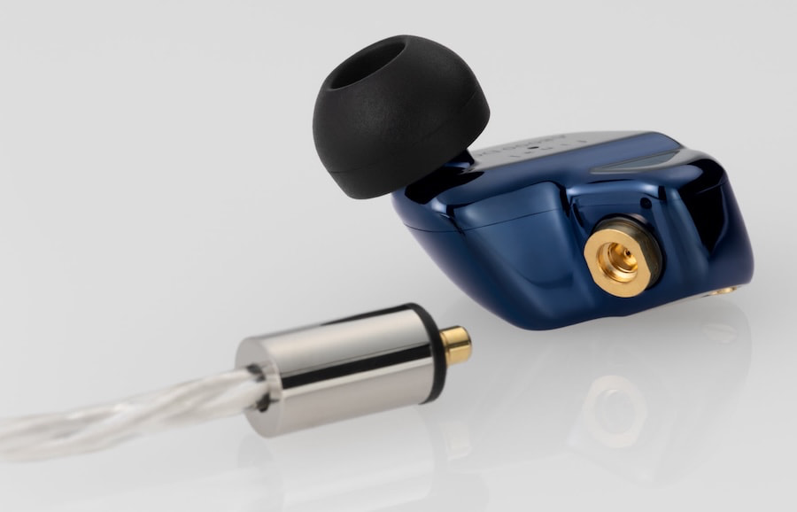

Final Audio is bringing back one of its most ambitious wired in-ear monitors with the new A8000 DC, replacing the pure beryllium diaphragm of the original A8000 (2019 model) with a newly developed magnesium-alloy design. Announced October 23, 2026, and scheduled to launch in Japan on October 30, the premium IEM represents a significant engineering overhaul rather than another expensive refresh with a different finish and a more elaborate carrying case.
The original A8000 developed a following for its clarity, transient response, and unusually sophisticated single dynamic driver, but Final eventually discontinued it because sourcing its beryllium diaphragm material became increasingly difficult. Rather than searching for another supplier, the Japanese manufacturer decided to rethink the entire design, incorporating research from its more expensive diamond-diaphragm A10000 ($2,999 at Audio46).
The DC designation stands for Da Capo, the musical instruction to return to the beginning. It’s an appropriate name, although most manufacturers would have called this the A8000 Mk II, added some gold lettering, and charged extra for the privilege.
final-a8000-dc-iem-tip-closeup
Why Magnesium? Because Beryllium Isn’t the Only Answer
Beryllium has long been prized by headphone manufacturers for its exceptional stiffness-to-weight ratio, which helps minimize unwanted diaphragm deformation. Magnesium isn’t inherently as stiff, but Final believes it has found a way to exploit the material’s lower density to achieve similar or potentially better performance.
Magnesium weighs approximately two-thirds as much as aluminum by volume, allowing engineers to increase diaphragm thickness without adding excessive mass. Since bending stiffness increases dramatically with thickness, Final combines a specially developed magnesium alloy with optimized dome geometry to create what it calls its True Magnesium diaphragm.
The company claims its new driver produces less distortion than the original beryllium version, even at frequencies around 10Hz. That’s an interesting engineering achievement if independently verified, although distortion measurements at frequencies well below the conventional audible range don’t automatically tell us how these IEMs will sound with music.
final-a8000-dc-iem-input
What Else Has Final Changed?
The diaphragm is only part of the story. Final has adopted a specialized polyurethane suspension developed during the creation of its diamond-diaphragm A10000, with the goal of controlling unwanted resonances while preserving the driver’s freedom of movement.
The company also uses a combination of pressure forming and thermal molding to join the diaphragm and suspension without conventional adhesive. By eliminating variations in glue application, Final hopes to improve manufacturing consistency. A redesigned voice coil uses proprietary aluminum-alloy wire, with its lead wires routed to avoid restricting diaphragm movement.
The changes extend to the enclosure. Each earpiece uses a precision-machined stainless-steel housing finished in deep navy with ion plating, while a screw-based assembly replaces conventional adhesive construction to improve serviceability. Final has also reduced the housing’s size compared with the original A8000 and adjusted its contact surfaces to improve fit.
There’s also a detachable cable developed with Japanese materials specialist Junkosha, combining silver-coated oxygen-free copper conductors with expanded PTFE insulation and revised MMCX connectors with 4.4mm balanced plug.
