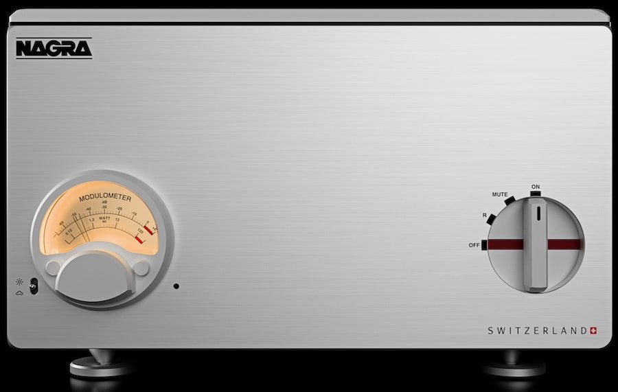

nagra-amp-ii-s-amplifier-front
Swiss Precision, Without the Industrial-Sized Chassis
Nagra has also made substantial changes to the mechanical design. A large CNC-machined heatsink provides thermal stability, while a dedicated transformer suspension is intended to reduce the transmission of mechanical vibrations into the chassis.

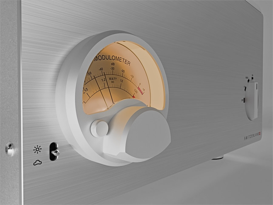

The front-panel controls are optically isolated from the audio circuitry, reflecting Nagra’s preference for keeping potential sources of electrical noise away from the signal path. These may sound like small details, but they matter when the engineering objective is to preserve very low-level musical information.
The familiar Modulometer remains on the front panel, providing an unmistakable connection to Nagra’s professional recording machines, particularly the legendary IV-S reel-to-reel recorder. It also ensures that anyone walking into your listening room knows this isn’t something you picked up during a weekend sale at Best Buy.
One rather interesting development is the additional mass. The original Classic AMP weighed approximately 39.7 pounds, while the AMP II-S tips the scales at 54 pounds. Nagra has clearly invested in more substantial mechanical construction rather than trying to impress customers with an empty box and an oversized price tag.
