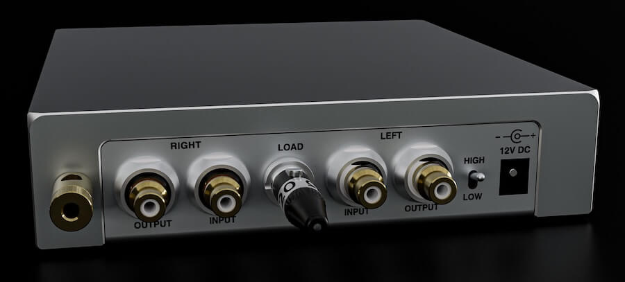

NAGRA Compact Phono Stage Rear View
Nagra Compact Phono (rear)

The Nagra Compact Phono does not offer the same degree of cartridge loading flexibility as its much more expensive sibling or its rather elaborate construction; It is dual-mono, pure Class A with 100% tube stages. In addition, it incorporates remote control cartridge load adjustability from 5 to 390 Ohms, with steps as fine as 5 Ohms for smaller values.

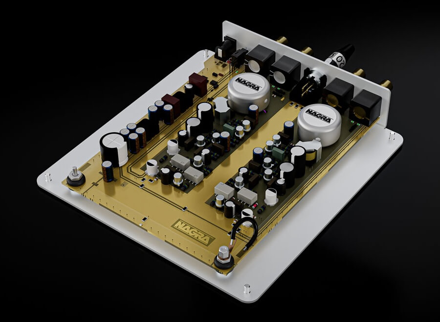

NAGRA Compact Phono Stage Internal Side View

Features:

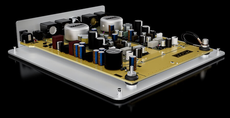

  • Vibration-controlled housing, machined from a solid billet of aluminum. To minimize vibration further, the Compact Phono can also rest on a Nagra VFS or on its own Compact VFS, currently under development.
  • MC input on 10 dB step-up transformer (same as the Nagra VPS)
  • Selected transistors operating in class A
  • All discrete-component topology
  • Dual-Mono layout
  • Selectable gain of 62/47.5 dB
  • RIAA Equalization
  • 100 Ohm load (additional loads available from Nagra dealers)
  • External 12 V DC power supply
  • Ultra-high rejection ratio regulators coupled with dual-stage filters on internal power supply
The Compact Phono has also been upgraded to achieve greater performance when using the Nagra MPS or Classic PSU power supplies. In this case, a Lemo to DC cable is required.
NAGRA Compact Phono Stage Internal Top View
