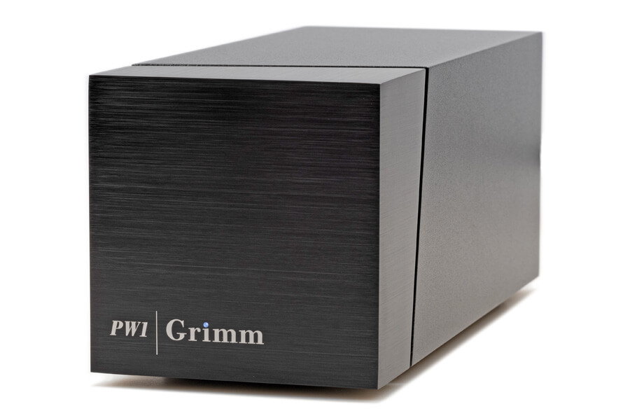

Grimm Audio PW1 Phono Preamp Angle
Grimm claims that Peter developed a solid-state FET (Field-Effect Transistor) phono preamplifier that matches his best tube-based designs, staying true to minimalistic design principles, using the smallest amount of hand-selected active components, and taking great care of their electronic and mechanical surroundings.

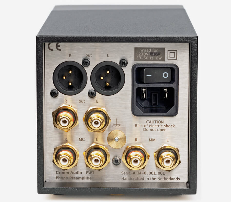

The PW1 provides both MM (Moving Magnet) and MC (Moving Coil) cartridge phono inputs and RCA unbalanced and XLR-balanced outputs to connect to almost any amplifier or audio system for listening to speakers.
Grimm Audio PW1 Phono Preamp Rear View - Conenctions

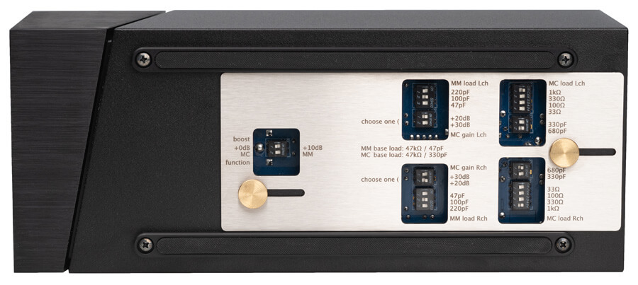

Gain and Load setting controls are placed behind a sliding panel on the bottom of the PW1 (kind of an odd location). Gain settings provide an additional 10 dB for MM inputs and up to 77 dB for MC, accommodating the wide range of available cartridges. Load settings for both MM and MC cartridges provide additional fine-tuning.
Grimm Audio PW1 Phono Preamp Bottom View Open
