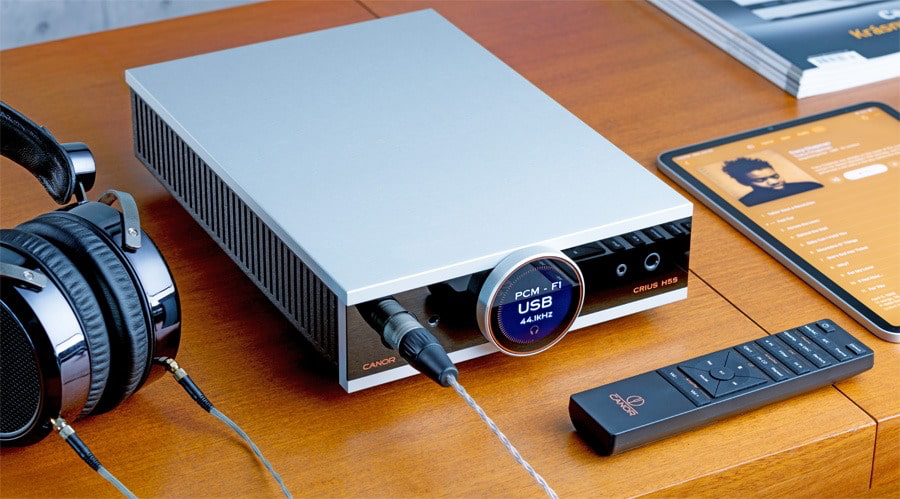

Canor Audio may be best known for its vacuum tube components, but there isn’t a glowing tube anywhere inside the Crius H5S. Instead, the company has combined a headphone amplifier, DAC, and preamplifier in a compact, stylish chassis designed for both desktop listening and conventional Hi-Fi systems. The absence of tubes isn’t necessarily a drawback, especially for listeners who would rather enjoy their music than worry about replacing expensive glass.
According to Canor, the Crius H5S is engineered to drive everything from sensitive in-ear monitors to demanding full-size headphones. It can also connect digital and analog sources to a power amplifier or active loudspeakers, making it a versatile centerpiece for a system without requiring an equipment rack full of separate components.
As part of Canor’s Essential Line, the Crius H5S incorporates a dual-mono DAC architecture with fully discrete, balanced analog output stages. Its solid-state signal path eliminates operational amplifiers and coupling capacitors, relying instead on optimized local feedback and adaptive Class A/AB biasing. It’s a sophisticated approach for a component that promises to do three jobs without taking up the space of three separate boxes.

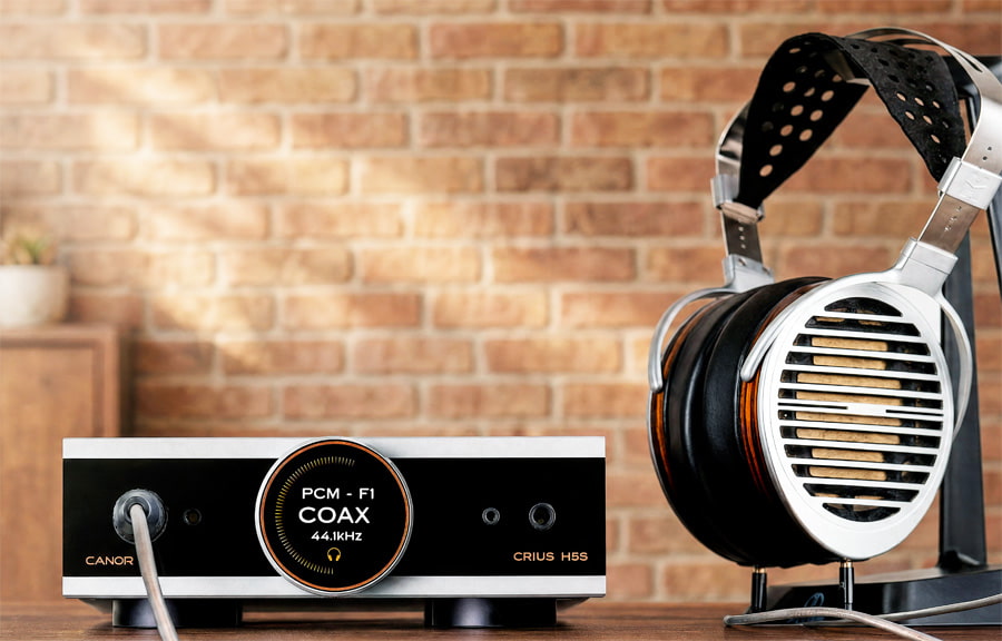

Four Watts of Muscle: Class A Refinement Meets Class AB Headroom
The Canor Crius H5S is designed to drive a wide range of headphones, from sensitive in-ear monitors to demanding planar-magnetic models. Its balanced 4-pin XLR and 4.4mm outputs deliver up to 4 watts into 30 ohms, while the single-ended 6.3mm and 3.5mm connections provide up to 1 watt into 30 ohms. That’s a substantial amount of power for a compact component, offering flexibility for listeners with different headphone types and power requirements.
Canor employs discrete local feedback throughout the amplification circuitry to improve linearity and minimize distortion, claiming less than 0.003% THD at 500mW into 30 ohms. An adaptive bias circuit transitions between Class A and Class AB operation, combining the low-level operating characteristics of Class A with the additional headroom and efficiency of Class AB when more power is required. It’s a sensible engineering compromise that prioritizes performance over allegiance to a particular amplifier class, which should give audiophiles one less thing to argue about. Perhaps.
