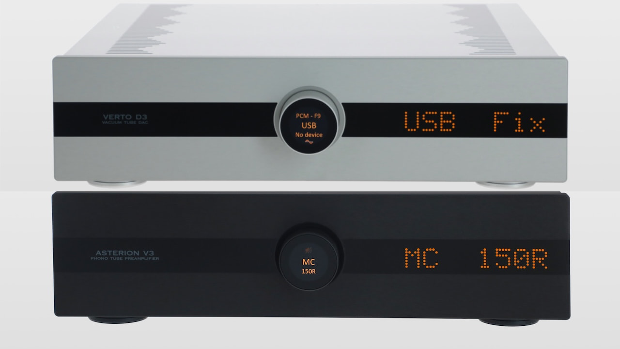

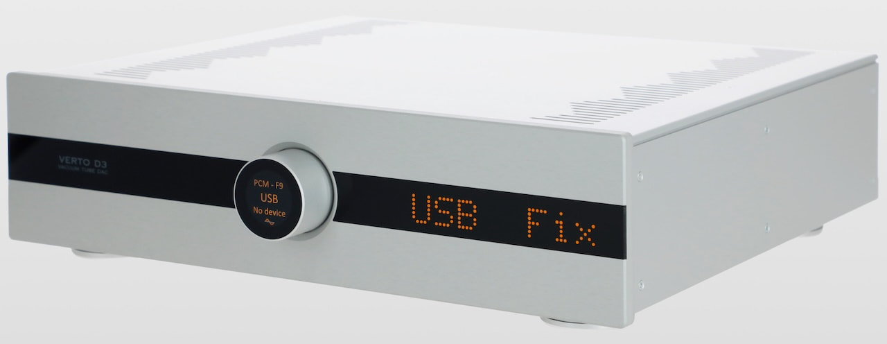

The Canor Verto D3 is a high-end tube DAC built around a fully balanced, dual-mono discrete architecture. Its analog output stage uses four carefully matched E88CC tubes operating in pure Class A, with Canor aiming to bring more body, scale, and natural texture to digital playback.
The Verto D3 uses galvanically isolated digital inputs to reduce noise transfer between connected sources. Signal processing is handled by a multi-core XMOS controller, and format support extends to PCM up to 768kHz and native DSD512.
Connectivity includes USB, AES/EBU, coaxial digital, optical, and HDMI inputs, along with RCA and XLR analog outputs. Canor also specifies fixed and variable output options, allowing the Verto D3 to operate either as a traditional DAC or directly into a power amplifier.
The chassis combines machined aluminum and steel, while the front panel integrates a touchscreen into the precision-bearing control knob. Firmware updates are supported via USB.
canor-verto-d3-black-rear-view
Canor ModelVerto D3
Product TypeTube DAC
Price£3799 (Contact dealer for US pricing)
DAC Configuration2 x ES9039Q2M (Dual-mono)
Filter Settings9 x Digital Filter
Digital Inputs1 x USB-B (PCM up to 24-bit / 768 kHz & DoP DSD up to DSD256 & Native DSD up to DSD512)
1 x AES/ABU (PCM up to 24-bit / 192kHz, DoP DSD 64)
1 x Coax (PCM up to 24-bit / 192kHz, DoP DSD 64)
2 x Opto (PCM up to 24-bit / 192kHz, DoP DSD 64)
1 x HDMI Input (PCM up to 24-bit / 192 kHz)
Analog Outputs1 pair RCA
1 pair XLR
Output ImpedanceRCA: 100 Ω
XLR: 200 Ω
Frequency Range+- 0.1 dB at 20 – 20 000 Hz
Total Harmonic Distortion (XLR)< 0.009 %
Output VoltageRCA: 2 VRMS
XLR: 4 VRMS
Signal-to-noise ratio (XLR)> 110 dB (A-wt)
Crosstalk (XLR)> 124 dB
Tube Complement4 x E88CC
Trigger Connectors (12 V)1 x IN (3.5 mm jack)
1 x OUT (3.5 mm jack)
Power230 V /  50-60 Hz / 40 VA
Dimensions (WHD)435 x 122 x 370 mm
17.13 x 4.8 x 14.6 inches
Dimensions (WHD with knob & connectors)435 x 122 x 415 mm
17.13 x 4.8 x 16.34 inches
Weight (Net)12 kg / 26.5 lbs

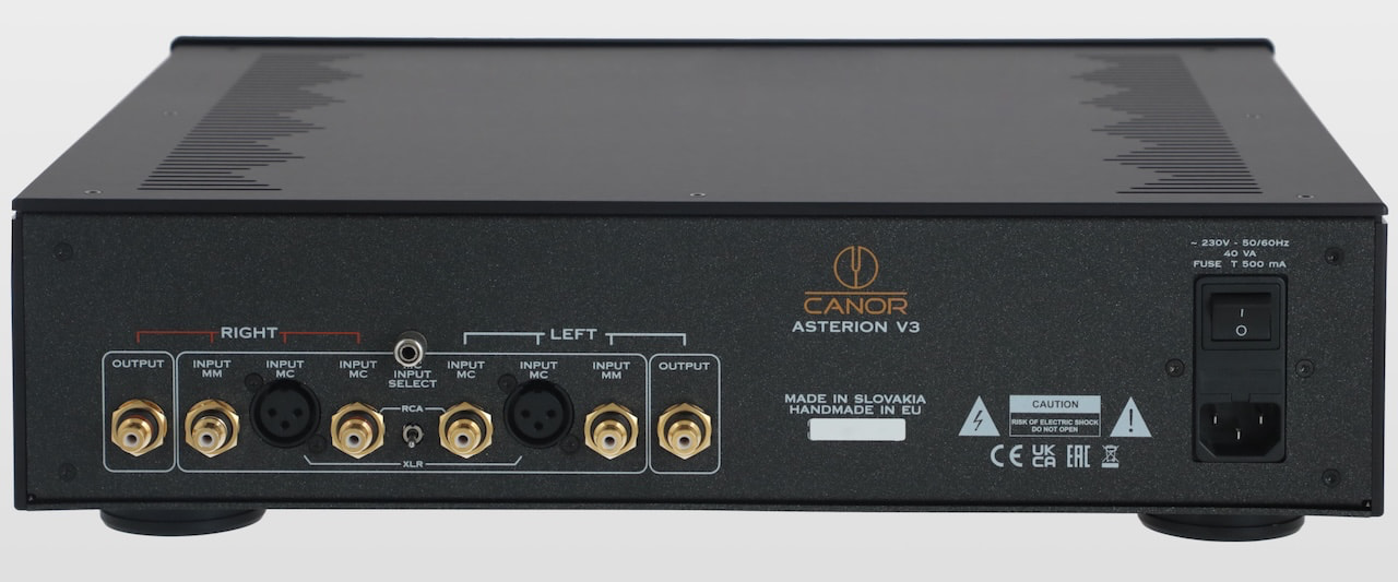

Canor Asterion V3 Tube Phono Preamplifier
canor-asterion-v3-black-perspective-view

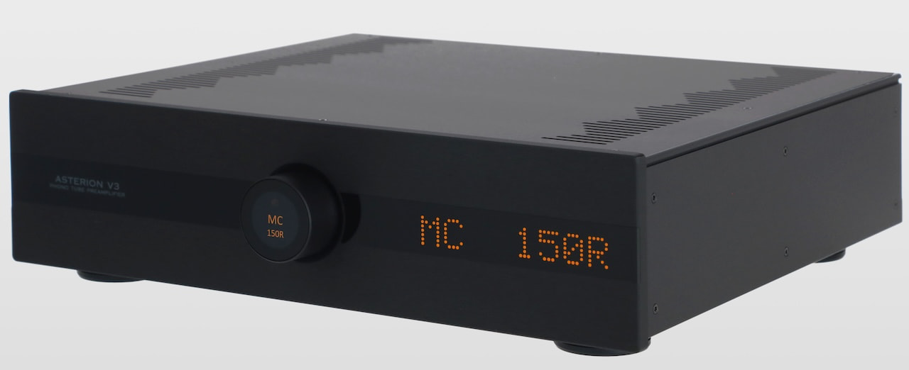

The Canor Asterion V3 is a tube-based phono preamplifier designed for both MM and MC cartridges. It includes balanced XLR and unbalanced RCA MC inputs, along with adjustable resistance and capacitance loading, giving users the flexibility to match the phono stage to a wide range of cartridges.
For moving-coil cartridges, the Asterion V3 uses a Lundahl step-up transformer to provide low-noise signal gain before the tube amplification stage. RIAA equalization is handled by a fully passive correction network using polystyrene and polypropylene capacitors.
The Asterion V3 also allows two cartridges to remain connected at the same time — one MM and one MC — with input switching from the front panel. Control is handled through a touchscreen integrated into the front-panel control knob, with remote operation also supported from the listening position.
The chassis is constructed from aluminum and steel, matching the industrial design language of Canor’s Performance Line components.
canor-asterion-v3-black-rear-view
Canor ModelAsterion V3
Product TypeTube Phono Preamplifier
Price£4199 (Contact dealer for US pricing)
GainMM 46 dB
MC 70 dB
Input impedance MC10, 20, 40, 80, 150, 300, 600, 1200 Ω
Input capacitance MM50, 150, 270, 370, 520, 620, 740, 840 pF
Output impedance< 500 Ω
Inputs2 RCA pairs, 1 XLR pair
Output1 RCA pair
Total harmonic distortion (MM, MC)< 0.2 % / 1 Vrms
Subsonic filter18 dB / Octave
RIAA accuracy (MM, MC)+- 0.3 dB / 20 – 20 000 Hz
Signal-to-noise ratio MM> 71 dBV (86 dBV – IEC – A)
Signal-to-noise ratio MC> 68 dBV (82 dBV – IEC – A)
Tube Complement2 x ECC83S, 2 x ECC81
Power230 V / 50 – 60 Hz / 40 VA
