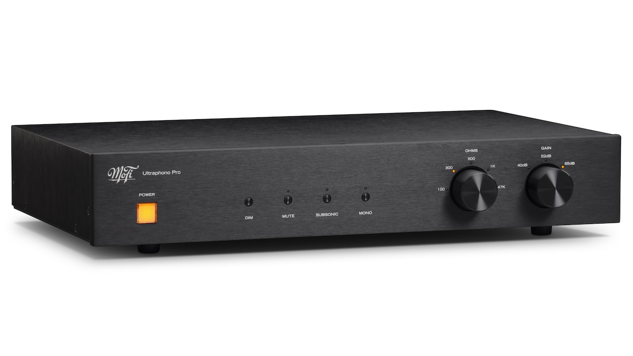

Vinyl isn’t having a moment anymore, it’s entrenched. Turntables are selling, cartridges are backordered, and phono preamps are once again a real battleground instead of an afterthought. With the $2,495 UltraPhono Pro, MoFi Electronics finally fills a very obvious gap in its lineup by bringing much of the sonic DNA of its flagship MasterPhono down to a price point where the fight actually is.
Designed by Peter Madnick and built around the same ultra-low-noise circuit concepts and parts philosophy that made the MasterPhono a serious contender at the top end, the UltraPhono Pro strips away the excess and focuses on what matters: clean gain, flexibility for MM and MC cartridges, and musical accuracy.
Just as importantly, it gives MoFi a credible sub-$2,500 answer to established heavyweights like Pro-Ject, EAR, E.A.T., MOON by Simaudio, Rega, and Musical Fidelity; a segment where serious vinyl listeners actually shop. In short, this is MoFi admitting the obvious: the market below its halo gear is thriving, and now they’re properly in the game.

Despite its streamlined approach, the UltraPhono Pro is anything but entry-level. It delivers up to 71 dB of gain, maintains a wide and linear frequency response from 10 Hz to 50 kHz (±0.2 dB), and achieves exceptionally accurate RIAA equalization rated at ±0.05 dB. Noise performance is equally impressive, allowing low-output moving-coil cartridges to play against a quiet, stable background with excellent dynamic contrast.
User-facing features are practical and thoughtfully implemented. Front-panel controls include mono mode, mute, a subsonic filter, and dimmable faceplate illumination. Cartridge matching is straightforward and flexible, with multiple loading options for moving-coil cartridges and selectable gain settings that support both single-ended and balanced system integration.
