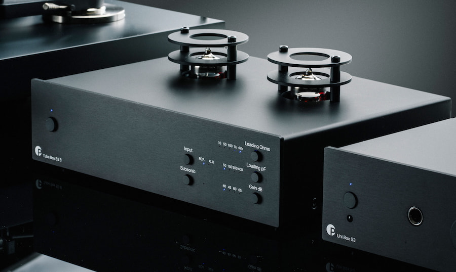

Pro-Ject Tube Box S3 B
pro-ject-tube-box-s3-b-black
The Tube Box S3 B provides a wide range of gain options, from 40–65dB, making it compatible with both moving magnet and moving coil cartridges. Control switches let you select inputs or toggle the subsonic filter, which Pro-Ject designed to simplify everyday use.
This is a serious piece of kit for anyone who wants a tube phono stage without gimmicks. Balanced 5-pin mini XLR inputs and full XLR outputs keep the signal clean, while the symmetrical, discrete gain stage handles both MM and MC cartridges.
Two user-replaceable ECC83 tubes sit at the heart of the design, backed by a dual-mono layout and semi-passive RIAA equalization for low noise and minimal distortion. Settings are accessible right from the faceplate, and the aluminium casing keeps interference at bay. Available in silver or black and made in Europe, it’s the kind of well engineered gear that has solidified Pro-Ject’s reputation as a brand that can offer entry-level electronics that really deliver great performance at reasonable prices.
Tube Box S3 B – Technical Specifications
  • Tube Assembly: 2x ECC83 (12AX7)
  • Input Impedance: 10, 50, 100, 1k, 47k Ω
  • Input Capacitance: 50, 150, 300, 400 pF
  • Gain (+6dB via XLR Out): 40, 45, 60, 65 dB
  • Signal-to-Noise Ratio (MM, 40dB): 97dBV / 105dBV (‘A’ weighted)
  • Signal-to-Noise Ratio (MC, 60dB): 83dBV / 88dBV (‘A’ weighted)
  • THD at 1 kHz: <0.005% MM, <0.01% MC
  • THD (20Hz–20kHz): <0.1% MM, <0.03% MC
  • RIAA Equalization Accuracy: <0.4dB (20Hz–20kHz)
  • Subsonic Filter: 20Hz, 18dB/octave
  • Inputs: 1x 5-pin mini XLR, 1x pair RCA phono sockets
  • Line-Level Outputs: 1x pair RCA, 1x pair XLR
  • Power Supply DC: 18V / 1000mA
  • Power Consumption: 18V / 800mA DC, <0.5 W standby
  • Dimensions (W x H x D): 206 x 81 x 153 mm (164 mm with sockets)
  • Weight: 1010 g (without power supply)

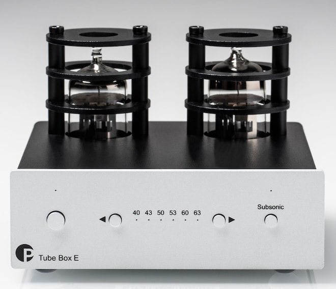

pro-ject-tube-box-e
Pro-Ject Tube Box E
Pro-Ject Tube Box E: Compact, Fully Discrete Tube Phono Stage
For those seeking a more affordable entry into tube phono stages, the Tube Box E offers a fully discrete dual-mono design with adjustable gain, capacitance, and impedance. It supports both moving magnet (MM) and moving coil (MC) cartridges, and includes a front-mounted subsonic filter for added control.
The Tube Box E is housed in a metal enclosure to minimize interference and vibrations, with an aluminium front panel and gold-plated RCA sockets. Dual ECC83 tubes are user-replaceable, allowing for future tube rolling. Based on our experience with other Pro-Ject phono preamps in this price range, we suspect the Tube Box E will offer a warmer, softer presentation.
Tube Box E – Key Features
  • Compatible with MM and MC cartridges
  • Two-part RIAA equalization (passive/active)
  • Fully discrete circuit design without OpAmps
  • 2x ECC83 tubes (replaceable)
  • Front-mounted subsonic filter
  • Front-mounted gain control
  • Ultra-low noise FET input stage
  • Dual-mono design for channel separation
  • Polystyrene capacitors where possible
  • Gold-plated RCA in/out
  • Multiple internal power supplies
  • Well-filtered high-voltage anode supply
  • Aluminium front panel, full metal enclosure
  • Available in silver or black
Tube Box E – Technical Specifications
  • Tubes: 2x ECC83 (12AX7A)
  • Input Impedance: 10 Ω, 100 Ω, 1 kΩ, 2 kΩ
  • Input Capacitance: 47pF, 147pF, 267pF, 367pF, 487pF, 587pF / 47 kΩ
  • Gain: 40 dB, 43 dB / 50 dB, 60 dB, 63 dB
  • Noise Floor: 77 dB (A-weighted) at 40 dB gain; 65 dB (A-weighted) at 50/63 dB gain
  • THD: <0.03% at 40 dB gain; <0.07% at 50/63 dB gain
  • RIAA Accuracy: ±0.5 dB (20 Hz – 20 kHz)
  • Subsonic Filter: 20 Hz, 18 dB/octave
  • Inputs: 1x pair RCA/phono sockets
  • Outputs: 1x pair RCA/phono sockets
  • Power Supply: 18V / 1000 mA DC (external, country-specific)
  • Power Consumption: 470 mA DC, <1 W standby
  • Dimensions (W x H x D): 103 x 73 x 131 mm
  • Weight: 450 g (without power supply)
