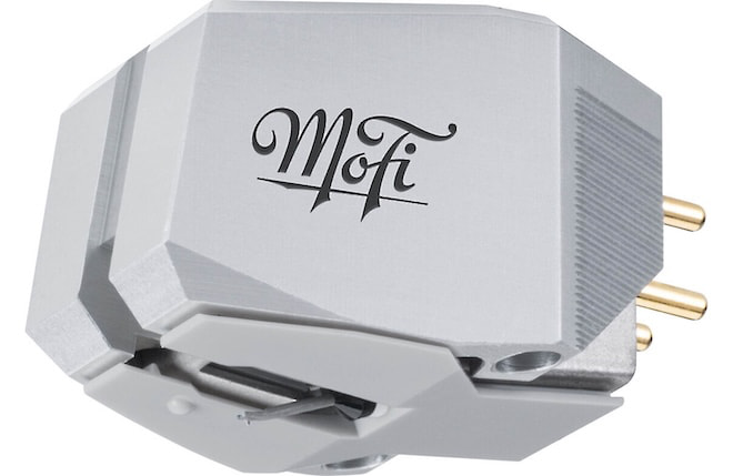

MoFi UltraTracker ($349)
mofi-ultratracker-phono-cartridge
The MoFi UltraTracker earns its spot on our list because it does exactly what a great $300-$350 moving-magnet cartridge is supposed to do: it makes vinyl fun again without dumbing things down. The UltraTracker has real drive and momentum—it puts pep into lethargic systems, locks onto grooves that would send cheaper carts skating toward the label, and keeps music centered and coherent even when records aren’t museum-grade. That combination of excellent tracking, punchy dynamics, and a forgiving—but not soft—presentation makes it an obvious upgrade from entry-level cartridges, whether it’s bolted to an all-tube rig with horn speakers or a modest solid-state setup with bookshelf monitors. This is the kind of cartridge that gets people buying more records, not tweaking VTA until their coffee goes cold.
Just as important, the UltraTracker scales well and plays nicely with real-world systems. Its 3.5mV output and sane loading requirements mean it works with a wide range of phono stages, while the nude elliptical stylus digs out musical detail without turning surface noise into the main event. The fact that it’s used weekly on an all-vinyl FM broadcast says a lot—this thing tracks reliably, sounds consistent, and doesn’t panic when confronted with a well-loved LP. At $349, it’s not boutique jewelry, it’s a working cartridge with broadcast-level reliability and crowd-pleasing sound. That’s why it’s on the Editors’ Choice list: performance, value, and zero drama—just spin records and enjoy.
