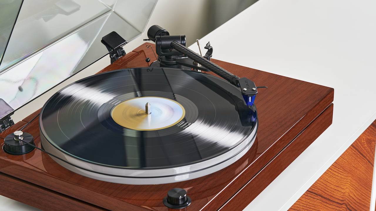

Dual Plinth Construction
fluance-rt87-dual-plinth
The RT87’s most distinctive physical attribute is its newly developed dual-plinth architecture, designed to isolate key signal-path components from unwanted resonance and environmental vibration. The motor is mounted independently on the lower plinth, while the tonearm and cartridge assembly sit on a decoupled upper plinth, separated by precision conical isolators.
The physical separation created by the RT87’s dual-plinth construction is designed to reduce the transfer of motor-borne resonance and external vibration before it can reach the stylus. The dense wood plinths are also intended to help damp mechanical resonance within the chassis. If properly implemented, this type of isolation can support more stable groove tracking, a lower noise floor, and improved clarity across the soundstage.
The Tonearm
fluance-rt87-tonearm
The RT87 features a 9-inch carbon fiber tonearm designed for low resonance, high rigidity, and precise stylus control. Its straight-arm geometry and 230 mm effective length are intended to trace a controlled arc across the record surface, helping reduce tracking error when properly aligned. The tonearm supports cartridges weighing 5 to 9.5 grams.
Adjustable Vertical Tracking Angle (VTA)
fluance-rt87-vta
This feature enables listeners to fine-tune cartridge alignment for optimal stylus contact and enhanced detail retrieval, while a removable headshell makes cartridge upgrades and adjustments simple, giving listeners the flexibility to evolve their setup over time.

High-Mass Acrylic Platter
fluance-rt87-turntable-walnut
Fluance RT87 Turntable (Walnut) with Audio-Technica AT-VM95ML
For improved playback stability, the RT87 uses a thicker and heavier 22 mm, 4.1-pound anti-static acrylic platter. Compared with the 16 mm, 3-pound acrylic platter used on the RT85 and RT85N, the new platter adds both thickness and mass, which should increase rotational inertia and may help reduce speed instability. Fluance also claims the acrylic construction helps damp unwanted resonance and reduce static. The belt-drive system supports 33⅓, 45, and 78 RPM playback speeds, and the RT87 also includes auto-stop functionality.
