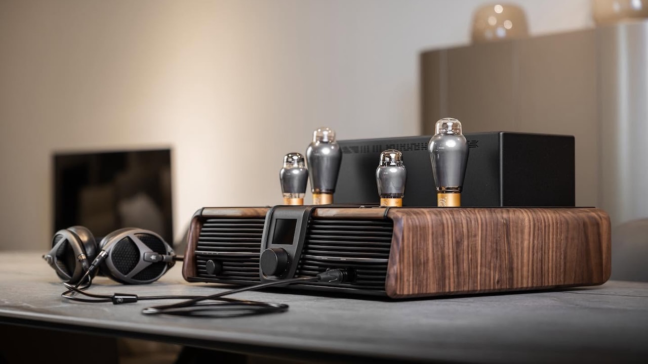

We first saw the Feliks Audio EOS in prototype form at HIGH END Vienna 2026, but the Polish manufacturer has finally published a proper product page and a substantially more complete set of production specifications.
And there is a lot more going on here than another expensive 300B headphone amplifier.
The EOS is designed to drive headphones, IEMs and loudspeakers from the same chassis, while also functioning as a balanced or single-ended preamplifier. Feliks rates headphone output as high as 8 watts and speaker output at up to 6 watts, adds a display that monitors the health of the amplifier and its tubes, and wraps everything inside a 57-pound chassis available in Oak or American Walnut.
Welcome to summit-fi in 2026. Apparently $1,000 headphone amplifiers are now the appetizer.
feliks-bliss-tube-amp-oak-front
Feliks Audio BLISS (oak)
From Prototype to Production
The EOS sits above the Envy family as Feliks Audio’s flagship amplifier for conventional dynamic and planar magnetic headphones. The $22,800 Feliks Audio BLISS, which we heard at CanJam NYC 2026, remains the company’s statement product for electrostatic headphones.
Feliks has been building tube amplifiers since 1998, and the EOS brings its headphone and traditional two-channel experience together in one product. Two 300B power tubes are paired with two CV181/6SN7 driver tubes, a combination already familiar to anyone who has spent time with the company’s Envy models.
What has changed is the scope.
The EOS is not merely a headphone amplifier with preamp outputs that can eventually lead to a pair of loudspeakers. There are dedicated speaker outputs, and Feliks has finally put numbers behind them.
For headphones, the company specifies 5 watts at 1% THD, rising to a maximum of 8 watts at 5% THD. For loudspeakers, the figures are 4 watts at 1% THD and 6 watts at 5% THD.
There is an important qualification.
Feliks does not specify the load impedance used for either power rating. We therefore cannot tell you that the EOS produces 5 watts into 32 ohms, 8 watts into 16 ohms or 6 watts into an 8-ohm loudspeaker because the manufacturer has not published that information.

A Tube Amp With a Check Engine Light
One of the more practical EOS additions is the front display.
It shows input, output and gain settings along with a VU meter, but Feliks has also turned it into a diagnostic interface. Owners can view operating voltages, internal temperature and tube-health information, and run a diagnostic check from the front panel.
There is also a remote control with motorized volume adjustment, input switching and gain control. Switching between headphones and loudspeakers does not require disconnecting either load.
Considering what good 300B tubes cost these days, knowing what is happening inside the amplifier before something expensive starts glowing the wrong shade of orange is not a frivolous feature.
The EOS is still unapologetically old-school amplification, but Feliks has clearly decided that owning tubes in 2026 does not require living like it is 1956.
