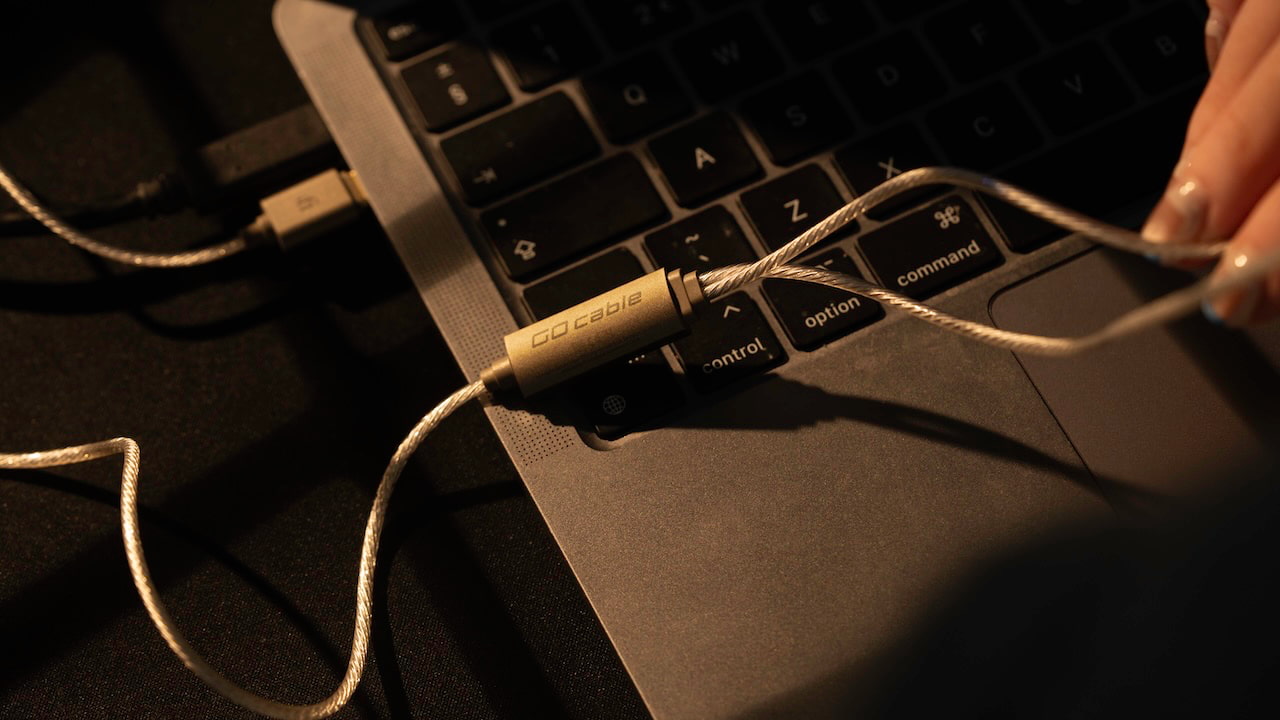

iFi has spent the past few years trying to shrink the portable DAC/headphone amplifier without shrinking what it can do. The new GO cable takes that idea to its logical conclusion by getting rid of the separate dongle almost entirely.
The $79 GO cable integrates an ESS Sabre DAC and headphone amplifier directly into a USB C cable terminated with standard 0.78mm 2-pin connectors for compatible IEMs. Plug one end into a smartphone, tablet, laptop or supported gaming device and the other ends directly into your IEMs. No separate dongle hanging off the phone and no 3.5mm or 4.4mm interconnect. One less object to lose in an airport lounge.

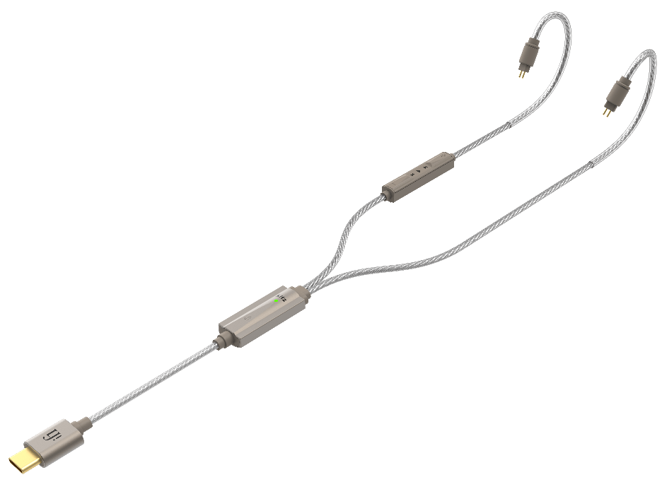

iFi GO Cable Specifications:
  • Hi-Res Support: PCM up to 384kHz; DSD256
  • DAC: ESS DAC with bit-perfect DSD and DXD playback
  • IEM Connection: 0.78mm 2-Pin L/R male
  • Conductor Material: OFHC copper with pure silver
  • Output Power: ≥70mW / 1.5V RMS at 32 ohms; ≥14mW / 2V RMS at 300 ohms
  • Output Impedance: <1 ohm
  • Signal-to-Noise Ratio: ≥125dBA
  • Dynamic Range: ≥125dBA
  • THD+N: ≤0.004% at 1.27V/32 ohms
  • Frequency Response: 10Hz to 80kHz (-0.5dB)
  • Power Consumption: Approximately 0.3W with no signal; <1W at maximum signal
  • Length: 1.37 meters / 4.5 feet (±3cm)
  • Weight: 16g / 0.56 oz
  • Warranty: 12 months; 24 months in the EU
