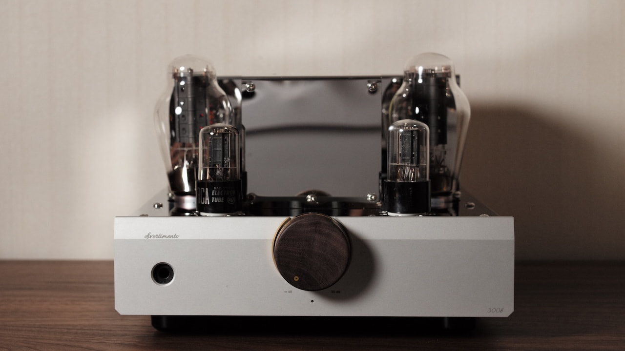

A 300B amplifier delivering single-digit or low double-digit power is hardly unusual. Doing it for $1,499 while also providing a transformer-coupled headphone output, 4- and 8-ohm speaker taps, custom transformers and Cardas internal wiring is a much more interesting proposition.
That is what makes the Layer Audio Design GEN-300B worth a closer look after CanJam SoCal 2026. It is a single-ended Class A integrated amplifier designed to serve both headphone listeners and owners of suitably efficient loudspeakers, without wandering into the five-figure territory that has become increasingly common for ambitious 300B designs.

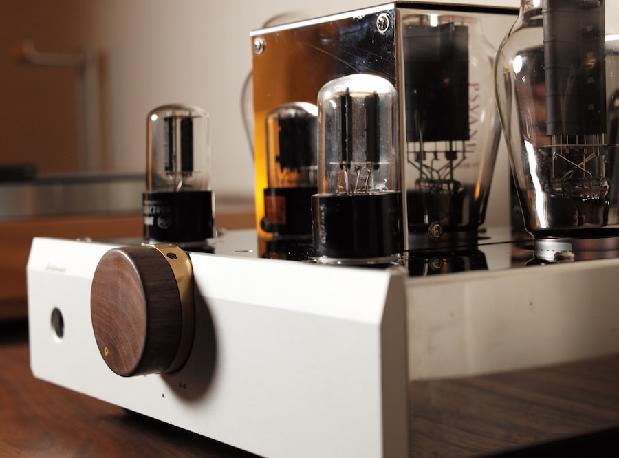

The GEN-300B uses a fully discrete, all-tube signal path built around two 6N8P driver tubes, two 300B output tubes and one 5AR4 rectifier. Layer operates the output stage single-ended in pure Class A and rates the amplifier at 10 watts per channel into 8 ohms, with separate 4- and 8-ohm speaker connections.
Ten watts clearly places some limits on speaker choice. The GEN-300B is intended for high-efficiency loudspeakers rather than insensitive floorstanders with difficult impedance curves, but that is hardly unusual for a single-ended 300B design. The more distinctive part of the package is what Layer has done for headphone users.
Rather than installing a separate solid-state headphone stage, the front headphone output is tube-driven and transformer-coupled from the main amplifier circuit. In other words, headphone listeners are not buying a 300B speaker amplifier with an unrelated headphone circuit tacked onto the front panel.

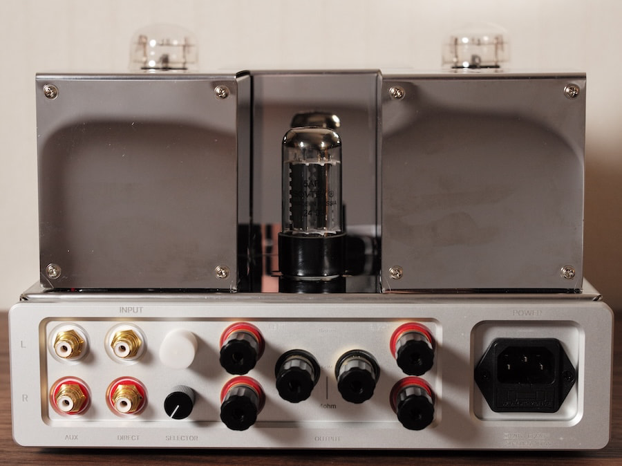

Layer specifies custom-wound Japanese transformers, Amtrans film capacitors and Cardas internal wiring through the signal and power paths. The company notes that the Amtrans capacitors come from the same component series used in Audio-Technica’s NARUKAMI amplifier, although sharing a capacitor family obviously does not make the two amplifiers equivalent designs.
Connectivity remains deliberately simple. The amplifier provides an RCA line-level input and a direct power-amplifier input for use with an external preamplifier, while Bluetooth is available as an option with Layer stating that the wireless module is electrically isolated from the analog circuitry. There is no built-in DAC or network streaming platform, so this remains an analog integrated amplifier first.

InputsRCA line level, direct power amp
Optional inputBluetooth
Speaker outputs4 ohms / 8 ohms

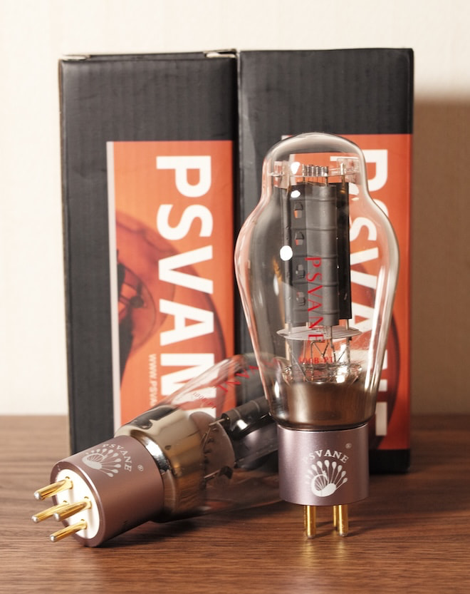

Layer says the standard front-panel headphone output was designed around safe operation and broad compatibility rather than maximum output into the most demanding planar-magnetic headphones. The company subsequently developed the COPULA, a speaker-tap-to-4-pin-XLR adapter that connects directly to the GEN-300B’s binding posts and provides access to considerably more of the amplifier’s available output.
psvane-tubes-with-box
That solution is aimed at unusually inefficient headphones rather than conventional models or IEMs. Layer specifically warns against treating the speaker taps as a universal headphone output, which is sensible advice when the source on the other end is capable of delivering several watts.
