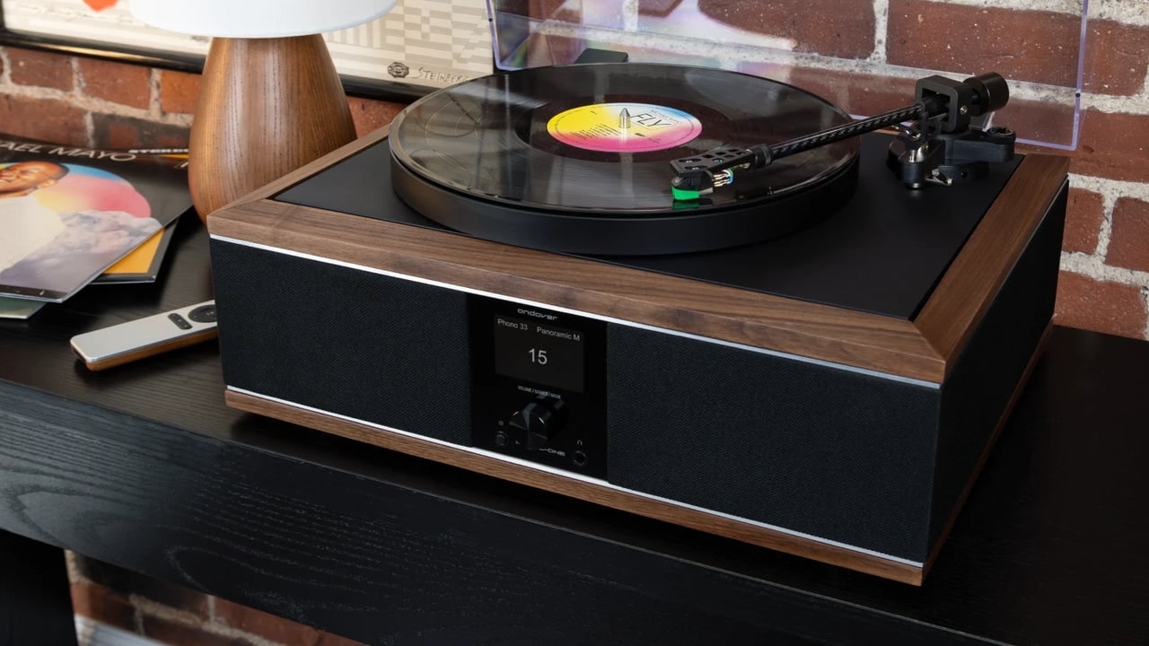

andover-one-mk2-tonearm-angle
What’s New With the Andover One MK2?
Easy Setup: Andover systems have always been designed for simple setup, but the One MK2 goes further with factory preset calibration. Tracking force, anti skate, and cartridge alignment are set before the system leaves the factory, allowing users to place the unit, plug it in, put a record on the platter, cue the tonearm, and start listening.
Audio Technica VM95E Cartridge: The One MK2 includes an Audio Technica VM95E dual moving magnet cartridge, a proven design known for solid channel separation, reliable tracking, and broad stylus upgrade support. Owners can move to other VM95 Series stylus options later without replacing the entire cartridge, giving the system a practical upgrade path.
Adjustable VTA: The One MK2 tonearm allows vertical tracking angle adjustment through a set screw at the tonearm pivot. That gives users more flexibility when changing cartridges or upgrading to more alignment sensitive styli, such as the Audio-Technica AT-VMN95ML or AT-VMN95SH, which benefit from more precise setup than standard conical or elliptical options.
Removable Headshell: The headshell attaches to the tonearm with a locking collar, making cartridge changes, upgrades, cleaning, and inspection easier. It also gives owners a more practical path for future cartridge or stylus maintenance without turning a simple system into a Saturday afternoon crime scene.
Intelligent Auto Stop: The One MK2 adds an optical sensor that stops the turntable motor shortly after the record side ends. The tonearm still needs to be lifted manually, but the auto stop feature helps reduce unnecessary stylus and record wear if the listener does not get to the turntable right away.
Quiet Spin: The One MK2 uses a split plinth design that helps isolate the turntable motor from the speaker enclosure. By reducing motor and enclosure vibration from reaching the stylus, the design is intended to lower noise and improve playback clarity.
Multi-Room Ready: The MK2 provides a Digital Optical Output that enables connection to a compatible external streamer. This includes connection to the Andover Audio Songbird HR Music Streamer or other multi-room capable systems to stream audio from the Mk2 to other rooms.
andover-one-mk2-screen-angle

andover-one-mk2-angle
