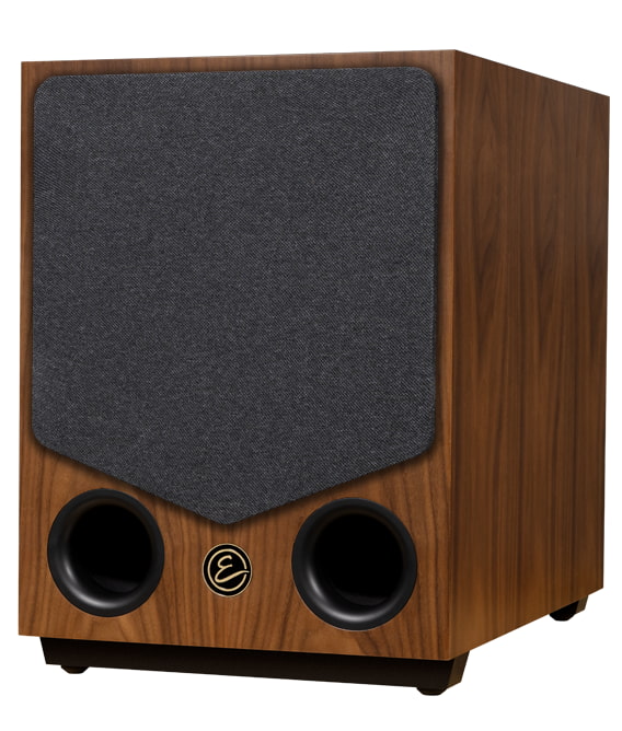

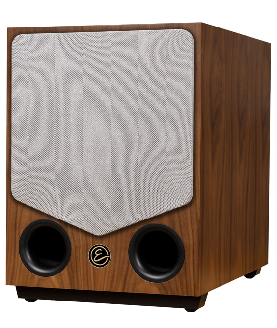

Most premium subwoofers are designed by people who think black lacquer is a personality. The Nostala FT12 takes a more domestic approach with genuine walnut veneer covering every surface, wooden feet, a metal Emotiva badge and two magnetic grilles finished in beige and neutral gray. Even the bass now receives wardrobe options.

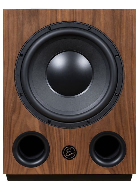

The Nostala FT12 uses a front-firing 12-inch high-excursion woofer with a non-pressed paper cone, die-cast aluminum frame, NBR rubber surround and variable-rate suspension.
Behind the cone is a 65.5mm four-layer copper-clad aluminum voice coil wound on a fiberglass former. Emotiva also uses a substantial 156 x 40mm magnet assembly with an aluminum shorting ring intended to reduce distortion as the driver begins moving enough air to reorganize the items on your coffee table.
The enclosure is a ported design with two large flared ports mounted on the front baffle. Front-facing ports can make placement somewhat easier near walls or furniture because the ports are not firing directly into the wall behind the cabinet. That does not mean owners should wedge 68 pounds of subwoofer into the first available corner and hope for divine intervention, but it provides more flexibility than many rear-ported alternatives.
Emotiva rates the FT12 from 25Hz to 150Hz, ±3dB, with a claimed peak in-room output of 117.5dB at 40Hz. The company says the low-frequency roll-off has been optimized to take advantage of typical room gain. Those figures suggest substantial output for music and most movie content, although the FT12 is not attempting to win the industry’s “who can print the smallest number beside Hz” competition.

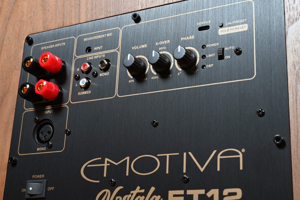

The rear panel is unusually accommodating for both two-channel and multichannel systems.
The FT12 provides a balanced XLR mono input, an unbalanced RCA mono input, stereo RCA line-level inputs and left/right speaker-level inputs. Owners can therefore connect it to an A/V receiver, surround processor, stereo preamplifier, integrated amplifier or even an older receiver without a dedicated subwoofer output.
That speaker-level connectivity matters. Many current subwoofers are designed primarily around an AVR’s LFE output and make traditional stereo users fend for themselves. Emotiva appears to understand that a walnut subwoofer may end up beside a vintage receiver, tube amplifier or integrated amplifier that considers bass management an activity for people with too much free time.
Rear-panel controls include volume, crossover frequency, variable phase, automatic or continuously-on power modes and the calibration control. When using an AVR or processor for bass management, Emotiva recommends turning the subwoofer’s crossover to its highest setting and allowing the source component to manage the crossover.

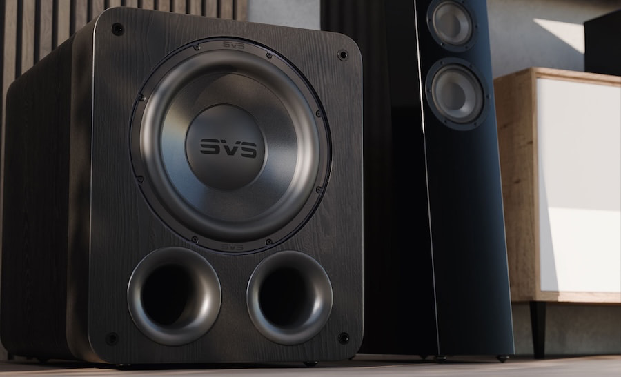

The $1,799 SVS PB-3000 R|Evolution is the obvious performance rival. It uses a 13-inch driver, a 1,200-watt continuous amplifier and a large ported enclosure rated down to 16Hz in standard mode. It also provides app-based control, DSP tuning and automatic calibration.
For home theater buyers prioritizing maximum extension and output, the SVS has the stronger specification sheet. The Emotiva counters with genuine walnut, speaker-level inputs, balanced connectivity and a cabinet that does not look like it was delivered by the commercial refrigeration department.
