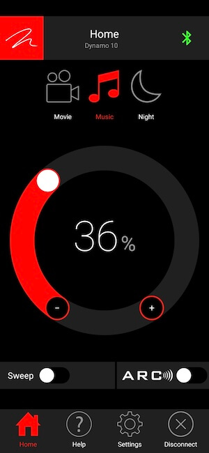

Once connected, the main page displays the three operating modes at the top: Movie, Music, and Night, followed by a volume dial with a proportional horseshoe around a central percentage display. Just below are Sweep and ARC buttons—though the ARC button stays inert until a room correction profile is uploaded. At the bottom, you’ll find Home, Help, Settings, and Disconnect.

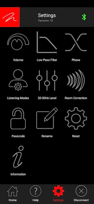

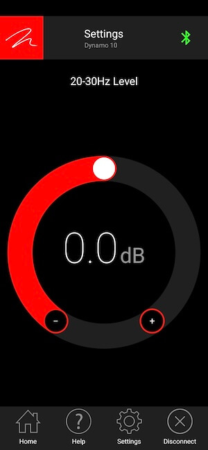

The Settings menu is where the magic happens. Here you can adjust the low-pass filter (3rd or 4th order) anywhere from 35–120 Hz. Phase correction runs 0–180º with the horseshoe dial and numeric display, plus an invert phase option. For those chasing extra subsonic thrill, the 20–30 Hz range can be independently boosted or cut ±10 dB. There’s even a passcode option to keep unwanted phones from hijacking your bass, and a reset function to restore factory settings—which also clears any ARC profiles, perfect if you’re relocating or just want a clean slate.
