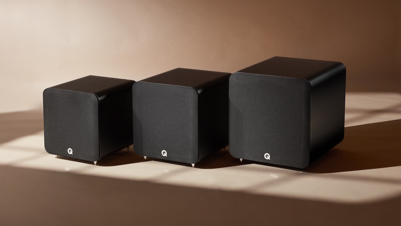

Q Acoustics Q SUB Subwoofer Series in Satin Black
Q Acoustics has spent the past two years updating its lineup with the award-winning 5000 series and brand new 3000c series, and the market has responded with great enthusiasm. The Q Acoustics M40 earned our “Editor’s Choice” Award in the best wireless speaker category, and there’s no question that it could be the foundation for a high-value 2.1 system for those who have space challenges. The one thing missing from that is a high-quality subwoofer to fill in the bottom range. The Q Acoustics lineup has been slightly thin in that regard, but all of that changes with the new Q Acoustics Q SUB Series.
The Q SUB lineup consists of three interrelated models: the 8-inch Q SUB80, the 10-inch Q SUB100, and the flagship 12-inch Q SUB120.
