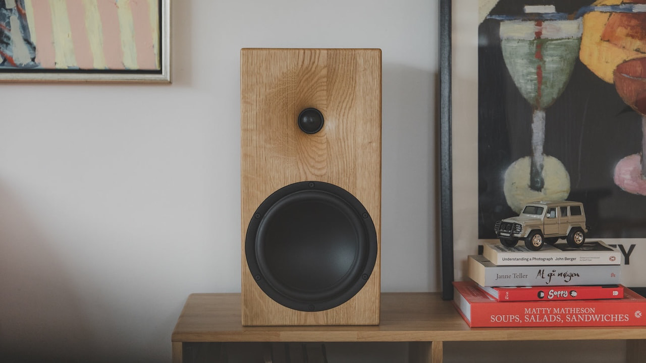

Buchardt E50S Passive Bookshelf / Stand-mount Speaker Lifestyle in Natural Oak

The E50-S (the “S” stands for sensitivity) is slightly larger than the original E50. Its width has been increased by 1 cm (0.4 inches) to accommodate a larger woofer. The new driver is a custom-made 7.5-inch Satori woofer that uses the well-regarded TeXtreme cone material, manufactured by Oxeon AB in Sweden.
In addition to the larger woofer, the E50-S employs a slightly different tweeter and a unique resistor-free crossover.
Another highlight is a custom-designed waveguide tailored specifically to the E50-S cabinet, tweeter, and woofer. Rather than casting the waveguide in aluminum, as Buchardt does with some of its other speakers, the E50-S waveguide is CNC-machined directly into the 28 mm solid-wood front baffle, combining craftsmanship with acoustic precision.

Despite the larger woofer, the E50-S delivers slightly less overall bass output, placing greater emphasis on the midrange. Buchardt says this gives vocals greater presence and creates a more textured presentation, allowing the midrange to occupy a more prominent position in the mix.
The high frequencies remain airy and highly detailed, but are tuned to sound smooth and non-fatiguing. Because treble performance has been one of the most praised aspects of the original E50, Buchardt has retained much of the same overall high-frequency character with the E50-S.
Buchardt also describes the E50-S soundstage as more detailed, clear, and engaging than that of the E50. The presentation is more forward, with greater perceived air around instruments and a stronger emphasis on bringing vocals closer to the listener.
Compared with the E50, the E50-S is intended to sound more energetic, holographic, and responsive, with greater apparent detail and more precise imaging without becoming analytical or cold. The original E50, by comparison, offers a more relaxed and laid-back presentation, with what Buchardt describes as an easygoing “paper-cone” tonal character.
