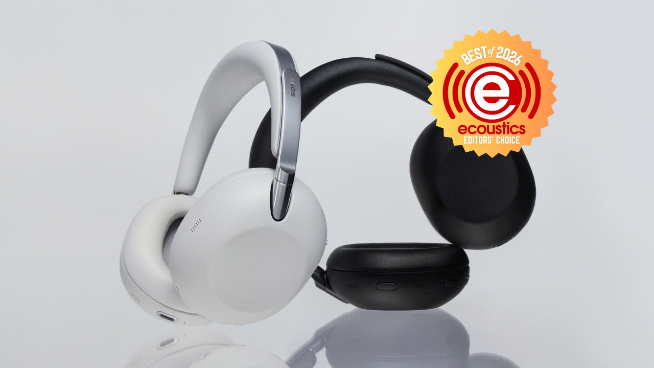

sony-1000x-wireless-headphones-white-black
Sony 1000X THE COLLEXION wireless headphones are available in white or black.
