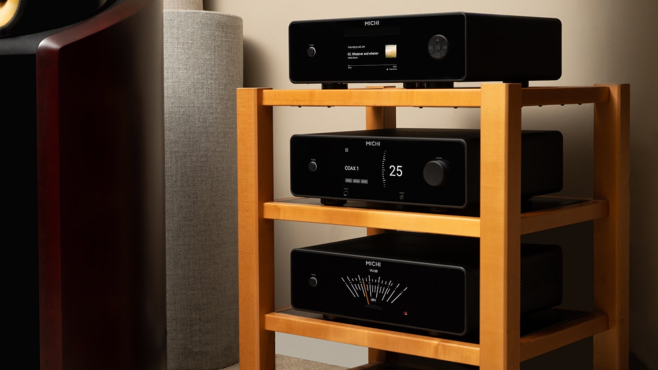

Michi Q430, P430, and S430 Lifestyle
As Rotel’s flagship sub-brand, Michi dates back to 1993, although the name disappeared for many years before being revived in 2019. In 2026, the Prestige Series is giving Michi another significant push into the high-end audio market.
Following the 2026 introductions of the Q430 CD Player and X430 Integrated Amplifier, Michi is expanding the Prestige lineup with two additional models: the P430 Stereo Preamplifier and S430 Stereo Power Amplifier. Let’s take a closer look at what they bring to the table.
The Michi Prestige Series is intended to bring much of the brand’s high-end engineering philosophy to a broader audience, drawing on technologies and design principles established in the more expensive Michi Reference Series.
The P430 and S430 are aimed at listeners who prefer a separate preamplifier and power amplifier rather than an integrated solution, offering greater system flexibility, component isolation, and upgrade potential within the Michi Prestige lineup.

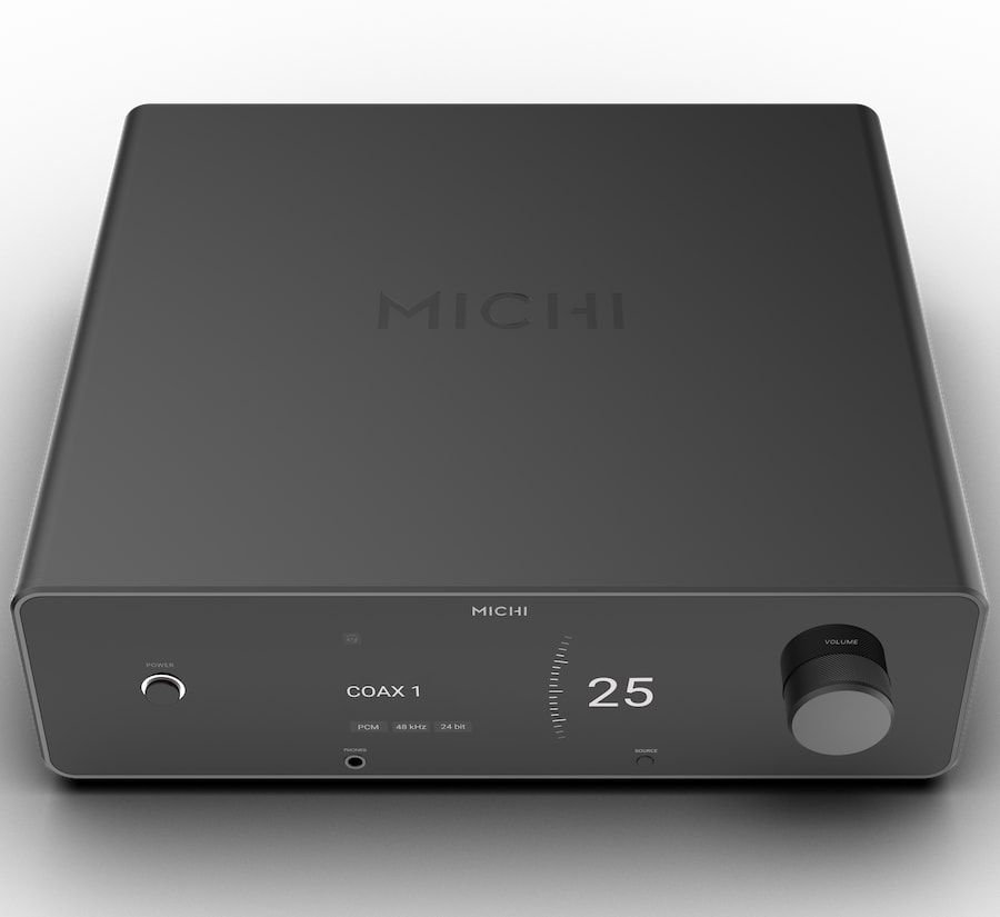

Michi Prestige P430 Pre-amplifier
michi-p430-top-front
Through a balanced architecture, multi-stage low-noise power regulation, and carefully managed grounding, the P430 pre-amplifier is engineered to preserve signal integrity while maintaining transparency, detail, timing accuracy, and precise soundstage reproduction.
At its digital core, the P430 uses an ESS SABRE ES9028PRO 8-channel DAC, combined with advanced clocking and jitter control to improve linearity and musical coherence.

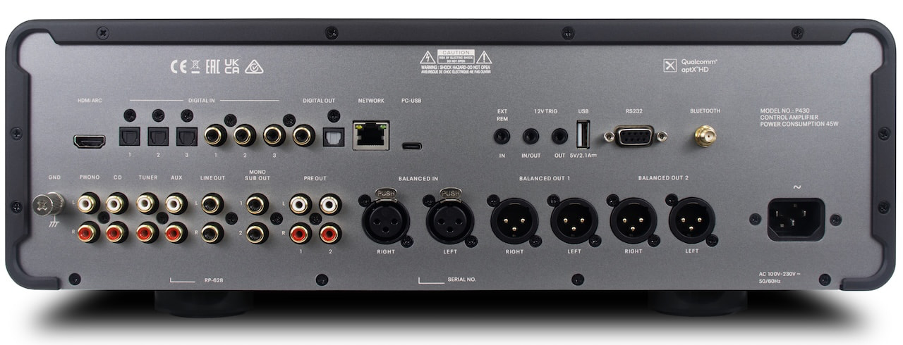

The P430 also offers extensive connectivity. Digital inputs include three coaxial and three optical inputs, PC-USB with DSD256 support, Roon Tested certification, wireless Bluetooth with aptX HD and AAC, and HDMI ARC. Analog connectivity includes one balanced XLR input, three RCA line-level inputs, and an MM phono input.
For system expansion and installation flexibility, dual balanced XLR outputs, dual RCA outputs, and a line-level output allow the P430 to be used in conventional preamp/power amp systems or more ambitious bi-amp configurations. Coaxial and optical digital outputs enable connection to downstream digital components, while dual mono subwoofer outputs provide additional flexibility for integrating low-frequency reproduction.
michi-p430-back

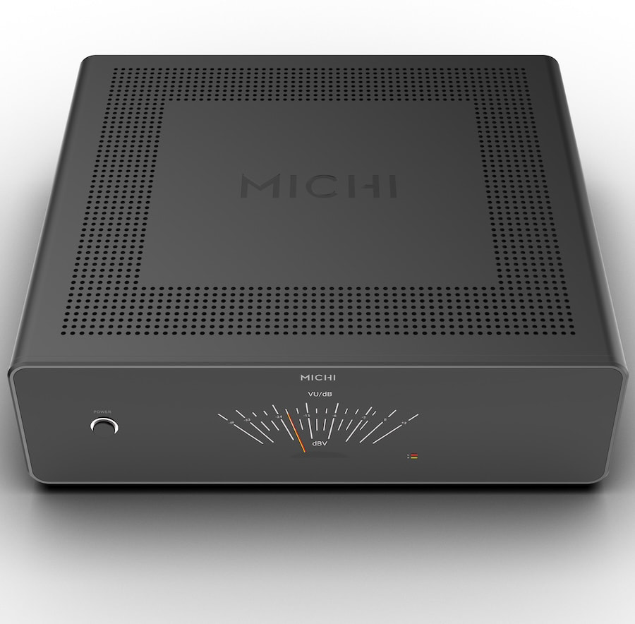

Michi Prestige S430 Stereo Power Amplifier
michi-s430-top-front

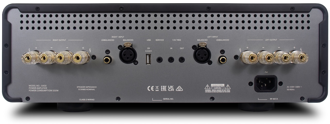

Designed to complement the P430, the S430 Stereo Power Amplifier delivers 390 watts per channel into 4 ohms and 230 watts per channel into 8 ohms. Its combination of substantial output and high-current capability is intended to drive a wide range of loudspeakers, including more demanding designs.
At the heart of the S430 is an in-house-designed oversized toroidal transformer, complemented by high-capacitance energy storage and comprehensive protection circuitry. Balanced XLR and unbalanced RCA inputs are provided, along with 5-way binding posts for connecting loudspeakers.
For system integration, the S430 includes a 12V trigger and automatic power-off functionality. A front-panel TFT display offers selectable VU meter and spectrum analyzer views, giving the amplifier some visual theater without turning it into a light show.

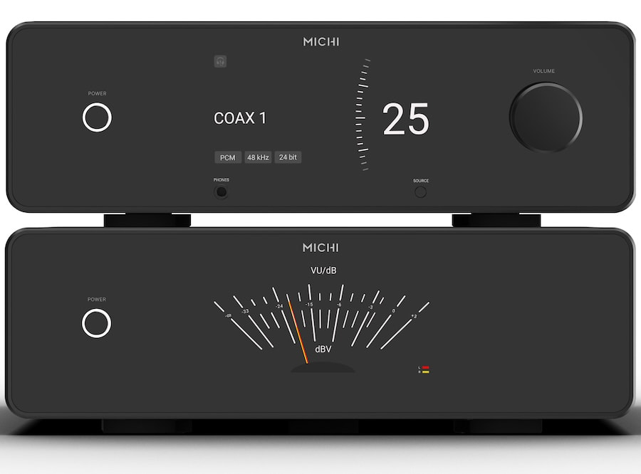

Together, the P430 and S430 provide a new separates-based entry point into Michi performance within the Prestige Series. The combination offers buyers who do not want an integrated amplifier greater system flexibility, substantial power, and a clearer upgrade path while retaining the design and engineering approach established across the Michi lineup.

Michi P430 Preamp atop  S430 Power Amplifier
Michi P430 Preamp (top) and S430 Power Amplifier (bottom)
