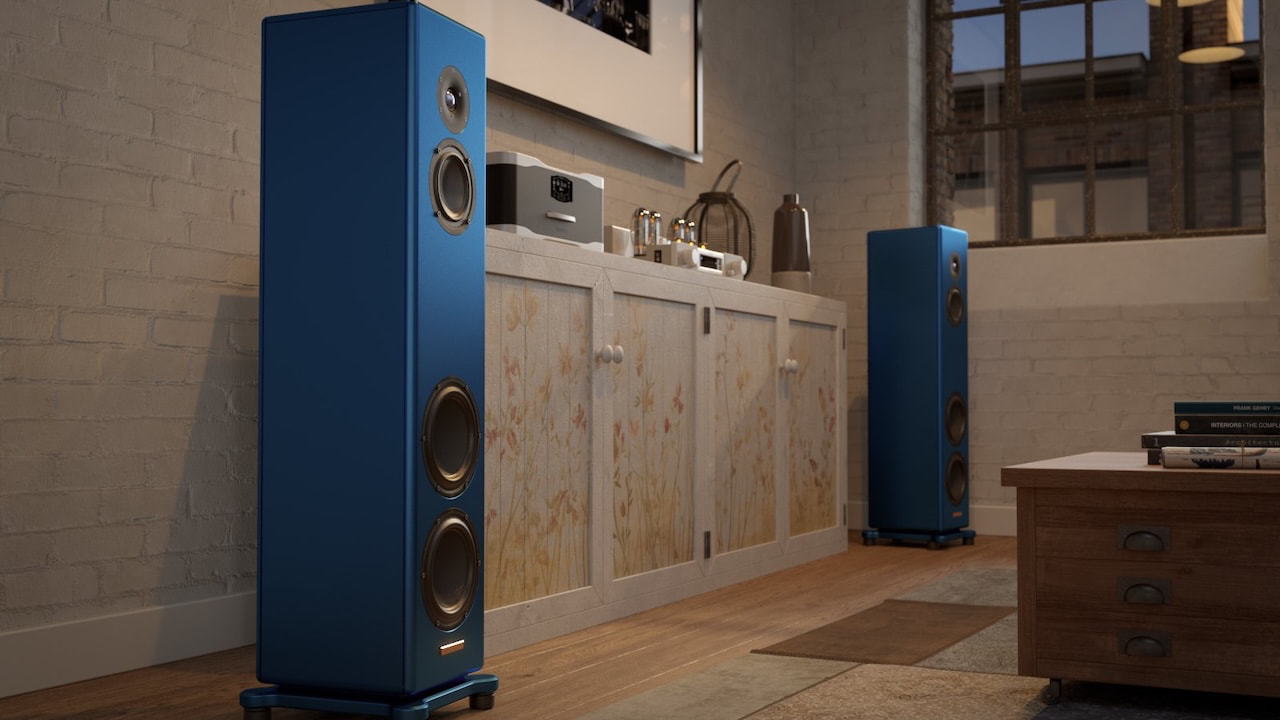

The A3 brought Magico’s aluminum cabinet construction, beryllium tweeter technology, advanced drivers, and sealed-box design into a floorstander that was still expensive, but considerably more attainable than most of the company’s lineup. Magico itself described the original A3 as an entry point intended to reach a wider audience.
Nine years later, Magico has completely redesigned it.
The new Magico A3 2027 retains the familiar three-way, four-driver configuration, but the enclosure, drivers, and crossover are all new. Development also employed measurement tools originally used for the flagship M9, including laser vibrometry and near-field scanning.

The original A3 used a 6-inch Graphene Nano-Tec midrange driver and two 7-inch Graphene Nano-Tec woofers. The A3 2027 moves to a new 5-inch midrange and two redesigned 7-inch woofers using aluminum-honeycomb cores sandwiched between carbon-fiber skins.
The new midrange and woofers also use pure titanium voice coils, copper shorting rings, and redesigned motor systems intended to stabilize the magnetic field and reduce eddy currents.

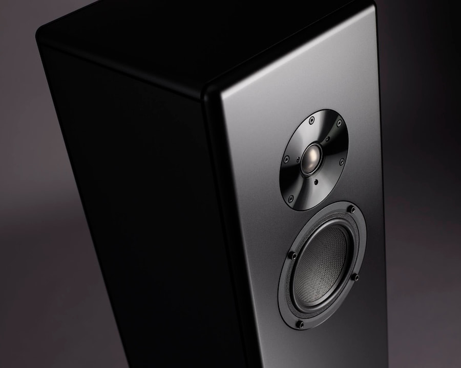

magico-a3-2027-loudspeaker-black-top
Magico A3 2027
Up top is a new 28mm pure-beryllium dome tweeter with revised diaphragm geometry, a neodymium motor system, greater linear voice-coil travel, and a redesigned rear chamber.
The original A3 also used beryllium, so the material itself is not new, but the driver most certainly is.

The enclosure has received an equally serious rethink.
Magico used a laser vibrometer to identify cabinet-panel resonances and determine where bracing and damping would have the greatest effect. A Near-Field Scanner was used to map acoustic output around the loudspeaker rather than relying exclusively on conventional on-axis measurements. Those tools were also employed during development of the considerably more ambitious M9.
The A3 2027 enclosure incorporates constrained-layer damping, revised internal bracing, radiused vertical edges, a newly machined base, and model-specific footers. The aluminum panels are bead-blasted and anodized, with Black, Silver, Red, and Blue finishes.
