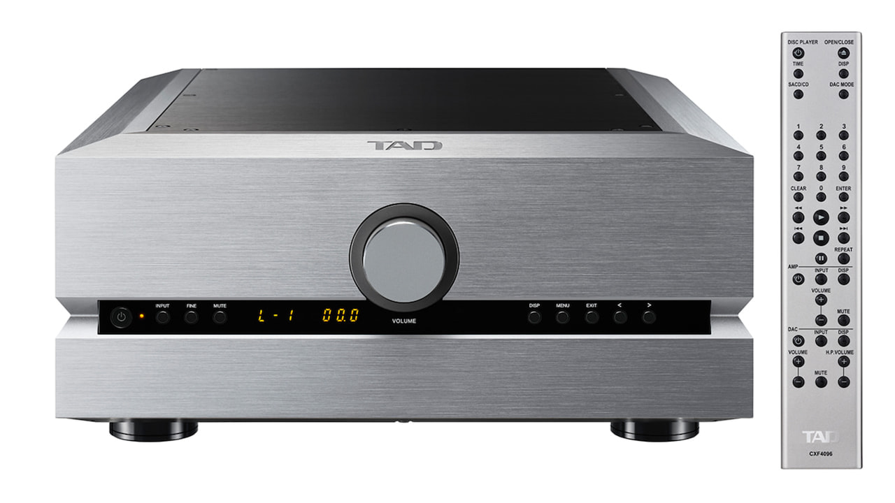

Its new TAD-A1000D Evolution Series integrated amplifier starts with the analog architecture of the A1000, TAD’s first integrated amplifier introduced globally in 2025, and adds a serious digital front end capable of PCM up to 384kHz and DSD256 over USB. The digital section incorporates technology developed for considerably more expensive TAD Reference Series components, including the third-generation UPCG master clock first developed for the D700 CD/SACD player.
There is no network streaming platform hiding inside. TAD’s published connectivity consists of analog inputs plus balanced digital, coaxial, optical and USB connections. If you want Qobuz, TIDAL, Spotify or your Roon library, bring the network streamer of your choice.

The original TAD-A1000 was significant because it represented the company’s first integrated amplifier. TAD had spent years building separate preamplifiers, power amplifiers, DACs and disc players across its Evolution and Reference ranges before deciding that combining amplification functions inside one chassis did not constitute an audiophile misdemeanor.
The A1000D goes one step further.
TAD retains the core analog amplification platform, including a bridge-tied load architecture that operates in a balanced configuration from input through output. Positive and negative signal paths are arranged symmetrically, while transformer coils and the associated rectification, smoothing and stabilization circuits are separated by channel.
Power output remains 250 watts into 4 ohms at 1kHz, and TAD continues to use a Class D output stage coupled to a substantial analog power supply rather than treating Class D as an excuse to make the amplifier the size and weight of a paperback.
At 64 pounds, nobody is confusing it with a WiiM Amp.
The more important changes happen before the signal reaches that amplification stage.

We covered the TAD D700 Reference Series CD/SACD player when it appeared in 2023, and one of its more interesting technologies was TAD’s third-generation UPCG, or Ultra-High-Precision Crystal Generator.
Rather than concentrating solely on absolute clock accuracy, TAD focuses on the carrier-to-noise performance of the oscillator and reducing phase noise around its center frequency. The third-generation design uses an SC-cut crystal and was developed to maintain high C/N performance while reducing sensitivity to temperature changes.
The A1000D inherits that third-generation UPCG.
That is a considerably more interesting engineering decision than announcing which off-the-shelf DAC chip sits inside and expecting audiophiles to immediately choose sides in another ESS-versus-AKM cage match.
USB Without the Usual Timing Problems
The USB implementation is also proprietary. TAD uses an asynchronous USB transfer circuit designed to reduce operating delays inside the FPGA and minimize low-level distortion. Combined with the UPCG master clock, the USB input supports PCM at sampling rates up to 384kHz and DSD256 at 11.2MHz.
Balanced and coaxial digital inputs support PCM up to 192kHz, while optical tops out at 96kHz.
The DAC section then feeds a proprietary current-feedback I/V converter. TAD says the circuit feeds current from the D/A converters directly without altering it, reducing impedance while improving noise resistance before the signal reaches the analog preamplifier.
This is where the A1000D begins to separate itself from integrated amplifiers that simply add a competent DAC for convenience. TAD is attempting to treat the digital input stage as another high-end source component within the amplifier rather than an accessory.

The preamplifier section also contains some familiar TAD thinking.
Its single-stage current-feedback flat amplifier was originally developed for Reference Series preamplifiers. TAD individually evaluates FET characteristics and matches positive and negative devices to improve circuit complementarity and stability. Volume control is handled through TAD’s own switched ladder-resistor electronic attenuator, which is specified at less than 0.0005% distortion with a 1Vrms input
The large center-mounted volume control itself rides on precision ball bearings.

Adding digital circuitry also required TAD to rethink internal isolation.
The A1000 divided its major circuitry into four physical chambers. The A1000D moves to five, separately housing the preamplifier, power amplifier, transformer, control circuitry and digital input section.
The digital stage also receives its own grounding point, separate from those used by the preamplification and power amplification sections.
TAD uses four custom 33,000µF smoothing capacitors in the power stage, along with nonmagnetic capacitors, resistors and specialized gold-plated oxygen-free copper leads in critical analog signal paths.
Three feet incorporating internally inverted spikes support the chassis, while large speaker terminals derived from TAD’s Reference Series power amplifiers handle the connection at the other end.
