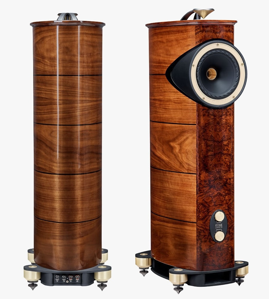

The biggest change is sitting in the middle of the familiar 250mm (10-inch) IsoFlare driver.
Fyne’s point-source architecture positions the high-frequency compression driver at the acoustic center of the bass/midrange cone, allowing the two to behave more like a single source. We have seen variations of that technology across Fyne’s lineup, from the affordable F500 Series through the enormous F704SP we covered at High End Munich 2025.
The F1-10 Anniversary takes it somewhere new.
Instead of the 75mm titanium dome compression tweeter used by the current F1-10S, the Anniversary employs a 75mm ultra-thin aluminosilicate glass diaphragm that has been chemically strengthened using an ion-treatment process. Fyne claims the material offers up to seven times the resonance damping of typical metal domes while retaining sufficient rigidity and low mass for high-frequency reproduction.
More interestingly, the compression driver crosses over at just 750Hz.
That means the glass diaphragm isn’t merely handling the top octave where audiophiles argue about things their dogs can hear better anyway. It reaches down into a region that has considerable influence on vocals and instrumental timbre.
Fyne also developed a new computer-optimized annular waveguide for the driver to control dispersion while maintaining the IsoFlare’s point-source behaviour.

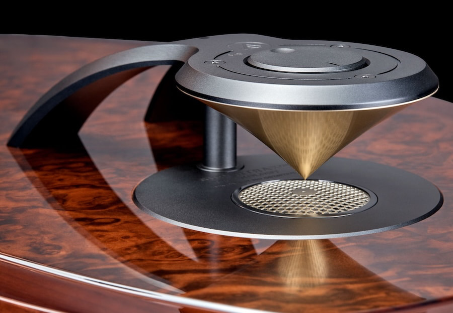

We’ve covered Fyne’s SuperTrax technology before. Introduced in 2024 as an external add-on super tweeter, it uses a 25mm Thin Ply Carbon Diaphragm driver firing vertically into a Tractrix-profile diffuser to create 360-degree high-frequency dispersion.
The F1-10 Anniversary is the first Fyne loudspeaker to incorporate the system directly into the cabinet.
The integrated SuperTrax comes in at 16kHz and extends the loudspeaker’s specified response to 60kHz. Its output can also be adjusted by ±3dB, joining separate ±3dB controls for overall high-frequency energy and the 2.5kHz to 5kHz presence region.
Nobody is listening to a 50kHz test tone over breakfast. The point is bandwidth, phase behavior and dispersion around the upper limit of the main driver, with Fyne claiming improvements in spatial information and perceived openness within the audible range.
That is also what makes the Anniversary considerably more interesting than bolting an external super tweeter onto the existing F1-10S.

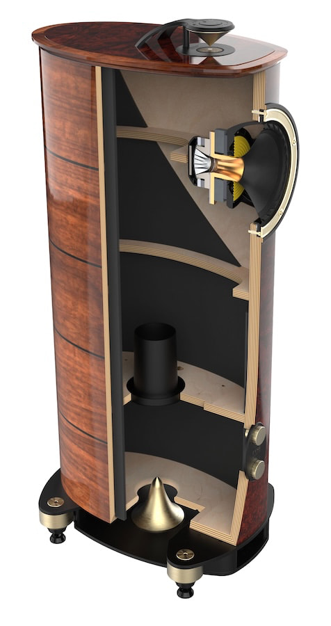

Fyne developed a dedicated crossover using ClarityCap PUR polypropylene capacitors, low-loss laminated-core inductors and non-inductive thick-film resistors. Rather than putting everything on a conventional PCB, the components are hard-wired onto rigid fiberboard panels.
Bass duties still rely on one of Fyne’s more sensible pieces of engineering: the downward-firing BassTrax Tractrix diffuser.
The port fires onto a shaped diffuser in the plinth, distributing low-frequency energy through 360 degrees rather than firing it directly toward one wall or the listening position. The Anniversary also retains Fyne’s internal twin-cavity arrangement for controlling standing waves and behavior around the port tuning frequency.
That gives the F1-10 Anniversary a claimed in-room response of 26Hz to 60kHz at -6dB.
