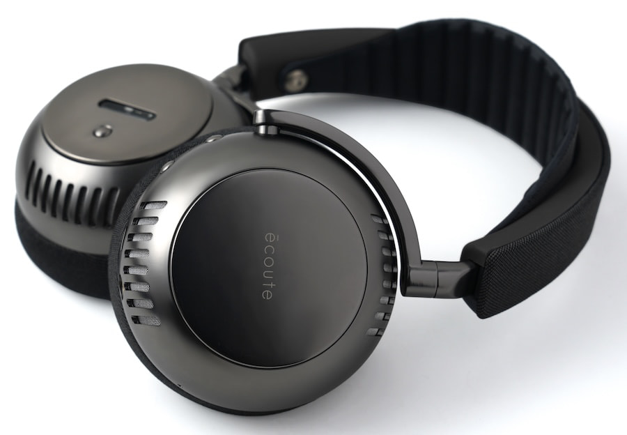

ecoute-th2-wireless-headphones-gunmetal
écoute TH2 in gunmetal
The tube stage uses a Korg Nutube 6P1 dual triode for voltage gain, supported by discrete Class A/B amplification per channel. This approach prioritizes harmonic structure, microdynamics, and spatial cues at the front of the signal chain, where they matter most, rather than attempting to reintroduce them later through processing.

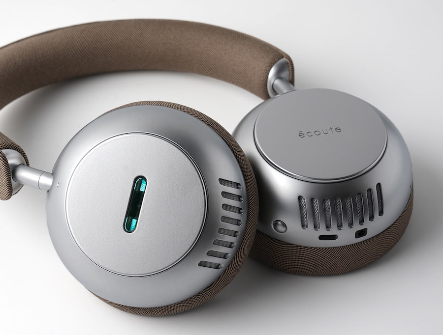

ecoute-th1-wireless-headphones
écoute TH1 (original model)

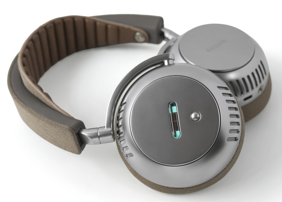

ecoute-th2-wireless-headphones-nickel
écoute TH2 in nickel (new headband, side button, and gimbal)
