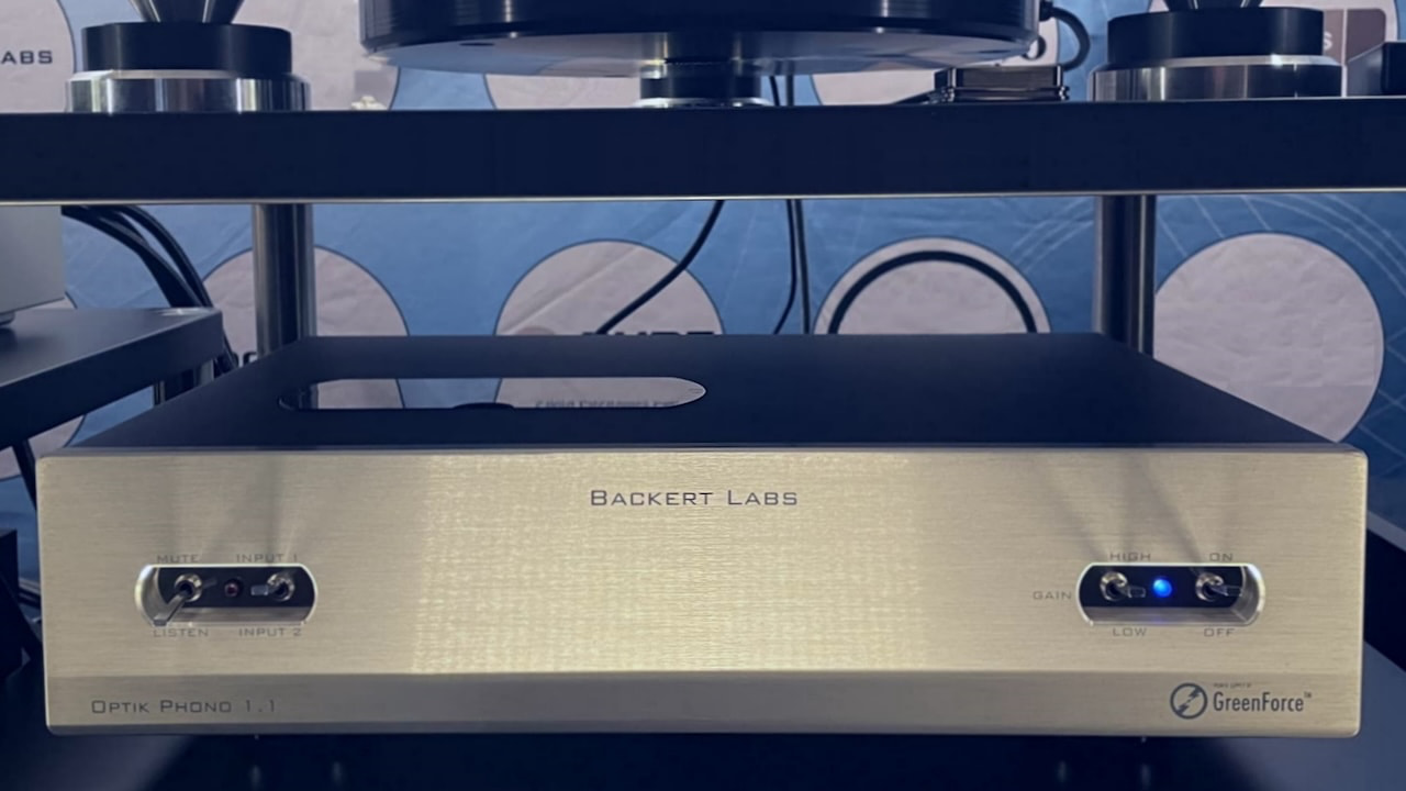

Priced at $11,500, the new Optik Phono 1.1 from Backert Labs makes its intentions clear immediately: this is unapologetically high-end, highly specialized hardware built for owners of DS Audio optical cartridges who want flexibility without compromise. Using a pair of 12AU7 tubes and designed specifically as an optical-cartridge equalizer rather than a conventional phono stage, the Optik Phono 1.1 breaks new ground by offering two independent tonearm inputs—a first in this category.
That dual-input design isn’t a gimmick. It allows listeners to switch instantly between two DS Audio cartridges from the front panel, whether that’s stereo and mono, or two different stereo models, without juggling cables or buying multiple equalizers. For serious analog systems running multiple arms, this is a practical, if decidedly premium, solution—and one that reinforces just how niche and uncompromising the DS Audio ecosystem has become.

The Optik Phono 1.1 from Backert Labs is unapologetically specialized hardware, and its internal design reflects that focus. This is not a conventional phono preamplifier, nor is it intended to be flexible across cartridge types. Like all optical equalizers, it is DS Audio–only, engineered specifically around the requirements of optical cartridges and their photo-detector architecture.
Front-panel operation is straightforward and functional. Alongside the Input 1 / Input 2 selector, which allows switching between two tonearms or cartridges, Backert includes a high/low gain switch for proper system matching and a mute switch for safe cartridge changes or system adjustments. The Optik Phono also automatically shuts down the internal LED and decorative external illumination for whichever cartridge is not in use, reducing unnecessary wear and extending LED lifespan.
optik-phono-1-1-switches
Internally, the gain stage is designed around longevity and consistency rather than tube rolling theatrics. The circuit incorporates multiple design measures intended to extend tube life, effectively treating the pair of 12AU7 tubes as long-term components rather than consumables. Backert’s automatic tube biasing circuit, unusual in a phono-stage context, ensures that each tube operates at its optimal point without manual adjustment, maintaining stable performance over time.
Signal output is available via both balanced XLR and single-ended RCA connections. Power delivery is handled by a dual-mono architecture using two of Backert’s patented power supplies dedicated to the audio signal path, built around PTFE capacitors chosen for speed and stability. A separate patented power supply is used exclusively for the DS Audio photo-detector, employing premium oil-damped ODAM capacitors to maintain consistent illumination and signal conversion.
Attention to materials is evident throughout the design. Solid silver wiring is used in selected locations, while mechanical isolation is handled by IsoAcoustics Gaia feet. The circuit board is supported by a thick, deliberately unfinished solid brass bottom plate, chosen for mechanical stability and resonance control rather than cosmetic effect.
Physically, the Optik Phono is substantial and intentionally understated. It features a heavy, silver anodized aluminum front panel, with black offered as a no-cost alternative. The chassis itself is finished in black as standard, with optional color finishes available for an additional $300.
