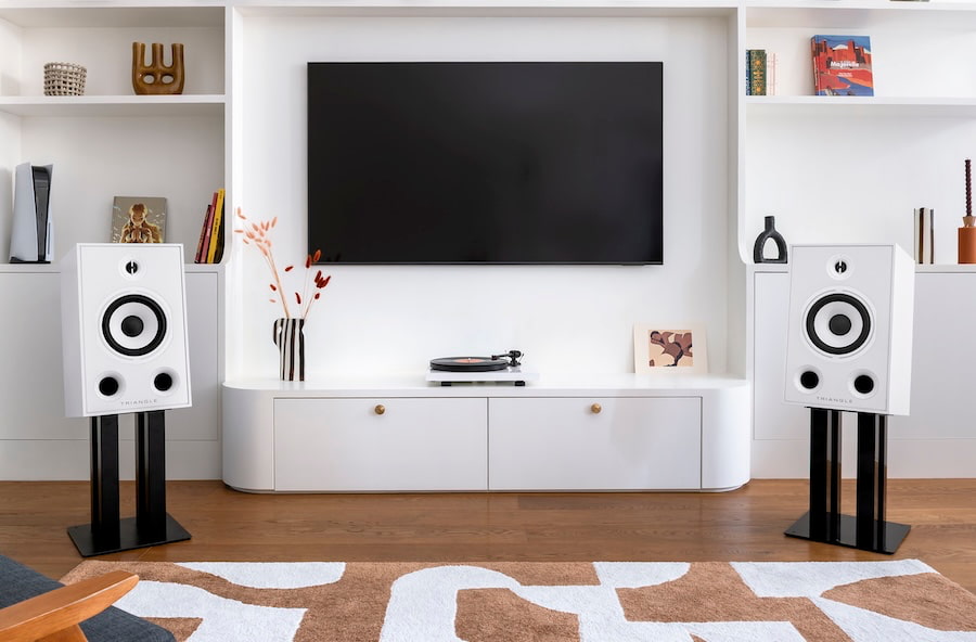

The BR05 pairs a wood-toned cabinet with solid-color front panels and matching driver surrounds, creating a warm, contemporary two-tone appearance. Light Oak and Black Ash are joined by three additional finishes: Chestnut, Green, and Frosted White. Removable magnetic grilles let owners choose their preferred look.
A supplied base tilts the speaker back by 8° toward the listener to improve soundstage coherence while maintaining a discreet visual footprint. Alternatively, the optional S03 stands, available in Black or White, raise the BR05 to listening height. The 8° tilt is maintained in both configurations.

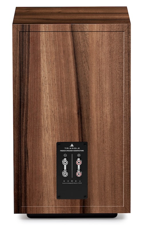

To integrate the tweeter and midwoofer, the BR05 uses a second-order crossover operating at 1.7 kHz with a 12 dB/octave slope. The crossover incorporates large-gauge air-core inductors, polyester film capacitors, and cement resistors, with high-purity oxygen-free copper (OFC) wiring, to promote a transparent, phase-coherent response. Bi-wire and bi-amp-compatible binding posts provide additional flexibility for system configuration.

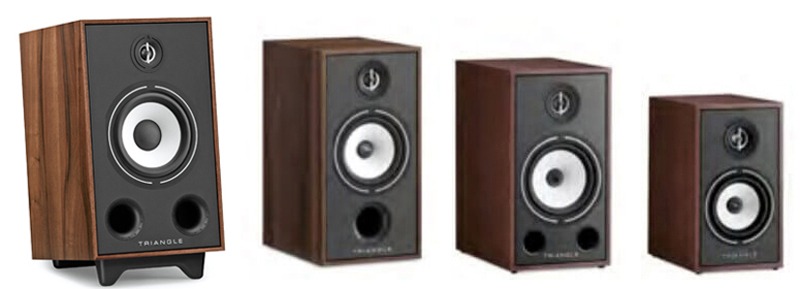

Triangle ModelBorea BR05  (2026)Borea BR04 (2025)Borea BR03 (2019)Borea BR02 (2019)
Product TypeBookshelf/Standmount SpeakerBookshelf/Standmount SpeakerBookshelf/Standmount SpeakerBookshelf/Standmount Speaker
Price (pair)$999$649$599$469
Speaker TypeTwo-Way, Bass ReflexTwo-Way, Bass ReflexTwo-Way, Bass ReflexTwo-Way, Bass Reflex
Tweeter1″ (25 mm) silk dome1″ (25) mm Silk dome 1″ (25 mm) Silk dome 1″ (25 mm) Silk dome
Midwoofer 8-inch (21 cm)6-inch (16 cm) 6-inch (16 cm)1 x 5-inch (13 cm)
Port2 Front1 Front 2 Front 1 Rear
Frequency Response (±3 dB)42 Hz – 22 kHz 44 Hz – 22 KHz 46 Hz – 22 kHz 51 Hz – 22 kHz
Sensitivity (dB/W/m)90 dB 90 dB 90 dB 89 dB
Power Handling (W RMS)120 W110 W 260 W 80 W
Impedance (min/nominal) 4.7 / 8 Ω 4.4 Ω / 8 Ω 4.2 Ω / 8 Ω 4.2 Ω / 8 Ω
Crossover Frequency1700Hz3200Hz 3600Hz 2500Hz
Bi-Amp / Bi – Wire Compatible YesYes– –
Optimal Room Size (square feet)160 to 485107 to 430 160 to 320215
Dimensions (WHD) 12 x 19.3 x 13.58 in
300 × 490 × 345 mm
8.6 x 16.7 x 12.3 inches
220 x 425 x 314 mm
8.11 x 15 x 12.36 inches
206 x 380 x 314 mm
6.93 x 12.2 x 10.8 inches
176 x 310 x 274 mm
Net Weight 14.6 kg / 32 lbs 3 oz8.6 kg / 18.95 lbs 6.3 kg / 13.9 lbs 4.9 kg / 10.8 lbs
