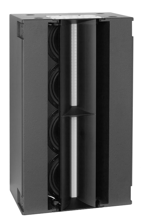

The 11.8.6-channel system will be anchored by three Alcons CRMSQ pro-ribbon line-source arrays, handling the left, center, and right screen channels.
alcons-crmsq-front
CRMSQ

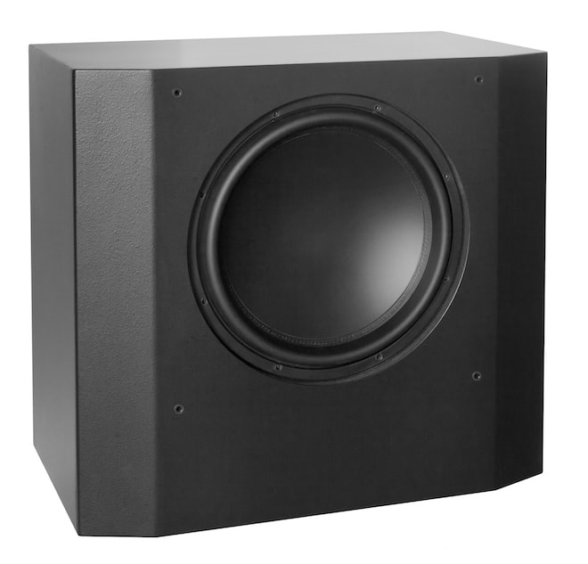

Each screen channel combines two CRMSQ modules with one CRMSQB low-frequency extension module. Alcons says the modular configuration is designed to deliver high output, controlled directivity, low distortion, wide dynamic range, and high speech intelligibility.
alcons-crmsqb-front
CRMSQB

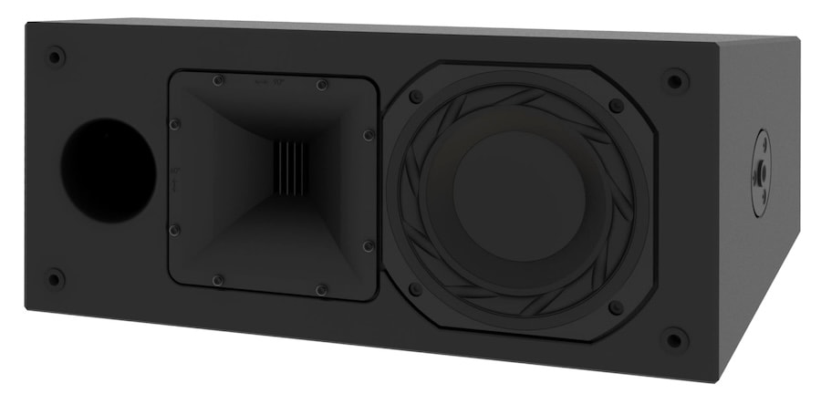

Supporting the front channels, Alcons is bringing fourteen CRMSC-SRHV compact pro-ribbon reference surrounds. Using the same core mid/high-frequency transducer technology as the front channels, ensuring seamless tonal matching and a coherent immersive soundfield.
alcons-crmsc-srhv
CRMSC-SRHV

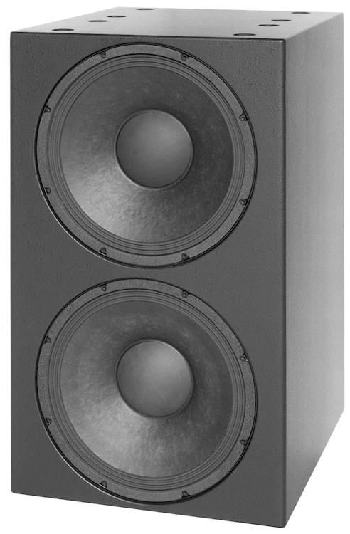

For bass, the system includes eight Alcons CRMS-LFE18 large-format 18-inch reference subwoofers. This subwoofer system will be combined with Trinnov’s advanced Double Bass Array processing (Waveforming). The subwoofer configuration is designed to deliver controlled low-frequency extension to below 10 Hz to support consistent performance across every seating position.

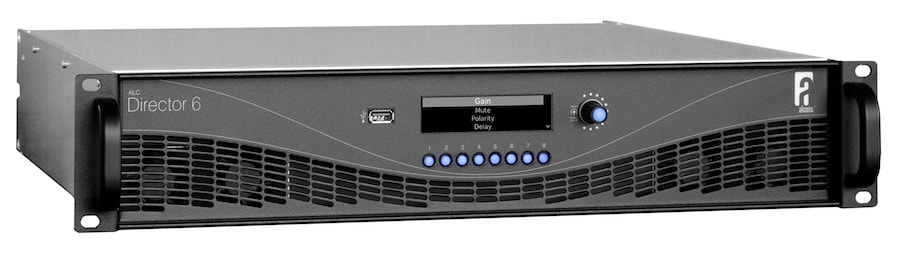

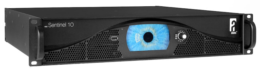

For amplification and system control, Alcons will use its Sentinel10 and Director6 amplified loudspeaker controllers to power and manage the complete 11.8.6-channel system. Alcons Integrity Sensing monitors the signal path and loudspeaker load to help maintain consistent performance, system protection, and reliability.
