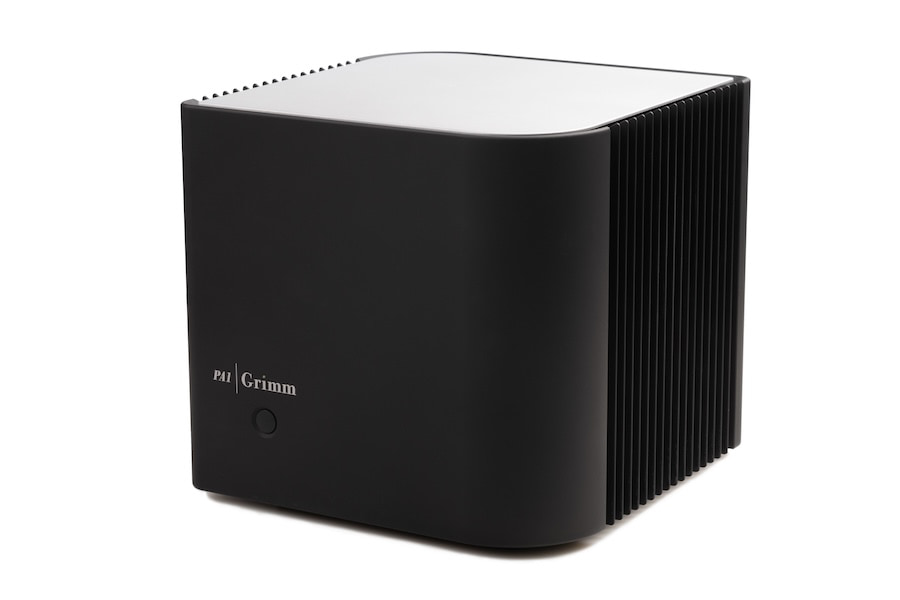

At 9.8 x 9.8 x 9.4 inches, the Grimm Audio PA1 is compact by monoblock amplifier standards, but its 33-pound weight makes it clear that this is not a lightweight design.
The PA1 is rated at 200 watts into 4 ohms and 150 watts into 8 ohms, delivering that output to a single channel. That gives Grimm Audio’s first power amplifier enough power for a wide range of demanding loudspeakers, while keeping the design focused on control, stability, and low distortion rather than unnecessary bulk.

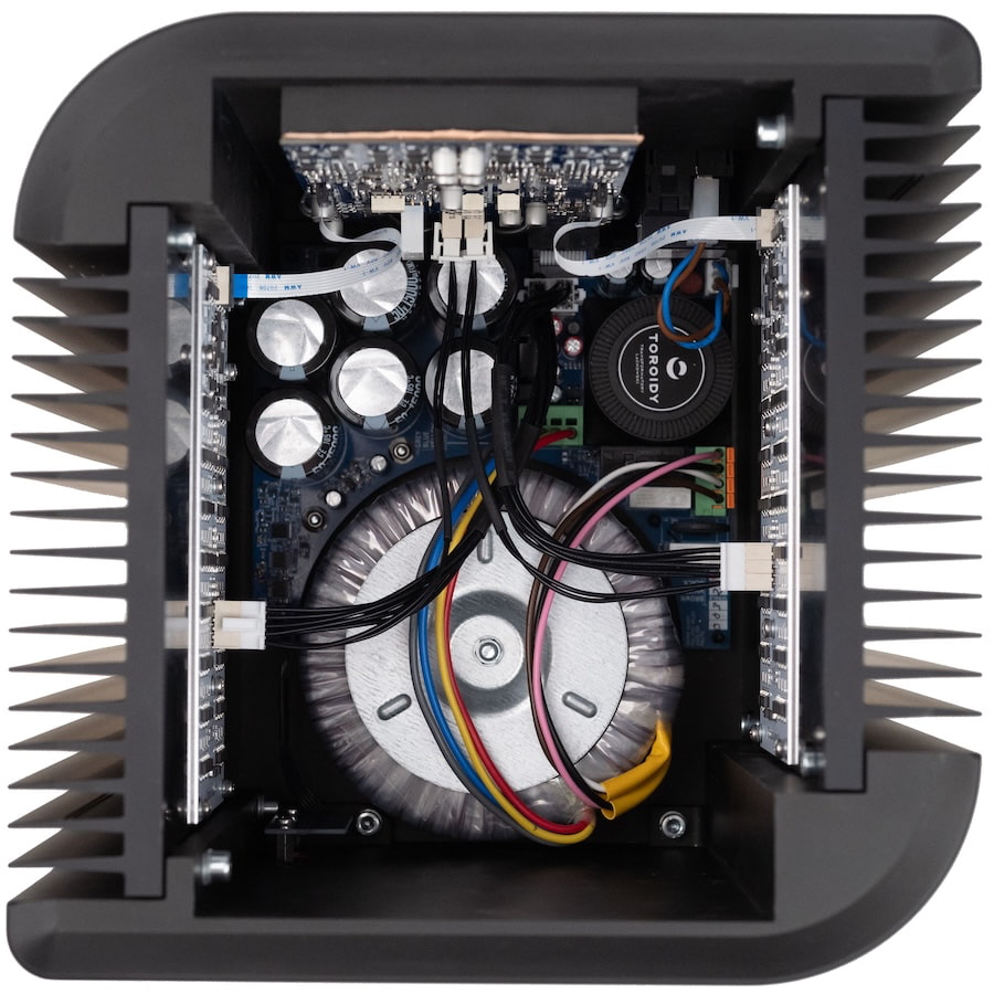

Grimm Audio says the PA1 uses a wide-bandwidth circuit architecture designed to reduce several forms of distortion, including phase modulation, thermal distortion, and residual crossover distortion. The amplifier also incorporates an Amplimo toroidal power transformer and a 90,000 µF current buffer, giving the compact chassis a more substantial power supply than its size might suggest.
Building on a traditional Class A/B amplifier topology, the PA1 uses symmetrical circuitry with 96 power transistors mounted on an aluminium printed circuit board. Grimm Audio says the aluminium PCB provides tight thermal coupling for the output devices, helping maintain stable operating conditions under load.
The output stage and driver stage are designed to work together to preserve the amplifier’s operating point, even when delivering substantial low-frequency current to a loudspeaker. That matters because bass demands can place significant stress on an amplifier’s power supply and output stage.
Although Grimm Audio describes the PA1 as combining some of the tonal qualities often associated with tube amplifiers with the control and stability expected from solid-state designs, the PA1 itself is a solid-state Class A/B monoblock amplifier. The company’s goal is clearly not nostalgia, but a compact amplifier that combines low distortion, current delivery, and thermal stability in a form factor that is smaller than many high-end monoblocks.
grimm-audio-pa1-mono-amp-inside
