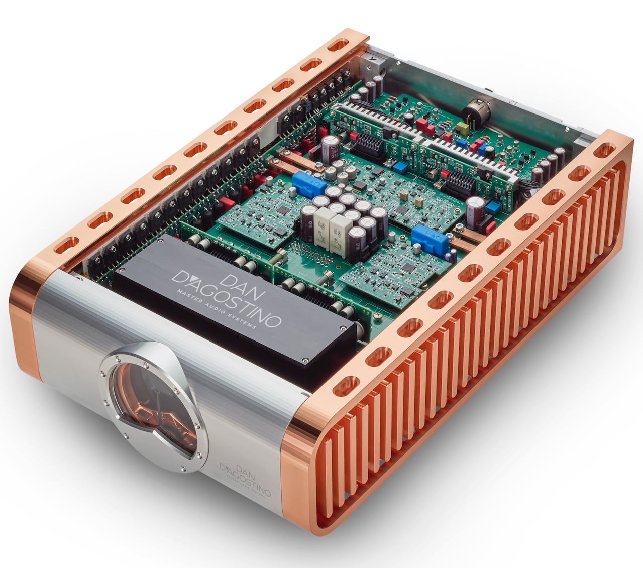

Inside the Momentum Z: Kinetic Drive Regulator and Power Architecture
dan-dagostino-momentum-z-internal
The Momentum Z generation represents a technical evolution of the Momentum platform, centered on a revised power architecture and updated circuit design. At the core is the Kinetic Drive Regulator, a proprietary power supply system designed to isolate the amplifier from AC mains fluctuations while reducing the influence of speaker load variations—two factors that can compromise the stability and consistency of conventional amplifier designs.
Beyond the power supply, the Momentum Z incorporates redesigned input stage topology and updated output stage circuitry, all overseen by a software-based control system that manages and optimizes each circuit group in real time. These changes are supported by a revised thermal management structure intended to improve long-term stability under sustained output. While we have not yet heard the Momentum Z, the design goals point toward improved control, lower noise, and more consistent performance across a wide range of operating conditions.

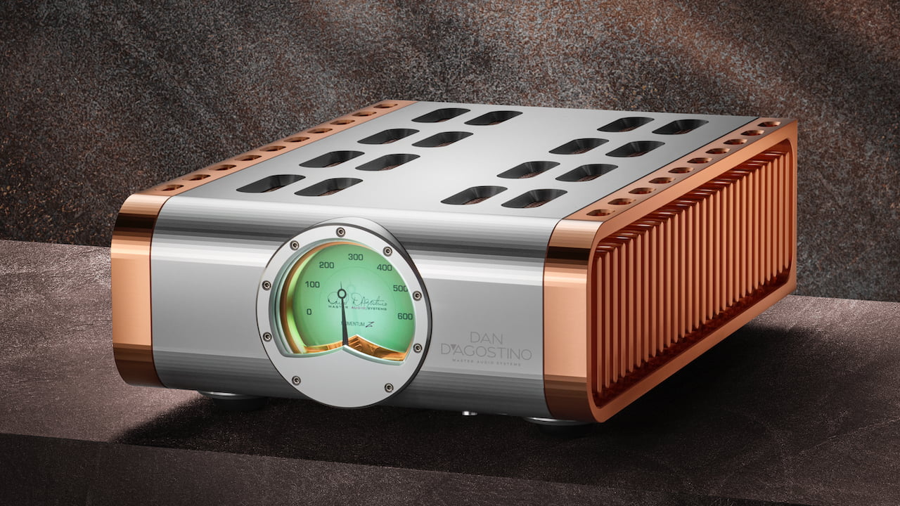

Design
The Momentum Z Monoblock Amplifier reflects Dan D’Agostino’s long-standing approach to amplifier design, where electrical performance and industrial design are treated as a single discipline. The sculpted chassis, machined from solid aluminum with copper elements, is engineered to provide structural rigidity, effective heat dissipation, and long-term thermal stability rather than serving a purely cosmetic role.
Every aspect of the enclosure is functional, from its mass and material choices to the way it supports the internal circuitry and power supply. The result is an amplifier whose physical design is directly tied to its electrical performance—deliberate, purposeful, and unmistakably aligned with D’Agostino’s design language.

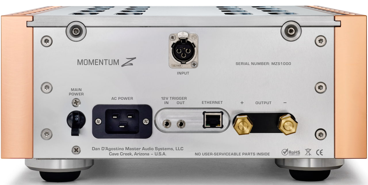

The Momentum Z is the first D’Agostino power amplifier to incorporate an Ethernet port, adding a layer of network-based monitoring not previously available in the lineup. This interface enables real-time access to key operational and performance parameters, providing visibility into system status and amplifier behavior during use.
Designed for both owners and service technicians, the Ethernet connection supports diagnostics, monitoring, and long-term system oversight, with the goal of maintaining consistent operation and reliability over time.

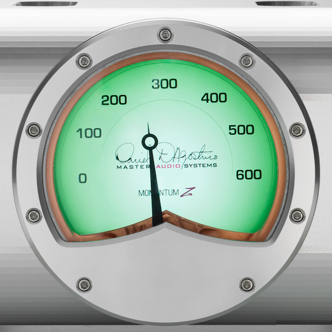

The Momentum Z incorporates D’Agostino’s Dual Domain Meter Display, a design approach shared across the company’s amplifier lineup. Rather than relying on a single measurement method, the system combines digital information display with an analog power indication.
dan-dagostino-momentum-z-meter
The digital domain replaces a traditional meter face with a 3.5-inch high-resolution LCD. This screen functions as both a power meter and a status display, providing operational information and system messages.
The analog domain is represented by the signature meter wand, which indicates output power in real time. This mechanical display remains a defining functional and visual element of D’Agostino power amplifiers, offering an at-a-glance representation of amplifier activity alongside the digital readout.
