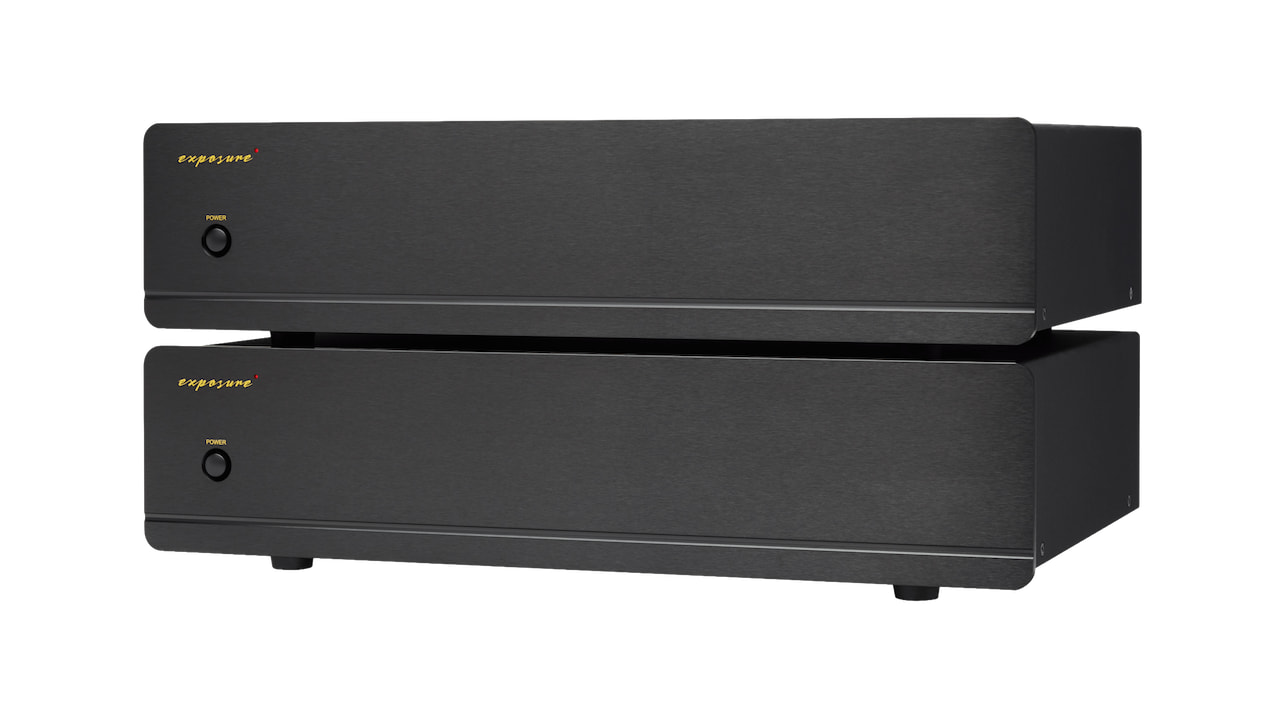

Exposure Electronics is taking a different route with its new 5510 Mono Power Amplifiers, completing a proper flagship separates system built around its 5510 Pre-Amplifier. Each monoblock delivers 200 watts into 8 ohms and 370 watts into 4 ohms, which should be enough to make a wide range of demanding loudspeakers sit up straight and behave themselves.
The new amplifiers are not trying to be lifestyle components. There is no streaming platform, touchscreen, HDMI input, or features list designed to impress someone who has not listened to a record since college. Exposure is betting that buyers at this level want power, low noise, strong channel separation, and a signal path that does not resemble an airport security line at Heathrow.

Each 5510 Mono uses a large custom toroidal transformer, screw-terminal smoothing capacitors, a fully bipolar transistor circuit, and a fully DC-coupled topology. That last part matters because Exposure is clearly aiming for speed, grip, and control without inserting unnecessary clutter into the signal path.
exposure-5510-mono-amplifier-rear
Balanced XLR and unbalanced RCA inputs are provided, along with bi-wire loudspeaker outputs using shrouded 4mm terminals. The chassis is all aluminum, finished in black, and incorporates both non-invasive overload protection and thermal protection. In other words, these are serious amplifiers, but not the sort that require a structural engineer and a reinforced equipment rack.

Exposure 5510 Mono Power Amplifier Specifications
  • Type: Mono power amplifier
  • Power output: 200W into 8 ohms, 370W into 4 ohms
  • Circuit topology: Fully bipolar transistor design, fully DC-coupled
  • Power supply: Large custom toroidal transformer with screw-terminal smoothing capacitors
  • Inputs: Balanced XLR and unbalanced RCA
  • Input impedance: 75kΩ at 1kHz via unbalanced input
  • Frequency response: Down 3dB at 52kHz, referenced to 1kHz
  • THD: Less than 0.015% at 1kHz, 200W into 8 ohms
  • Signal-to-noise ratio: Greater than 120dB A-weighted, referenced to 200W into 8 ohms
  • Speaker outputs: Bi-wire compatible shrouded 4mm terminals
  • Protection: Non-invasive overload protection and thermal trip
  • Power consumption: Less than 800VA into an 8-ohm load
  • Dimensions: 440 x 115 x 300mm
  • Weight: 14kg each
  • Finish: Black
  • Warranty: Three years
  • Price: £7,300 per pair including VAT
