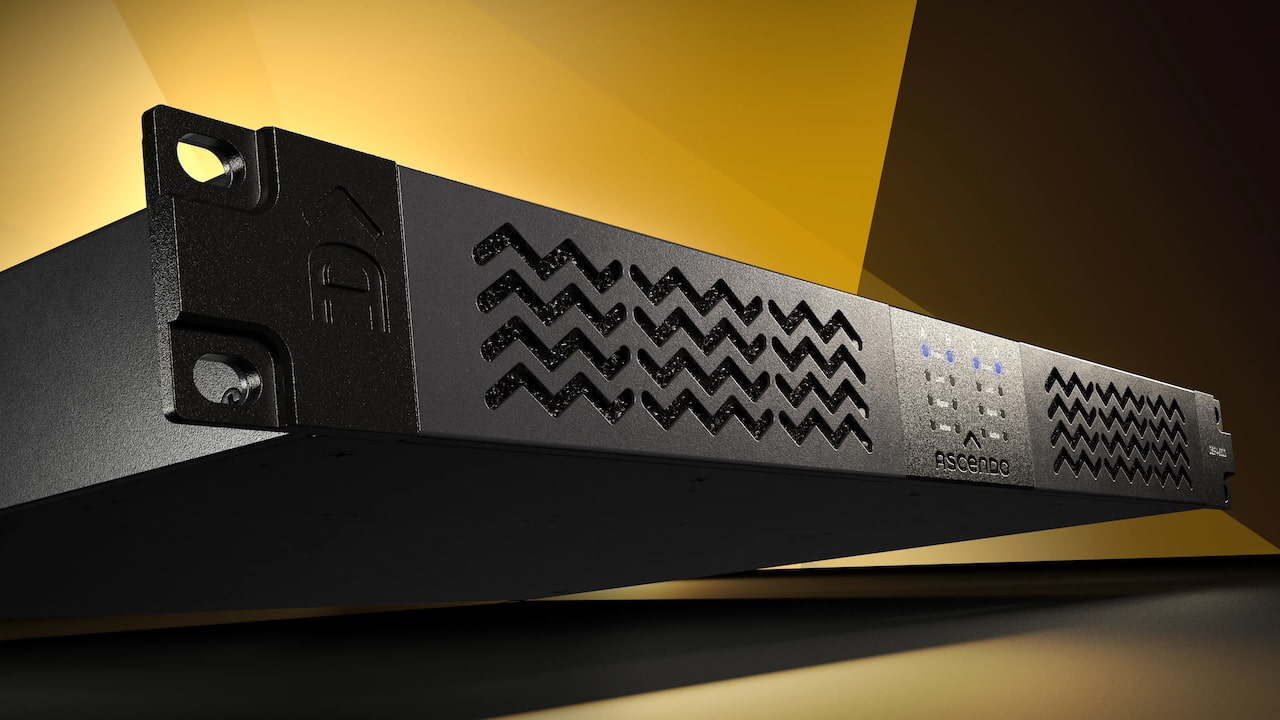

ASCENDO Immersive has built its reputation in the luxury home theater market around loudspeakers, subwoofers, amplifiers, and control solutions designed for rooms where “good enough” is not part of the design brief. The company’s latest DSP4-6602 amplifier is aimed squarely at that world: custom cinema installations that need substantial, sustained power for large passive subwoofer arrays without turning the equipment rack into a thermal disaster.
The DSP4-6602 is a high-performance four-channel DSP amplifier, configured as stereo x 2, and designed to address a real problem in ambitious home theater builds. Large-format passive subwoofers can deliver the scale, impact, and low-frequency control that luxury cinema rooms demand, but they also require external amplification with enough current, headroom, and processing flexibility to keep everything under control.
That is where ASCENDO is positioning the DSP4-6602: not as a mainstream AVR accessory, but as a purpose-built power and DSP solution for integrators building systems where bass performance has to be felt, managed, and trusted.
Pro Tip: More about passive and powered subwoofers
Four Channels of DSP Controlled Subwoofer Muscle
Traditional professional amplifiers can be a poor fit for residential cinema rooms, even when they deliver the required power. Fan noise, limited control integration, rack heat, and less convenient operation can all become problems once the gear leaves a commercial environment and moves into a custom home theater. The DSP4-6602 is designed to close that gap, offering high-output amplification and DSP control in a package aimed at residential installations.
ascendo-dsp4-6602-front-back
Power: The DSP4-6602 is rated for sustained output down to 5Hz with up to 6,600 watts RMS power. Stable into 2-ohm loads and bridgeable into 4-ohm loads, it is designed to drive ASCENDO’s largest infrasonic and high-output passive subwoofer systems with the control and headroom required for luxury home cinema installations.
DSP: Built-in DSP features include input delay of up to 100ms per channel and output delay of up to 20ms, allowing each source to be delay-matched and level-matched. The DSP4-6602 also supports 4 x 4 audio routing and mixing, 8-section input parametric EQ, 8-section output parametric EQ, high-pass and low-pass filters, FIR filters, volume control, mute, and polarity adjustment.
Installation Friendly: The DSP4-6602 includes features aimed specifically at custom residential cinema integration. A low-noise cooling system, with three rear-mounted fans and front-panel cooling vents, is designed to support quiet in-room operation. Control features include selectable 12V trigger input logic, trigger output, configurable auto-standby, and Ethernet-based multi-amplifier management for larger systems.
ascendo-dsp4-6602-inputs-right
Whether used as a standalone amplifier or integrated into a 1RU (Rack Unit) 19-inch wide equipment rack, the DSP4-6602 provides the power density, control sophistication, and operational refinement needed for next-generation immersive cinema environments.
“The DSP4-6602 has both the brute-force low-frequency performance and residential refinement that today’s high-end cinemas require,” says Geoffrey Heinzel, co-managing partner of ASCENDO. “This amplifier gives integrators and designers a solution capable of handling demanding subwoofer systems without the compromises typically associated with professional amplification at this level.”
