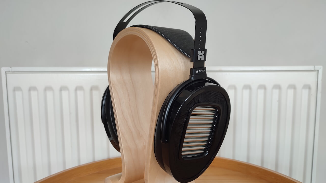

By removing the grilles at the back of the headphone, HiFiMAN claim that the diaphragm of its planar magnetic driver is able to move without any obstructions caused by sound waves reflecting back off the grilles if they were present.
You can replicate this effect by simply placing your hands over the cups on any open-back planar magnetic pair of headphones; sounds will become muffled and distorted. This is because the sound waves are reflecting off your hands back towards the diaphragm and adversely affecting its movement.
By removing any obstructions at the back of the diaphragm, HiFiMAN believe that it helps widen the soundstage and improve imaging depth. We will see if this was the case in the “listening” section of this review.
Said diaphragm is also less than a millionth of a meter thick, which HiFiMAN refer to as a Nanometer Thickness Diaphragm. The company says this improves the sonic quality in multiple ways, including dynamics and transient response times.
Stealth Magnets are also present on the Arya Unveiled. This means the magnets which control the movement of the diaphragm are shaped in an acoustically streamlined manner which minimizes its own inherent influence on the sound waves produced. This allows the sound quality to remain pure and unfiltered, at least according to HiFiMAN’s marketing.

Now you might be thinking that the lack of a protective cover on the back of the cups could increase the risk of damage. And you would be right, but as long as you aren’t surrounded by hundreds of small magnetic objects and don’t treat your headphones like a child’s toy — there’s nothing to really worry about.
Nevertheless, HiFiMAN include a set of magnetic veils which attach to the backs of each cup when you’re not using them. They are plastic but are designed to look like leather from a distance. Just make sure to take them off before pressing play; the frequency response is awful with them still attached and there is a small risk of driver damage too.
My ears touched the inner mesh, which I did not experience with the Arya Organic. A really minor negative as I didn’t feel any discomfort from this, but I know some people will feel somewhat uneasy about it.
Apart from that however, the design of the Arya Unveiled is the same as that of any Arya iteration. And that’s a good thing; it’s relatively light for a large planar magnetic at just over 400 grams and the headband and head strap distributes weight evenly across the head. I can’t wear many headphones for more than an hour or two at a time without some discomfort due to the shape of my head, but the HiFiMAN Arya Unveiled is one of few that I can wear for an extended period of time with no issues.
While the build isn’t the most inspiring with a mix of dull metals and shiny plastic cups, it feels sturdy enough to withstand a decent amount of physical abuse. Just don’t be too rough on them without the magnetic veils attached.

HiFiMAN Arya Unveiled Headphones Open Without Covers
Do the exposed drivers make a difference to the sound?
