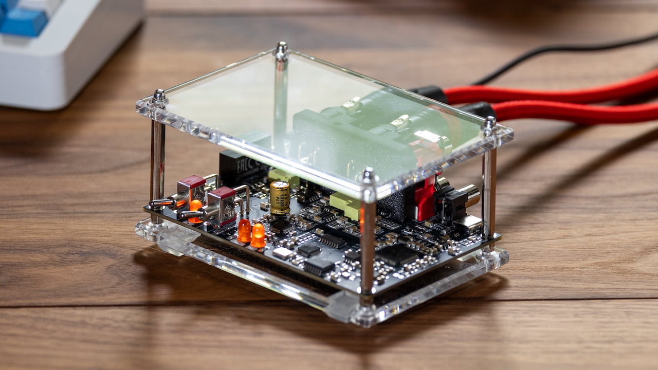

The Merlin uses the same Lexan plates on the top and bottom with stainless standoffs at the corners, and it shares the same compact 5 x 3 x 2.5 inch footprint as the Gremlin. The front panel keeps things simple. Two switches sit on the left, an outer power switch and an inner source selector. An LED between them indicates power, while two smaller LEDs to the right show the active input at a glance. Left is SPDIF and right is USB.

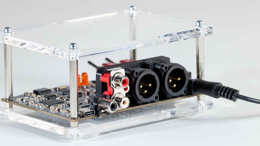

The rear panel keeps the theme of practical minimalism. A USB Type C port and an RCA style coaxial input sit on the left, followed by RCA outputs, XLR outputs, and a barrel connector for power. Since a DAC draws far less power than a Class A amplifier, the Merlin ships with a small wall wart style power supply rather than the larger laptop style brick used with the Gremlin.

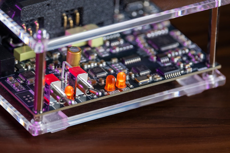

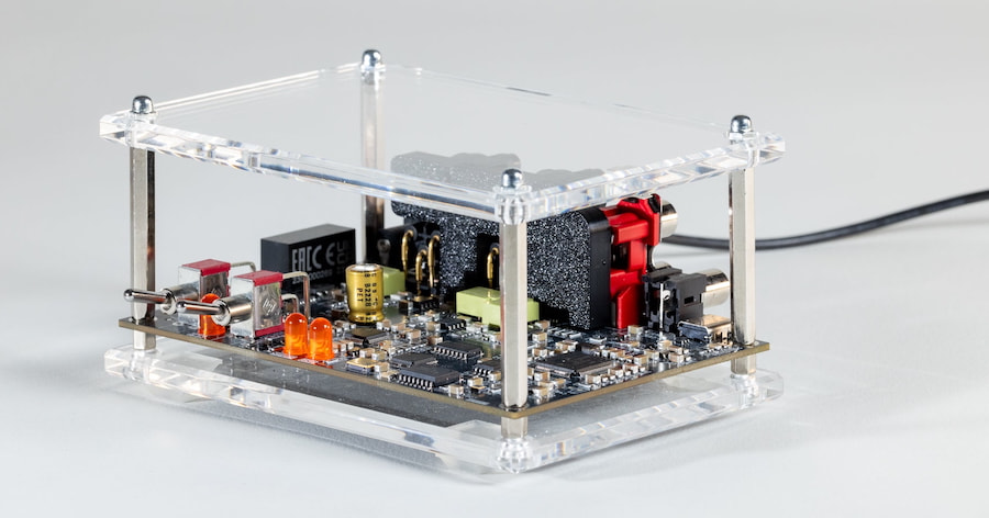

With the clear Lexan plates in place instead of a traditional aluminum enclosure, you can see the Merlin’s internals without even picking up a screwdriver. Front and center is the Amanero 768 module that handles USB input. It accepts PCM all the way up to 32-bit/768 kHz and up to DSD512. One of the nicest advantages of this module is that it operates driverless on most major operating systems. It also provides galvanic isolation and draws no power from the source device over USB, which cuts down on noise and eliminates the ground loop gremlins that love to sneak in from laptops and desktops.
 Apos x Geshelli Merlin DAC (rear)
For SPDIF input, the Merlin uses a Texas Instruments DIX9211 receiver that supports PCM up to 24-bit/192 kHz. DSD is not supported over coax, but given that SPDIF is typically used with older streamers and disc players that rarely support DSD anyway, this is not much of a drawback. In fact, it keeps the input section clean and focused while giving legacy devices a reliable way into the system.
Both inputs feed a single AK4493SEQ DAC chip that handles all decoding duties. This detail matters. Apos lists the chip simply as an AK4493 in some of its copy, but every unit I have seen—including my review sample—uses the AK4493SEQ.
That distinction is important because while all chips in the 4493 family share some core traits, the SEQ is the newest version built on AKM’s updated fabrication process. It supports higher resolutions up to 32-bit/768 kHz and DSD512, and it offers improved dynamic range and lower distortion compared to the older AK4493 and AK4493S variants.
The chip also includes six types of 32-bit digital filters, which allow for subtle tuning options, although those are not user selectable in this implementation. Even so, the choice of the SEQ version shows that Apos and Geshelli were not cutting corners. They picked the most recent and most capable member of the family for the heart of the Merlin.
The DAC chip feeds a bank of TI OPA1652 op amps, with four dedicated to the XLR outputs to deliver a fully balanced, fully differential signal path. A separate pair of OPA1652s handles the RCA outputs for single ended use. It is a straightforward, well executed layout that keeps the balanced and single ended stages cleanly separated while maintaining consistent tonal character across both outputs.

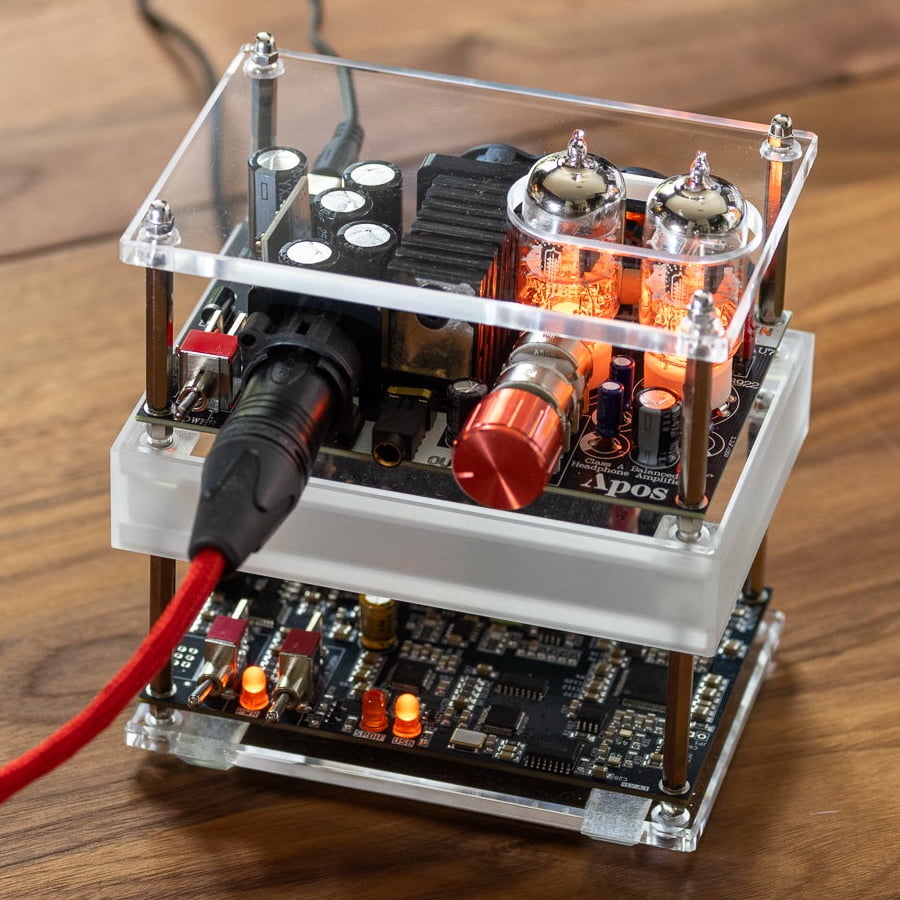

For those planning to pair the Merlin with the Gremlin, Apos includes a stacker bracket that lets the Gremlin sit neatly on top of the DAC, adding about an inch to the overall height. It works, but only in one direction. If the stacker were a little taller, you could reverse the order and put the Gremlin on the bottom. As it stands, the tubes sit too high for the Merlin to rest flush on top, so the current stack is a one way street.
Most people will want the tubes visible anyway, so this is hardly a tragedy, but a bit more height would have given buyers the option. As it is, the setup looks like a small science project on your desk, but it performs far better than its modest footprint suggests.
