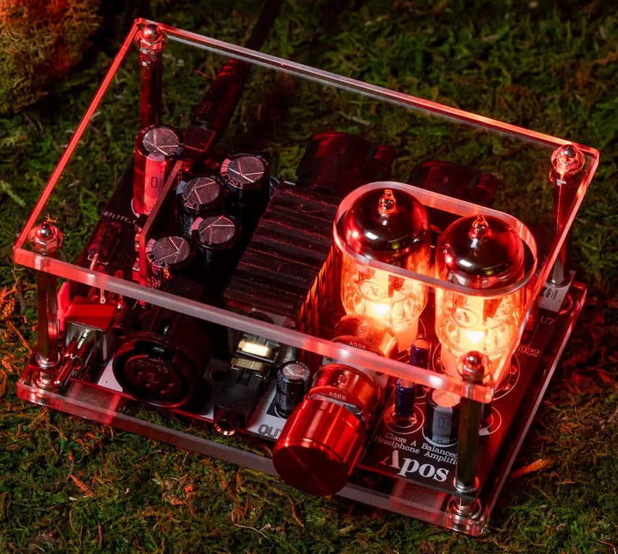

apos-gremlin-tube-headphone-amp-closeup

The amp itself is comically small—5 inches wide, 3.25 inches deep, and 2.5 inches tall—and unapologetically barebones in the best possible way. There’s no typical enclosure here; instead, you get clear Lexan plates on the top and bottom with stainless standoffs at the corners. The whole interior is on display like some Hawkins Lab science fair project, tubes glowing proudly while air moves freely across the chips.

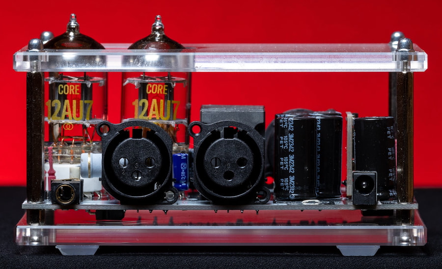

Up front, everything is simple and practical: a power switch, a 4.4 mm balanced output, a 4-pin XLR, and a volume knob. Around back, it keeps the same no-nonsense vibe with dual 3-pin XLR inputs, another 4.4 mm input, and a barrel connector for the power brick. That brick looks like it was pulled straight from a classic ThinkPad—AC cord on one end, rectangular converter in the middle, and the DC plug on the opposite end. No frills, no drama, just the essentials to bring this little creature to life.

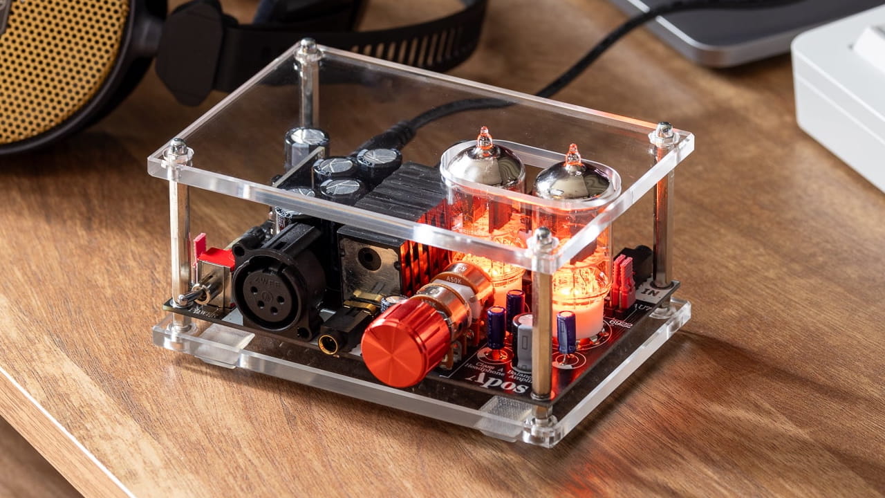

apos-gremlin-tube-headphone-amp-top-angle-left
Being able to see everything under the Lexan makes tracing the signal path from XLR input to XLR output almost laughably easy. No mystery box, no hidden gremlins—just a clean, fully balanced Class-A circuit laid out like someone actually expected enthusiasts to look at it. The design is a true hybrid: tubes handle the preamp duties while solid-state op-amps manage the output stage. That approach keeps output impedance low and ensures the Gremlin plays nicely with everything from sensitive IEMs to full-size 600-ohm headphones without wheezing.
The Class-A topology also explains the laptop-sized power brick. Class A doesn’t sip power; it chugs it, because the output devices conduct current for the entire signal cycle. That’s why Class-A amps are still the gold standard for linearity and why they tend to run warm even before you press play. This wasn’t a cost-cutting move—it’s a design decision that puts sound quality at the front of the line.
Specs back that up. The Gremlin delivers 1.25 watts into 32 ohms and has enough voltage swing to drive 600-ohm headphones with comfortable headroom. Frequency response is rated from 20 Hz to 50 kHz, with a signal-to-noise ratio of 100 dB and channel separation measured at 104 dB at 1 kHz. For an amp this small, transparent, and intentionally simple, the engineering is surprisingly serious.

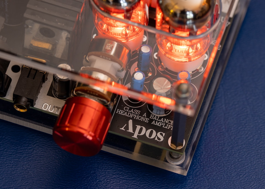

What immediately catches the eye when you look across the Gremlin’s circuit board is the pair of jumpers sitting between the outer tube socket and the 4.4 mm input. Those little switches aren’t decorative—they let you swap between the default 12AU7 family and the 6922 family, the two most common small-signal tube lineages on the planet. If you’re even mildly tube-curious, this is a gift. If you’re like me and have enough tubes to qualify as a fire hazard, it’s basically an invitation.
apos-gremlin-tube-headphone-amp-rear
I won’t go deep into tube rolling here—there’s a separate article coming for that—but the Gremlin’s compatibility list is impressively wide. On the 12AU7 side, you can roll everything from the standard 12AU7, 12AU7A, and 12AU7W to ECC802, E82CC, 5814A, 6189, and half a dozen military variants. Flip over to the 6DJ8/6922 camp and you can run ECC88, E88CC, 6922, 7308, and the ever-popular 6N23P. Between those two tube families, you’re looking at well over 200 variants for the 12AU7 alone, plus another 40+ for the 6922 crowd. Translation: if you can’t find a tube that fits your taste here, the problem isn’t the amp.

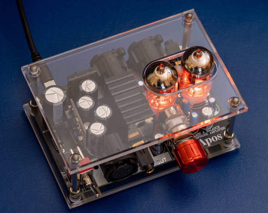

apos-gremlin-tube-headphone-amp-top-angle-on
