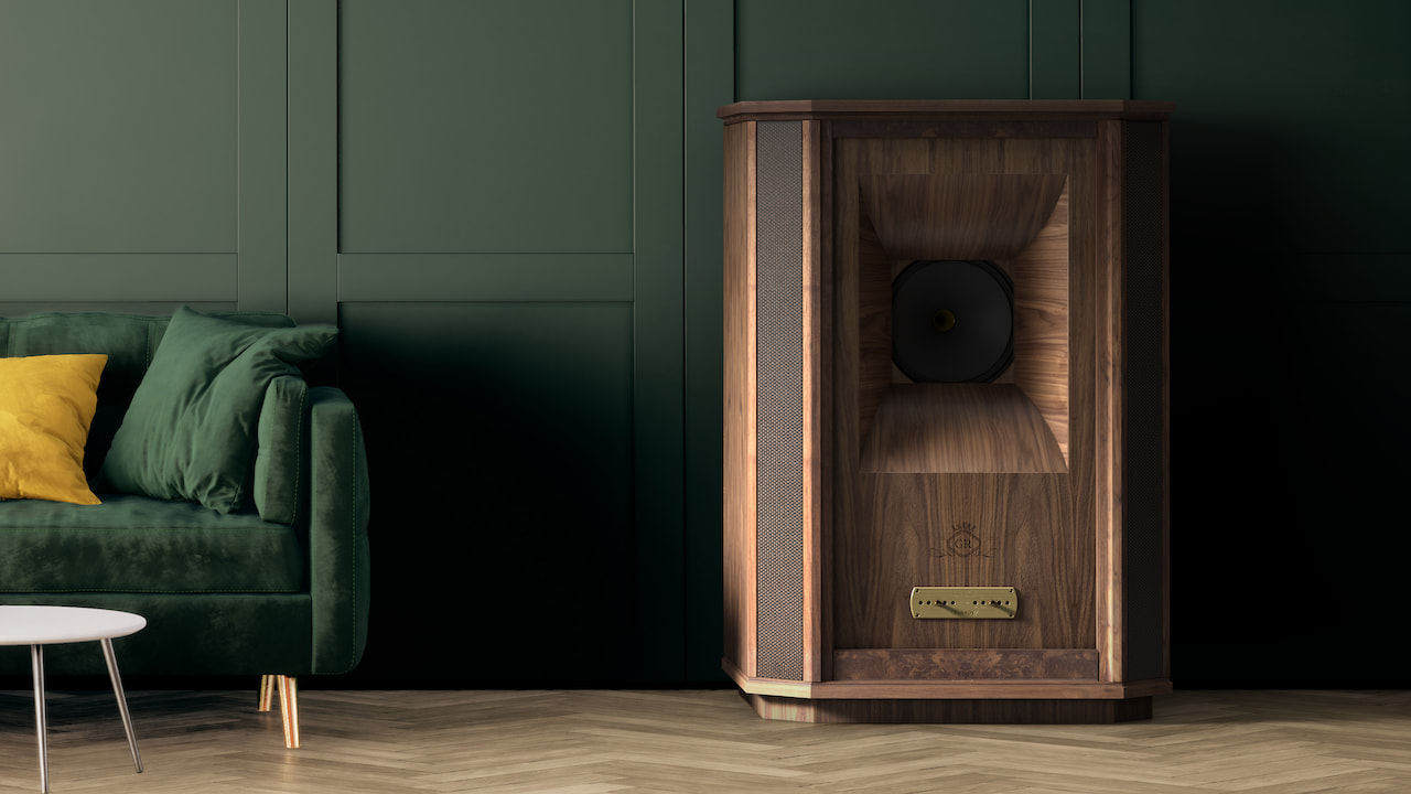

At HIGH END 2026 in Vienna, Tannoy will give attendees a rare chance to hear the Westminster Royal GR, the brand’s flagship Prestige loudspeaker and one of the most recognizable large-format designs in British hi-fi.
The Westminster Royal GR is a two-way, horn-loaded loudspeaker built around a 15-inch Tannoy Dual Concentric driver, a driver architecture first introduced by the company in 1947. This is not a compact lifestyle box pretending to be heritage audio. At 140 cm tall, 55 inches, and weighing 140 kg, 309 pounds, the Westminster Royal GR is closer to furniture with a passport and a solicitor.
Key acoustic technologies include Tannoy’s PepperPot WaveGuide, Alnico magnets, and aluminium-magnesium alloy diaphragm compression drivers with Mylar surrounds. The massive 530-litre birch ply cabinet uses extensive internal bracing and Tannoy’s Differential Materials Technology, which couples the drive unit to the cabinet using materials of varying density to help control resonance, improve damping, and reduce unwanted vibration.

The cabinet is finished in oiled walnut veneer with hand-selected burr walnut inlays, because when a loudspeaker weighs more than some motorcycles, it may as well look like it belongs in a country estate.
The Westminster Royal GR has a sensitivity rating of 99 dB. This contributes to better compatibility with amplifiers from high-powered transistors to low-powered tube amplifiers, while bass extension reaches down to 18 Hz for full-bandwidth reproduction.
