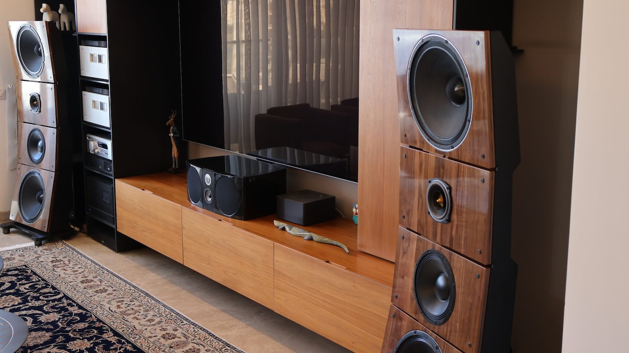

PureAudioProject Quartet15 Open Baffle Loudspeakers lifestyle

Four Paper Drivers and No Box
Each Quartet15 uses:
  • Two proprietary 15-inch paper-cone woofers developed with Eminence
  • One custom 10-inch paper-cone midwoofer
  • One 5-inch Voxativ AF 2.6 wide-range driver
PureAudioProject says using paper diaphragms throughout helps the drivers sound more consistent as music moves from bass through the midrange and into the upper frequencies.
That sounds reasonable on paper—quite literally—but the real question is whether four large drivers blend into one coherent loudspeaker rather than sounding like several excellent ideas sharing the same frame.
Because there is no conventional cabinet, the rear radiation remains part of the presentation. Open-baffle designs can produce a large, spacious soundstage with less enclosure coloration, but they need room to breathe.
PureAudioProject recommends placing the Quartet15 2 to 3.5 feet (60 to 106 cm) from the wall behind it. Buyers hoping to push them against the wall beside a media console should probably keep scrolling.
