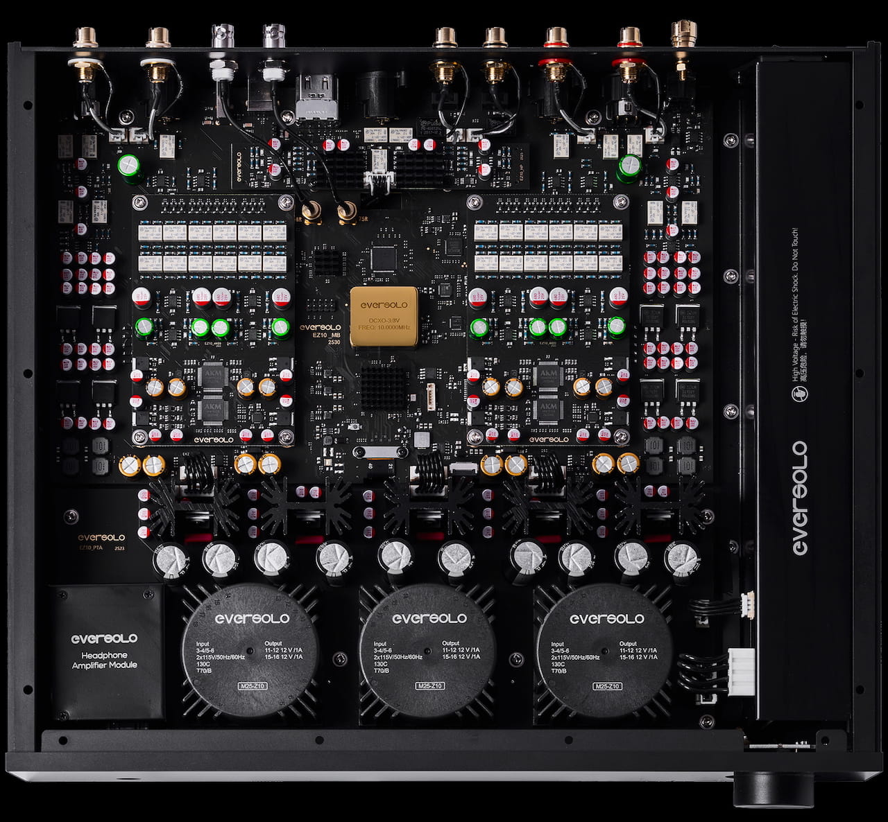

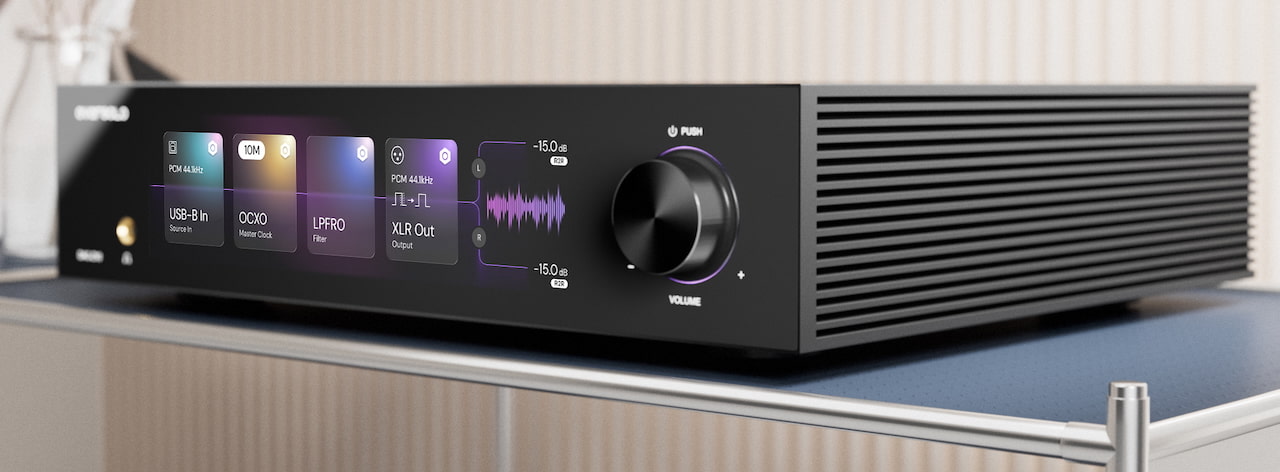

The DAC-Z10 is built around Eversolo’s proprietary Fully Isolated Architecture (FIA™), which physically separates digital and analog circuits to reduce interference and preserve signal integrity.
Internal Layout: Inside, three independent linear power supplies feed the left channel, right channel, and system circuitry. By isolating each section, Eversolo minimizes noise and distortion—allowing for a cleaner soundstage and more precise stereo imaging.
Dual AKM DAC Modules: At the heart of the DAC-Z10 are dual AKM decoding modules, with each channel powered by its own AK4191 and AK4499 chipset. This fully discrete design keeps the left and right channels isolated from input to output, improving channel separation, dynamic range, and overall resolution. With AKM’s Velvet Sound architecture, the DAC-Z10 maintains ultra-low distortion (THD+N 0.00008%) and a wide dynamic range of 130 dB, even when processing high-resolution DSD512 or PCM 768 kHz/32-bit audio.

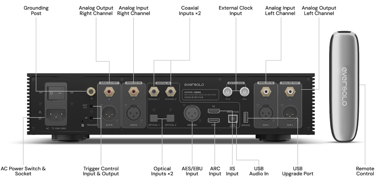

Connectivity: The DAC-Z10 includes an extensive range of connection options for integration into high-end systems. Inputs include USB Audio, dual coaxial, dual optical, I2S, AES/EBU, and HDMI ARC/eARC. The USB input features a multi-core audio processor that supports DSD512 Native and PCM 768 kHz/32-bit lossless transmission. The HDMI I2S input offers eight user-selectable modes to ensure compatibility with a wide range of digital sources from various brands. Each input is electrically isolated to prevent ground loop interference, ensuring the cleanest possible signal path and optimized sound quality.

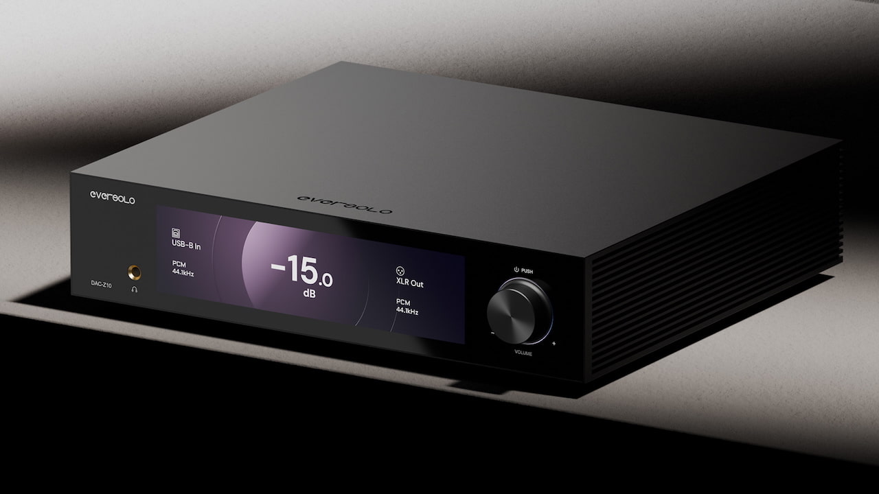

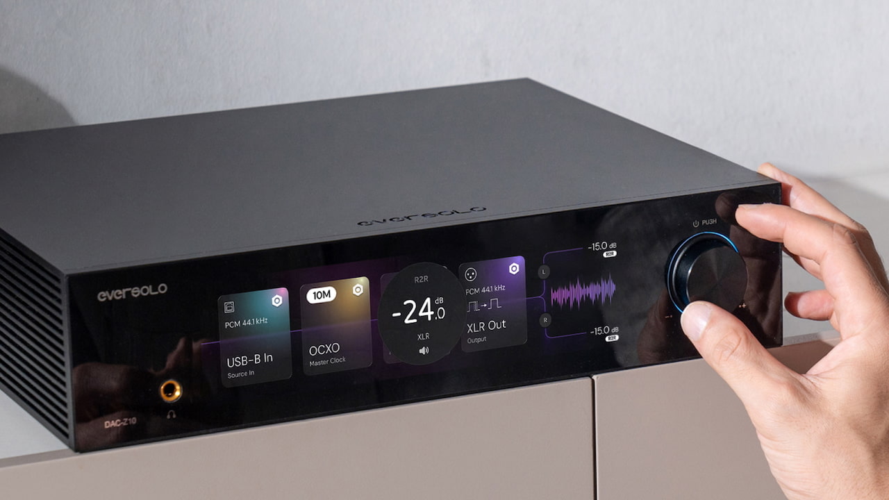

Touchscreen Display: Dominating the front panel is an 8.8-inch IPS LCD touchscreen that gives the DAC-Z10 a modern, refined look while incorporating electromagnetic shielding to prevent interference. The interface is clean and responsive, avoiding complex menus in favor of intuitive touch navigation. Users can select from multiple VU meter and spectrum analyzer styles—ranging from classic analog to contemporary digital themes. Eversolo even lets you customize the color of the control knob, a subtle but thoughtful touch that underscores the brand’s focus on both design and usability.

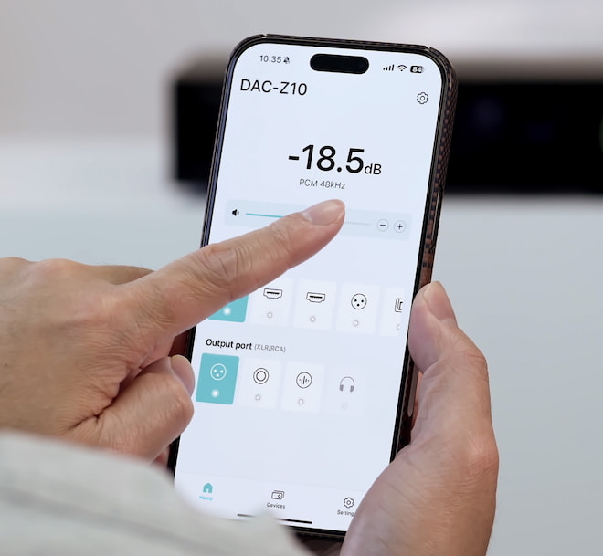

Remote Control: The DAC-Z10 supports remote control via smartphone or tablet. Using the Eversolo Control App, you can adjust volume, switch inputs, and manage all on-device settings directly from your mobile device.
