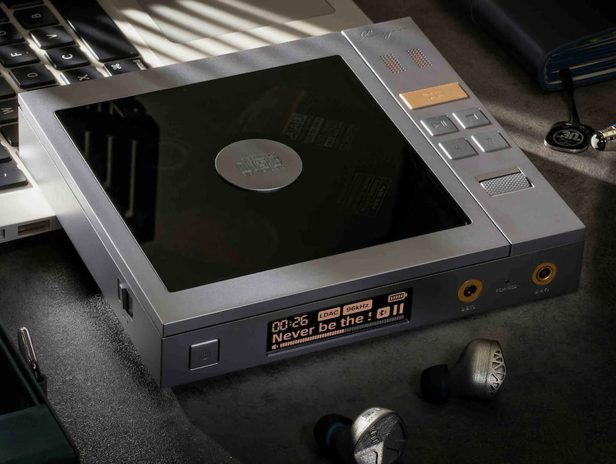

The CD never vanished; hardware manufacturers simply spent years pretending streaming had finished the job. With U.S. CD sales climbing 16 percent during the first half of 2026, that fiction has become harder to maintain, and the new generation of portable players is moving well beyond cheap plastic transports.
At $699, the Cayin CP6 pushes the category into full head-fi territory with dual Raytheon JAN6418 tubes, three selectable sound signatures, switchable Class A and Class AB operation, balanced headphone power, Bluetooth, USB DAC support and direct CD ripping inside a 720 gram aluminum chassis.
The CP6 is now available through authorized U.S. retailers including Bloom Audio and MusicTeck. It arrives in a market that suddenly contains multiple portable CD players from FiiO, Shanling and Moondrop, but Cayin has avoided making another rechargeable Discman with Bluetooth attached to the side.

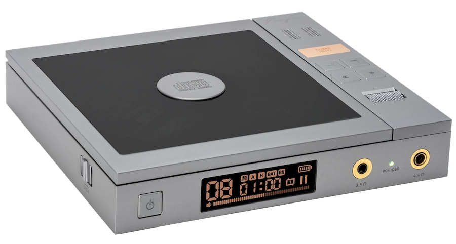

Cayin CP6
The CP6 uses two matched Raytheon JAN6418 NOS tubes in a dual channel Class A common cathode stage. Listeners can select between Classic Tube, Modern Tube and Solid State modes from the front panel.
Cayin describes Classic Tube as smoother and more vocal focused, while Modern Tube is intended to sound more open and resolving. Solid State bypasses the tube presentation for a cleaner and more neutral balance.
The distinction matters because the CP6 is not merely placing glowing tubes behind a window and hoping everyone becomes emotionally vulnerable. The tube stage feeds both its headphone and line level outputs, allowing the three sound options to be used with wired headphones or a larger audio system.
The headphone amplifier can also be switched between Class A and Class A/B operation, providing another way to alter power consumption and operating behavior. Combined with the three timbre choices, that gives listeners six possible amplifier configurations before they have even started arguing about which pressing of the album sounds best.

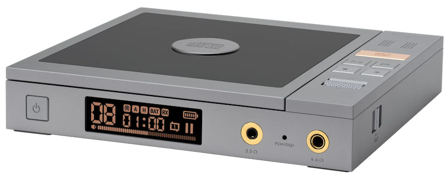

Digital conversion is handled by two Cirrus Logic CS4308P eight channel DACs, each operated in mono mode with parallel differential current output. Two Texas Instruments OPA1612 devices handle current to voltage conversion and low pass filtering.
The fully balanced four channel headphone amplifier provides both 3.5mm single ended and 4.4mm balanced outputs. On battery power, the balanced connection delivers up to 900mW per channel into 32 ohms or 1.1 watts into 16 ohms. External DC power raises those figures to 1.1 watts and 1.3 watts respectively.
That is enough output for considerably more than sensitive IEMs. Cayin rates the CP6 for headphones from 8 to 600 ohms, although impedance alone never tells the entire story with difficult planar magnetic designs.
The 3.5mm output is no afterthought either, delivering up to 330mW into 32 ohms on battery power and 420mW when externally powered.
