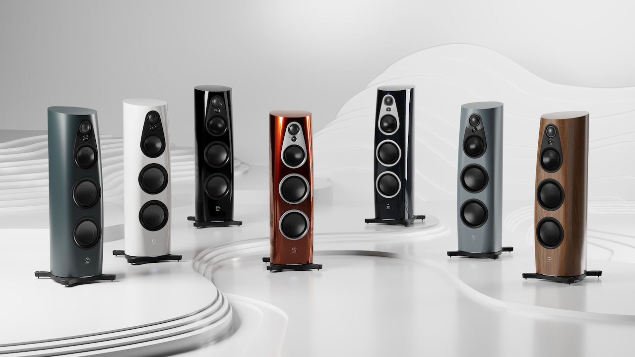

2026 LINN 360 Floorstanding Loudspeaker Family
Linn is not done tinkering with its flagship 360 loudspeaker, and for 2026, the Scottish hi-fi manufacturer has announced a new driver upgrade aimed at reducing one of the last major sources of distortion in the system: the lower-frequency drive units.
Originally introduced in 2023, the Linn 360 already combined the company’s Exakt phase-linear digital crossover, Adaptive Bias Control, Power DAC architecture, and a highly engineered cabinet design to deliver wide dispersion and low distortion. But Linn concluded that the existing off-the-shelf bass drivers were still limiting performance. Very Scottish response: stop complaining, spend three years designing your own.
The result is a new 6-inch upper-bass driver and 8-inch woofer, both developed from first principles around Linn’s Pistonik motor system. The company says the new drive units are designed to improve linearity across their excursion range, lower distortion, and deliver greater accuracy from its flagship loudspeaker platform. Whether your room, wallet, and neighbors are ready for that level of scrutiny is another matter.

Finishes Glasgow Collection Clyde Built, Single Malt, Linn Heritage
Classic Collection Piano Black, Alpine White, Walnut
Signature Collection Triton
Custom Yes – match any color
Trim Silver or Black Anodized

Linn has also added a new real-wood walnut veneer finish for the 360. The finish joins the Classic Collection and can be paired with either anodised black or silver machined aluminium trim. The walnut grain adds some visual warmth to a loudspeaker that has never exactly been shy about looking expensive.
