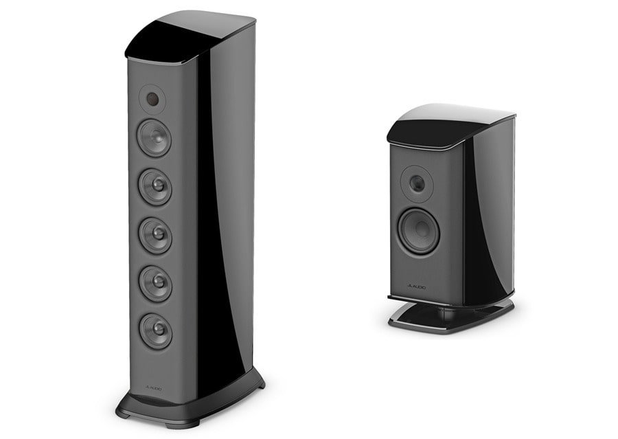

Primacy T6
Primacy will be offered in two loudspeaker configurations: the T6 three-way tower loudspeakers or the S3 two-way bookshelf/stand-mount loudspeakers. Both systems are designed around the same basic idea: keep the amplification, signal processing, loudspeakers, and system control working as one package instead of forcing the customer to assemble the whole thing one expensive box at a time.
That matters because this is not a passive speaker system waiting for someone to add an amplifier, streamer, DAC, and room correction later. Garmin and JL Audio are selling Primacy as a complete active loudspeaker ecosystem, with the electronics and speakers intended to operate together from the beginning.
Garmin JL Audio Primacy S3 Bookshelf Active Speakers Lifesstyle
Primacy S3

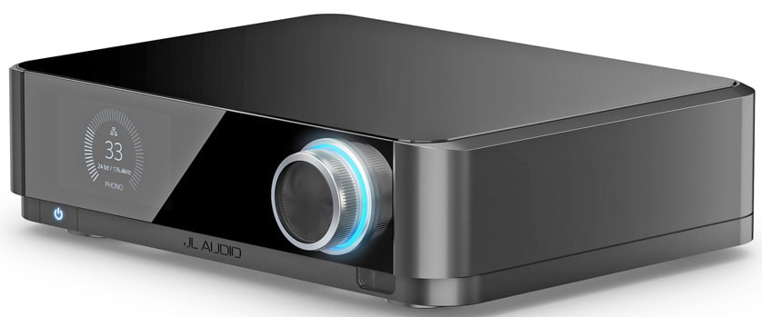

The hub of the Primacy system is the CS Centerpiece, which handles network streaming, preamp duties, system control, and room optimization processing. In other words, this is where the Primacy system stops being just a pair of active loudspeakers and becomes a complete JL Audio ecosystem.

Active Design: The Primacy T6 and S3 are active loudspeakers with DSP based audio filtering and built in amplification for each driver section. JL Audio uses switching amplifier technology, with DSP filtering applied at the input of each active amplifier channel. The goal is tighter control over each driver and better integration across the loudspeaker, rather than relying on an external amplifier and passive crossover network to sort it all out after the fact.
The Primacy T6 is the floorstanding tower option, while the Primacy S3 is the bookshelf or standmount model for smaller rooms, secondary spaces, or installations where a full tower makes less sense. Not everyone wants a loudspeaker that looks like it requires its own zoning permit.
Precision Machined Alloy Enclosure: Each Primacy loudspeaker uses a single cast, precision machined aluminum alloy enclosure with integrated internal bracing and woofer ports. That construction is designed to improve structural rigidity, reduce unwanted resonance, and support more predictable acoustic performance. It also makes the system feel more like a finished luxury product than another wooden box pretending the room is not part of the problem.

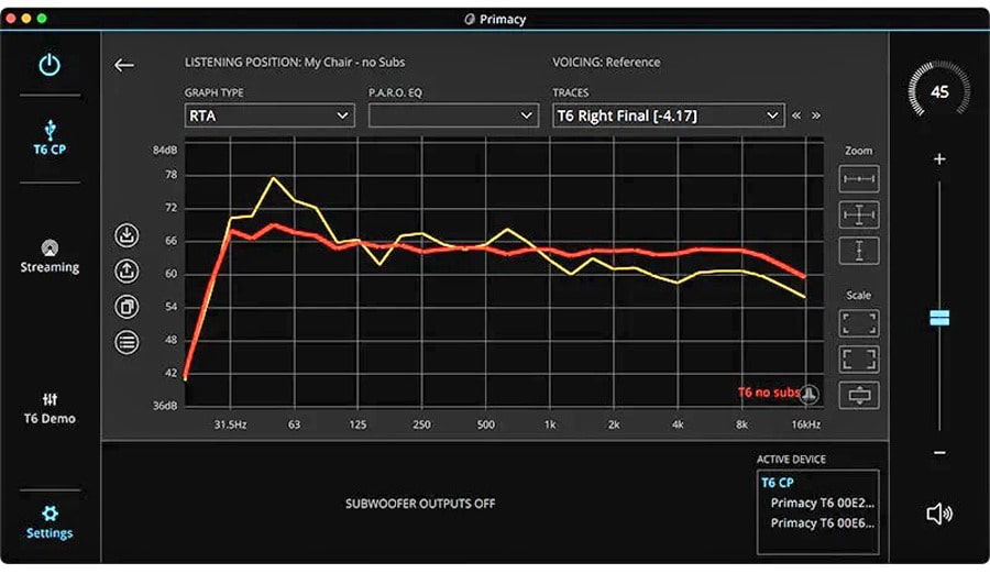

Primacy Automatic Room Optimization: Primacy Automatic Room Optimization, or P.A.R.O., measures and optimizes the system during setup, including any additional powered subwoofers used with the system. According to JL Audio, P.A.R.O. automatically adjusts crossovers, levels, equalization, and delay for each driver section. That matters because this is a fully integrated active system, not a mix and match pile of components hoping the room behaves itself.

CS Centerpiece System Hub: The Primacy CS Centerpiece is the control hub for the system, combining network streaming, preamplifier functions, source connectivity, and control for the T6 and S3 active loudspeakers. It is designed to keep the main system functions in one component rather than requiring separate boxes for streaming, preamplification, source selection, and system control.
Streaming and Source Connectivity: The CS Centerpiece supports Bluetooth, AirPlay, Google Cast, Spotify Connect, Qobuz Connect, and TIDAL Connect. It also provides wired digital and analog inputs, including MM/MC phono input for turntable users. That gives Primacy support for both modern streaming services and traditional sources.

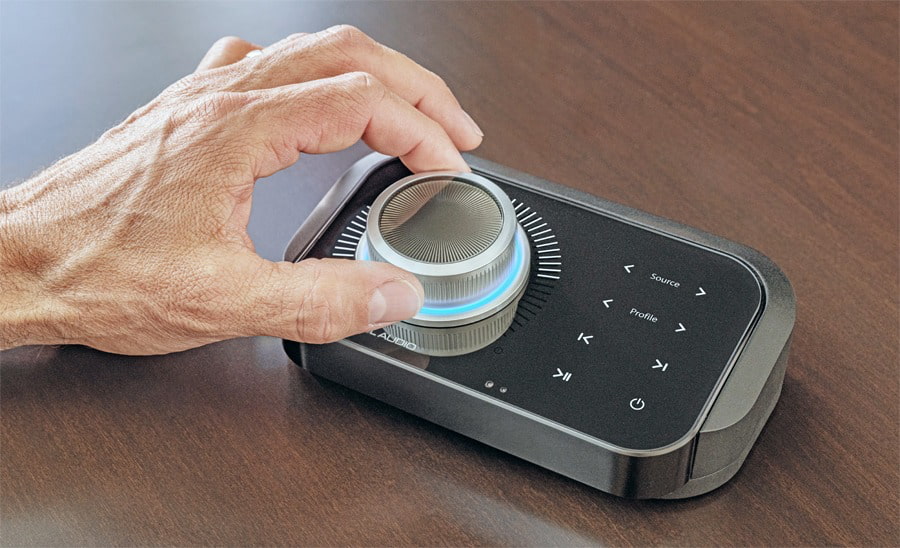

External Tabletop Remote: The system includes an external wireless tabletop remote, giving users physical control without relying only on a phone or tablet.
Minimalist Industrial Design: The CS Centerpiece has a clean, minimalist design intended to integrate into a room without drawing too much attention. That fits the broader Primacy approach: fewer visible components, fewer cables, and a more controlled system layout.
garmin-primacy-remote

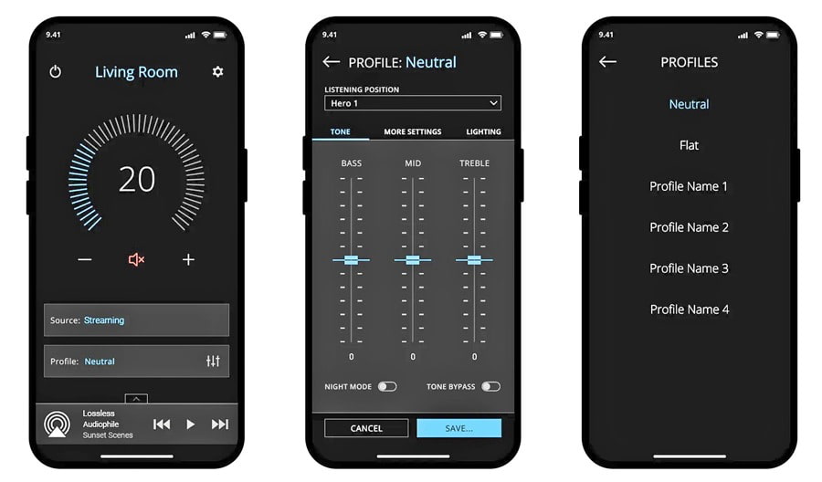

Primacy App
garmin-primacy-app
As a complement to the Centerpiece, JL Audio’s Primacy App also provides audio and room optimization control. The app can also be used to create, store, and name listening profiles optimized for different listening positions, equalization preferences, and activities.
JL Audio Primacy Comparison
garmin-primacy-t6-s3
JL Audio Model T6 S3
Product Type Floorstanding Active SpeakerBookshelf Active Speaker
Price (Pair)$90,000$35,000
Driver Configuration 3-Way2-Way
Drivers1 x Tweeter: 1″
1 x Midrange: 5.5″
4 x Woofer: 5.5″
1 x Tweeter: 1″
1 x Woofer: 5.5″
Enclosure typeTweeter: Sealed
Midrange: sealed, secondary cast alloy enclosure
Woofer: bass-reflex design vented at the base of the primary cast alloy enclosure
Tweeter: Sealed
Amplifier Power (RMS)1000 W (Total)
Tweeter: 200 W
Midrange: 200 W
Woofer: 600 W
400 W (Total)
Tweeter: 200 W
Woofer: 200 W
Frequency response (Anechoic)45 Hz to 20 kHz, ±2 dB, -3 dB @ 35 Hz, -6 dB @ 32 Hz. 55 Hz to 20 kHz, ±2 dB, -3 dB @ 44 Hz, -6 dB @ 36 Hz.
Digital to Analog ConvertersESS SABRE Reference DACs x 3 (operating in mono mode) ESS SABRE Reference DACs x 3 (operating in mono mode)
Analog to Digital ConverterESS SABRE ES9822PRO (operating in mono mode) ESS SABRE ES9822PRO (operating in mono mode)
Digital Signal Processor AKM triple-core with Velvet Sound technology, processing at 32 bit/192 kHz for local system volume, crossovers, delays, equalization, and dynamics for each amplifier and driver section AKM triple-core with Velvet Sound technology, processing at 32 bit/192 kHz for local system volume, crossovers, delays, equalization, and dynamics for each amplifier and driver section
Signal ProcessingUnbalanced input(s) Mono (one RCA jack – input impedance of 50k ohms)
Balanced input(s) Mono (one female XLR jack – input impedance of 50k ohms)
Calibration modePrimacy Automatic Room Optimization (P.A.R.O.) via PC and Primacy Centerpiece (sold separately)Primacy Automatic Room Optimization (P.A.R.O.) via PC and Primacy Centerpiece (sold separately)
Input modesAnalog or Dante NetworkAnalog or Dante Network
12 V trigger output capacity50 mA max (1/8″ (3.5 mm) mini jack)50 mA max (1/8″ (3.5 mm) mini jack)
Maximum peak short-term sine wave acoustic output, averaged from 100 Hz to 3 kHz @ 1 m, half space>112 dB SPL>114 dB SPL
Dante Network ConnectionsTwo RJ45 portsTwo RJ45 ports
Analog input sensitivity0.32 V (-10 dBV) to 8.0 V (+18 dBV)0.32 V (-10 dBV) to 8.0 V (+18 dBV)
Input modesAnalog or Dante® NetworkAnalog or Dante® Network
Input GroundingIsolated or grounded (analog inputs)Isolated or grounded (analog inputs)
Level controlLevel Trim (dB): 0 to -5 dB and muted (-∞)Level Trim (dB): 0 to -5 dB and muted (-∞)
Filter frequency range High-pass80 Hz80 Hz
Crossover frequencies/slope240 Hz/3 kHz, 24 dB/octave Linkwitz-Riley240 Hz/3 kHz, 24 dB/octave Linkwitz-Riley
Processing bit depth/resolution 32 bit/192 kHz 32 bit/192 kHz
Power modesOff, on or automatic (signal-sensing or 12V trigger)Off, on or automatic (signal-sensing or 12V trigger)
Mains voltage100 to 240V AC, 50/60 Hz 100 to 240V AC, 50/60 Hz
Enclosure Finish (Standard)Black glossBlack gloss
DimensionsHeight: 48.9″ (1,242 mm)
Width: 14.2″ (361 mm)
Depth 21.2″ (538 mm)
Height: 20.7″ (526 mm)
Width: 10.1″ (257 mm)
Depth: 13.5″ (343 mm)
Weight272 lbs (123 kg)82 lbs (37 kg)
In The BoxT6 speaker with black
gloss decorative side panels
Power cord
Documentation
White gloves
Grille(s) included
S3 speaker with black gloss decorative side panels
Power cord
White gloves
Documentation
Primacy CS Centerpiece Specifications
garmin-primacy-cs-angle
Jl Audio Model Primacy CS Centerpiece
Product TypeStreamer, Preamp, Controiller
Price$15,000
ConstructionPrimary cast aluminum alloy enclosure with secondary machining, glass top, and fascia
Volume controlMachined aluminum rotary dial with active lighting ring and push-button center cap
DisplayRGB AMOLED dead front, 640 x 320 pixels, 198 ppi, 70 x 43 mm active area
Circuitry ShieldingModular architecture with isolated power supply and dedicated, fully shielded secondary enclosures for analog and phono subsections
Thermal ManagementActive, quiet-flow fan cooling system with user-serviceable air intake filtration
Streaming FunctionalityApple® AirPlay® 2, Google Cast™, Qobuz Connect, Roon Ready, SPOTIFY® Connect, TIDALSMConnect, and more…
Network StandardUPnP/DLNA
Digital to Analog convertersESS SABRE Reference DACs x 2 (operating in mono mode)
Analog to Digital ConvertersESS SABRE PRO x 2 (operating in mono mode)
Digital signal processorAKM triple-core with Velvet Sound technology, with local input switching/routing and line output processing
Processing bit depth/resolution32 bit/192 kHz
Sample Rate ConversionDedicated, hardware asynchronous sample rate converters for rate matching non-analog inputs to core 32-bit/192 kHz processing
Primacy® Automatic Room Optimization (P.A.R.O.)Yes – Includes speaker and subwoofer optimization
Computer RequirementsA computer running the Primacy Desktop application
Windows 10 (OS Build 1809 or later), 11
Mac OS 14, 15, 26
Audio SettingsBalance:  left/right channel slider
Tone controls: Off/on
Bass: -6.0 dB to +6.0 dB in 0.5 dB steps
Midrange: -6.0 dB to +6.0 dB in 0.5 dB steps
Treble: -6.0 dB to +6.0 dB in 0.5 dB steps
Extreme Low Frequency (E.L.F.) Trim –12 dB to 0 dB in 0.5 dB steps
Network Digital Audio TransportProtocol Dante® audio over IP
Standard 802.3ab compliant (1000BASE-T)
Four RJ45 (Four-port switch, redundant or daisy chain Dante + control)
2 Channels @ 32 bit/192 kHz
Unbalanced Analog Inputs (RCA)Two sets of left and right RCA input jacks
Input impedance: 47 kΩ
Frequency response 20 Hz to 20 kHz (+/- 0.02 dB)
Phono Inputs (RCA)Left and right RCA input jacks, plus grounding terminal – MM and MC compatible
RIAA equalization method: Two separate passive networks per channel, one each for low and high frequencies.
RIAA frequency response 20 Hz to 20 kHz (+/- 0.2 dB)
Optical Input (Toslink)3 x Toslink (SPDIF)
Input receiver transfer rate 25 Mbps (max)
Input receiver sensitivity (min) –27 dBm
Input receiver wavelength 650 nm
Digital input data type: 44.1 kHz to 192 kHz, 24-bit LPCM
HDMI InputStandard HDMI 2.1/HDMI-CEC
Audio format 2 CH LPCM (ARC/eARC)
Sample rate support 16/20/24/32 bit @ 44.1/48/88.2/96/176.4/192 kHz
USB Input (USB-C®)USB 2.0 (high speed)
ASIO 2.3.1 compliant driver (supports audio class 1.0/2.0 and USB 2.0 full-speed/high-speed devices
PCM: 16/20/24 bit @ 44.1/48/88.2/96/176.4/192/352.4/384 kHz
DSD: 1x/2x/4x
Subwoofer OutputsTwo sets of analog subwoofer output jacks (RCA and XLR)
Network/Wireless SpecificationsLAN 802.3ab compliant (1000BASE-T) (for the best streaming experience, a wired LAN connection is recommended)
WLAN 802.11a/b/g/n/ac/ax 2×2 MIMO (Wi‑Fi® 6)
Bluetooth® 5.1 SBC with AAC codec
RST
DFU
USB-2
USB-3 Service controls
PowerMains voltage 100 to 240 V AC, 50/60 Hz
Power consumption Standby in Eco mode: < 7.0 W
Idle power consumption (active with no signal) 120 V: ~34 W, 240 V: ~40 W
12 Volt Trigger12 VDC input: 1/8″ (3.5 mm) mini jack, tip positive
12 VDC output 1/8″ (3.5 mm) mini jack, tip positive, 50 mA max. load
CS Centerpiece Physical SpecificationsOverall height (including feet) 3.61″ (92 mm)
Chassis height 3.31″ (84 mm)
Width 13.10″ (333 mm)
Overall depth (including volume control and connections) 11.30″ (287 mm)
Net weight 18 lbs (8 kg)
CS Remote Controller Physical SpecificationsHeight 1.20″ (31 mm)
Width 6.61″ (168 mm)
Depth 3.98″ (101 mm)
Net weight 1.72 lbs (0.78 kg
What’s In The BoxPrimacy centerpiece
Tabletop remote controller
USB-C cables (4 m and 2 m)
P.A.R.O. microphone
Power cord
Microphone fixturing accessories
Microfiber cloth
Documentation
