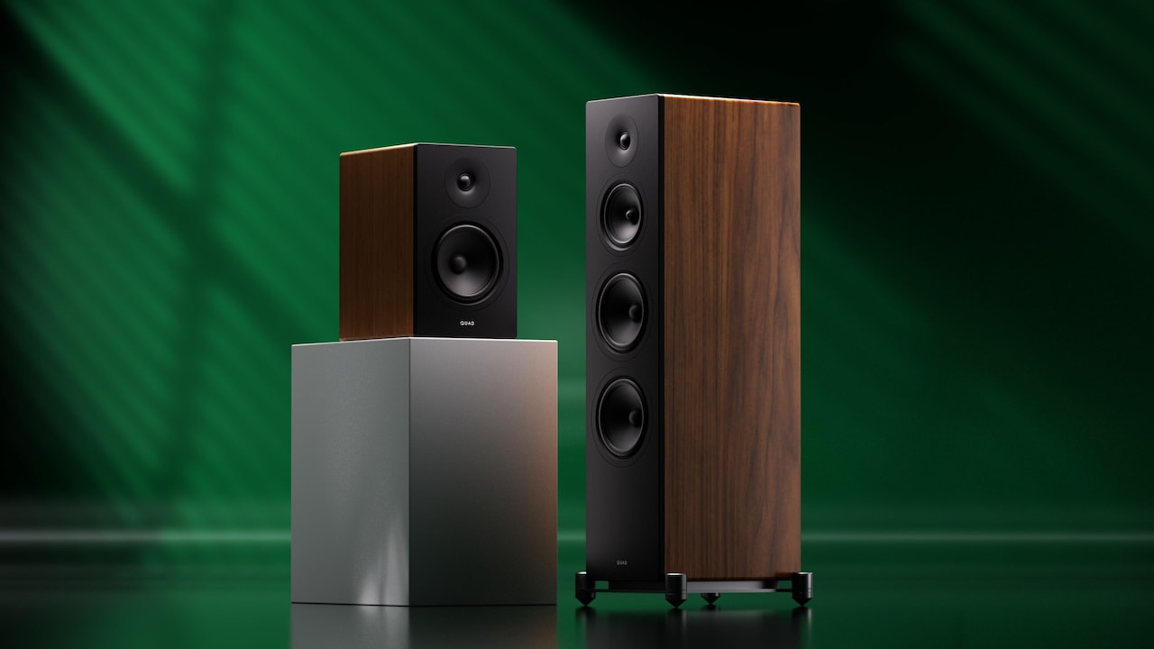

QUAD Elegan 1 and Elegan 2 Speakers Bring British Hi-Fi Back to Earth From $995
2026 QUAD Elegan 1 and Elegan 2 Loudspeakers
I have a QUAD problem.
An original Vena still lives in my system, the QUAD 3 was one of the easiest Editors’ Choice decisions I have made in years, and the ESL 2912X was among the most compelling loudspeakers at AXPONA 2026. I am not pretending to approach the new $995 Elegan 1 and $1,995 Elegan 2 without expectations.
That does not mean they receive a free pass. It means QUAD has my attention.
The two model Elegan Series sits below the Revela and ESL ranges, giving the British manufacturer a more affordable loudspeaker family designed to partner with the QUAD 3, revived 33 and 303, and other reasonably powered amplifiers. Both models are available now in matte black or real walnut veneer.
QUAD shaved the final “t” from elegant, but apparently not much from the engineering budget.
The QUAD L Series Connection
The Elegan speakers are entirely new designs, but QUAD describes them as spiritual successors to the 11L and 12L models introduced in the early 2000s.
Those compact Kevlar equipped loudspeakers helped expose a much broader audience to QUAD without asking them to rearrange the living room around a pair of electrostatic panels. The Elegan 1 follows that same basic idea, while the larger Elegan 2 expands it into a proper three way floorstander.
Both models were developed under Peter Comeau, QUAD’s Director of Acoustic Design, who has spent the past several years rebuilding the company’s loudspeaker and electronics ranges rather than merely polishing old logos.
The Elegan speakers are not smaller Revelas and certainly not conventional versions of the ESLs. They are simpler, less expensive dynamic loudspeakers built around QUAD’s long experience with woven Kevlar cones.

QUAD Elegan 1 Specifications
quad-elegan-1-interior
The Elegan 1 is a rear ported, two way standmount loudspeaker intended for small to medium sized rooms.
  • Tweeter: 25mm fabric dome with waveguide
  • Midbass Driver: 165mm woven Kevlar cone
  • Sensitivity: 86dB at 2.83V/1m
  • Nominal Impedance: 8 ohms
  • Minimum Impedance: 4.3 ohms
  • Frequency Response: 56Hz to 24kHz, ±3dB
  • Bass Extension: 44Hz, minus 6dB
  • Crossover Frequency: 2.9kHz
  • Recommended Amplifier Power: 30 to 150 watts
  • Maximum Output: 102 dB
  • Dimensions: 345 x 222 x 333 mm (13.6 x 8.7 x 13.1 inches)
  • Weight: 8.3 kg (18.2 lbs) each
The 86dB sensitivity means the Elegan 1 is not intended for a two watt amplifier and positive thinking. A stable integrated amplifier delivering 40 to 100 watts per channel should make far more sense.
The QUAD 3, with 65 watts per channel into 8 ohms and 100 watts into 4 ohms, appears to be an obvious partner on paper.
QUAD Elegan 2 Specifications
quad-elegan-2-interior
The Elegan 2 is a three way, rear ported floorstander designed for larger rooms and higher playback levels.
  • Midrange: 125mm woven Kevlar cone in an isolated chamber
  • Woofers: Two 165mm woven Kevlar cones
  • Sensitivity: 90dB at 2.83V/1m
  • Minimum Impedance: 3.0 ohms
  • Frequency Response: 44Hz to 24kHz, ±3dB
  • Bass Extension: 32Hz, minus 6dB
  • Crossover Frequencies: 480Hz and 2.7kHz
  • Recommended Amplifier Power: 30 to 200 watts
  • Maximum Output: 106 dB
  • Dimensions: 930 x 310 x 373mm (36.6 x 12.2 x 14.7 inches)
  • Weight: 27.8 kg (61.3 lbs) each
The 90dB sensitivity looks friendly, but the 3 ohm minimum impedance means amplifier quality still matters. The Elegan 2 does not require 300 watts, but it will benefit from an amplifier with a healthy power supply and stable current delivery.
The QUAD 3 should work in smaller and medium sized rooms, while the 303 power amplifier, Platina Integrated, Audiolab 7000A class of amplifier, or comparable 70 to 150 watt designs would provide more breathing room.
Crossover & Cabinet Design
Both speakers use dedicated Linkwitz Riley crossover networks developed through computer modeling and extensive listening tests.
The Elegan 2 uses fourth order slopes between the midrange and tweeter, with second order slopes between the bass drivers and midrange. Polypropylene capacitors are used throughout, supported by air core inductors in the midrange and treble sections and laminated core inductors for bass.
The cabinets use high density panels, internal bracing and damping material, along with QUAD’s rear Airflow port system. The Elegan 2 gives its dedicated midrange driver a sealed internal chamber, preventing pressure from the two woofers from interfering with the vocal range.
