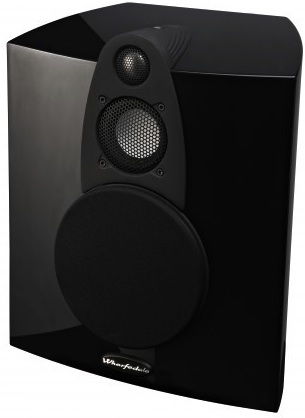

Wharfedale Jade-SR Surround Speaker
Whafedale Jade-SR
The Acufiber cones also feature a moulded pattern that breaks up standing waves in the cone to further reduce coloration and distortion, enabling the cone to behave more like an ideal acoustic 'piston' without the resonances experienced by formed metal cones.
