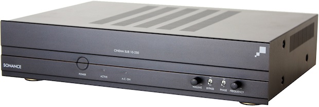

Sonance SONAMP Cinema Sub 10-250 Amplifier
Class D Amplifiers For Continuous Power
The outboard Cinema Series subwoofer amplifiers feature Class D output stage, line and speaker level high pass filtering and are designed specifically to complement the SUB10-250 and SUB12-500 drivers and enclosures. Each amplifier is capable of driving up to two woofers.
