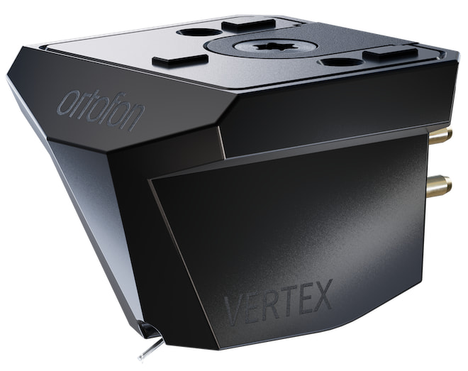

The MC Vertex Diamond: Contact Geometry Comes First
Ortofon MC Vertex Phono Cartridge
The MC Vertex is built around Ortofon’s new Vertex diamond. The stylus has a 4 μm scanning radius and a 110 μm contact radius, giving it an extended contact area along the groove wall.
The goal is more stable tracking, more even pressure distribution, and reduced localized wear compared with more conventional stylus profiles. That geometry should also help the cartridge maintain more consistent contact with the groove during complex passages.
At this level, the diamond profile is not a minor detail. It directly affects tracing accuracy, groove wear, and how much information the cartridge can retrieve before the signal ever reaches the phono stage.

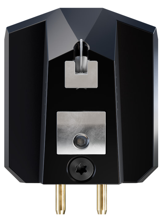

Ortofon MC Vertex Phono Cartridge Bottom
Solid Diamond Cantilever
The Vertex diamond is mounted to a laser-polished solid diamond cantilever, which is one of the more important details here. Diamond is extremely rigid and very low in mass, so the goal is to transfer mechanical energy from the stylus tip to the generator system with less flex, delay, or stored energy than more conventional cantilever materials.

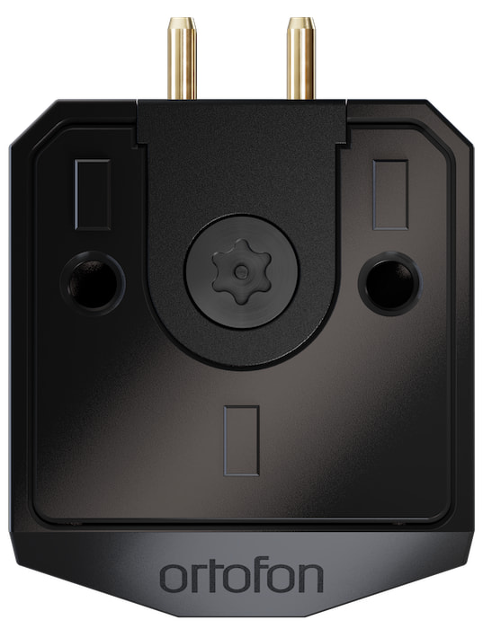

Ortofon MC Vertex Phono Cartridge Top
The body and internal core are made from SLM titanium with a DLC coating. Selective Laser Melting allows Ortofon to control the body geometry, mass distribution, and internal structure with greater precision than conventional machining.
The goal is a rigid, mechanically stable cartridge body that helps reduce unwanted resonance before it can affect signal generation.
Inside the MC Vertex, Ortofon uses a refined magnetic system with a non-magnetic armature. The purpose is to reduce moving mass and avoid unwanted magnetic interaction inside the generator. That is paired with high-purity silver coils, with Ortofon claiming more stable and linear signal generation, improved transient behavior, and more precise tracking across the audible range.
Ortofon’s Wide Range Damping system is also part of the design. It uses a platinum disc positioned between two dampers made from proprietary Ortofon rubber compounds. The intent is to control resonance across the audible frequency range without overdamping the cartridge or restricting dynamic response.

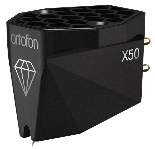

Ortofon MC X50: The MC for the Rest of Us
ortofon-mc-x50
The MC Vertex is the statement product, but the MC X50 is the new Ortofon cartridge more listeners are likely to consider for a serious high-end vinyl system.
Priced at $1,699, the MC X50 sits at the top of the MC X Series. It uses a Nude Micro Ridge diamond stylus with a 2.5/75 μm stylus tip radius, mounted to a boron cantilever. That combination is intended to provide accurate groove tracing, low moving mass, and consistent tracking behavior.
Ortofon has also developed a rubber suspension compound specifically for the MC X50. The suspension works with the Micro Ridge stylus and boron cantilever to help maintain stable contact with the groove and control mechanical movement during playback.
The MC X50 uses high-purity silver coil wire and a newly developed magnet system for the MC X platform, with a one-piece pole cylinder integrated into a rear magnet yoke. The design goal is stable signal generation and improved magnetic efficiency.
The cartridge body is made from MIM stainless steel with a honeycomb core structure. Metal Injection Molding allows Ortofon to control the body geometry, while the internal structure is intended to balance rigidity, mass, and mechanical stability.
The published specifications include 0.4 mV output at 1 kHz, 5 cm/sec; 28 dB channel separation at 1 kHz; 0.5 dB channel balance; 20 Hz to 20 kHz frequency response within ±1 dB; 14 μm/mN dynamic lateral compliance; 6-ohm internal impedance; 2.0 gram recommended tracking force; half-inch mounting; black finish; and 8.6 gram cartridge weight.

The Ortofon MC Vertex is the statement cartridge. It uses the new Vertex diamond profile, a solid diamond cantilever, SLM titanium body with DLC coating, non magnetic armature, high purity silver coils, and Wide Range Damping. What makes it unique is the amount of mechanical control Ortofon is applying from the groove contact point through the generator system. At $16,999, it is for reference turntables, tonearms, phono stages, and systems where setup quality is already at a very high level.
