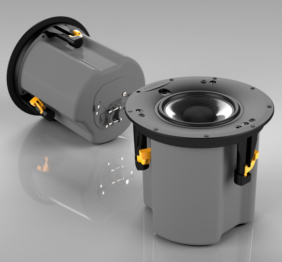

Theory Audio Design ic5 In-ceiling Speakers gray without grille
Theory Audio Design has unveiled the ic5, a compact 5-inch high-output in-ceiling loudspeaker that brings the performance pedigree of its larger ic6 sibling to a smaller footprint. Designed for residential, commercial, and even marine applications, the ic5 combines a discreet form factor with serious engineering—delivering up to 108dB of output from its 5-inch carbon fiber woofer and advanced polymer compression driver.
With a sealed design, and optional all-weather grille, the ic5 is built to handle everything from surround sound to distributed audio with precision and power.
For large-scale distributed installs, the ic5 includes a switch-selectable 70V/100V transformer that can be driven directly by Theory’s DLC Series Loudspeaker Controllers.

ic5 In-Ceiling Loudspeaker: Compact Performance, Big Flexibility
Versatile Applications: Residential, commercial, or even marine, the ic5 adapts. Its sealed design and optional all-weather grille let you put it almost anywhere without sacrificing performance.
Smaller but Mighty: The ic5 is the ic6’s little brother. You get the same dynamic, full-range sound—losing only a few dB of output—so you don’t have to carve a massive hole in your ceiling to get serious audio performance.
Easy Pre-Construction Planning: Theory’s in-ceiling pre-construction brackets make reserving space in new builds foolproof. Each bracket is labeled with the model number, so drywall crews can’t mix them up. No guesswork, no headaches.
Drop Ceiling? Handled: A 24” tile bridge kit lets you install the ic5 cleanly in drop ceilings. It’s secure, neat, and won’t rattle or wobble.
Wide Dispersion: With over 120° coverage at 10kHz, the ic5 fills the room. Even the dining room’s worst seats get clear, detailed sound.
Smooth Off-Axis Performance: Even at 90° off-axis—right at the ceiling—the ic5 maintains smooth response with gradual, controlled high-frequency roll-off. So yes, even if you’re painting the ceiling, you’re still getting good sound.

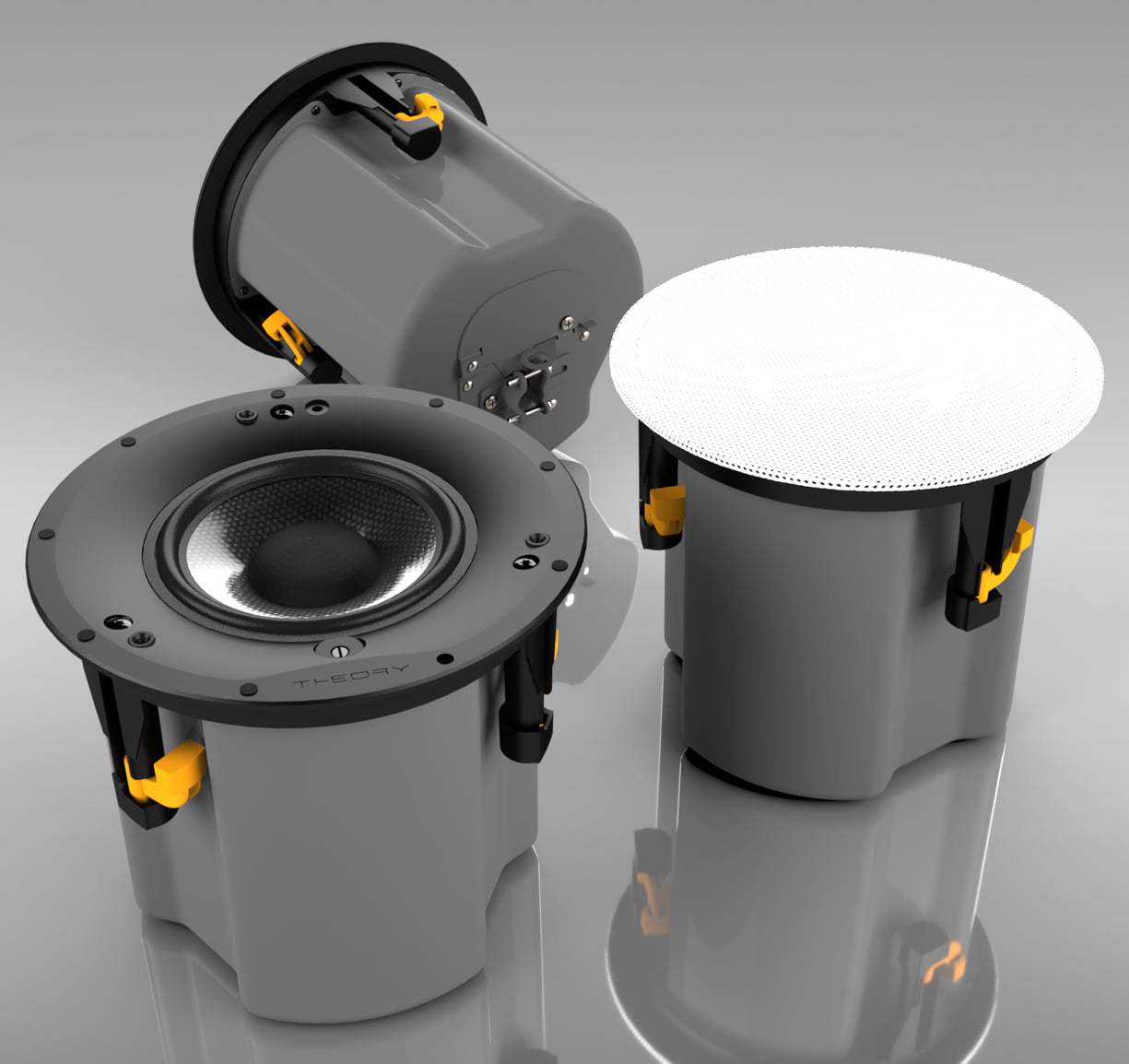

theory-audio-ic5-in-ceiling-speaker-side-back
Theory Audio Design ic5 In-Ceiling Loudspeaker – At a Glance
  • Speaker Type: 5” high-output in-ceiling loudspeaker, weather-resistant
  • Operation: Passive (needs one Theory Loudspeaker Controller channel)
  • Impedance / Voltage: 16-ohms or 70V/100V selectable
  • Drivers: 5” carbon fiber woofer + 1.4” AdvancedPoly™ compression driver (coaxial)
  • Enclosure: Molded ABS with powder-coated steel back can
  • Mounting: 3 retractable dog ears for secure installation
  • Terminals: Euroblock connector with parallel output
  • Frequency Response: 78Hz–23kHz (-3dB); 65Hz–23kHz (-6dB); 69Hz–25kHz (-10dB, subjective)
  • Coverage: 120° conical (-6dB @ 10kHz)
  • Sensitivity: 88dB (LF), 106dB (HF) SPL/2.83V/1m
  • Power Handling: 80W AES / 160W continuous / 320W peak
  • Maximum Output: 108dB SPL / 1m (AES) | 114dB SPL / 1m (peak)
  • Minimum Recommended Amp: 50W RMS
  • Transformer Taps: 30W, 15W, 7.5W (70V)
  • Outdoor Capability: Yes, with optional all-weather grille
  • Grilles / Finish: White paintable metal, square and round included
  • Speaker Dimensions: 8.3″ Ø x 8″ D (211mm x 200mm)
  • Cutout: 7.6″ Ø (193mm)
  • Total Depth: 8″ (198mm); max ceiling thickness 1.5″ (38mm)
  • Grille Dimensions: 8.4” Ø / 8.4” SQ, 0.16” D (213mm x 4mm)
  • Weight: 8.8 lbs (4.0 kg)
  • Included Accessories: Round & square grilles, cutout template
  • Optional Accessories: Pre-construction bracket, ceiling tile bridge, all-weather grille
